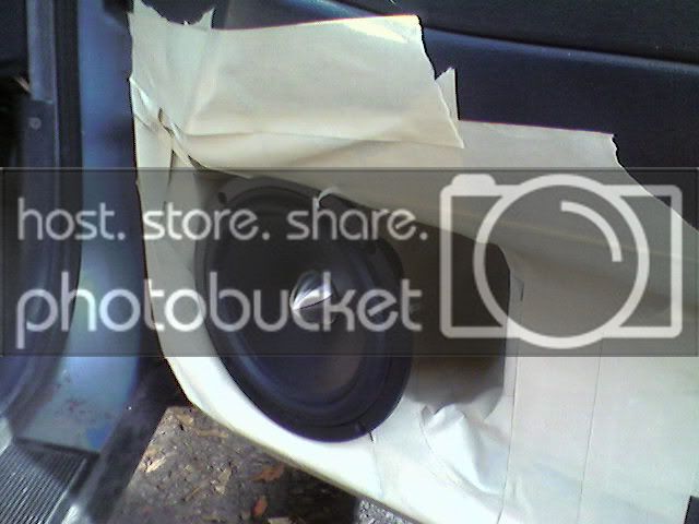

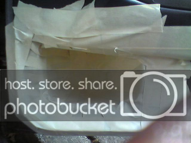

here is the designated spot taped off

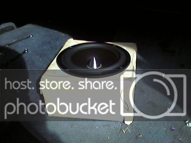

here is the speaker sittin in its soon to be permanent home + some minor tilting for imaging

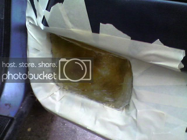

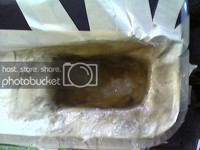

here is the first layer of glass
doing one door at a time so i can learn from the first door. first lesson learned...when fiberglassing to the inside ceiling of an enclosure USE CLEAN CUT PIECES =D
yes the window was rolled down during the glassing. it does extend to the other side of the door. it is pretty deep cuz i didnt have much room width wise. i think the speaker is gonna sound great in it.

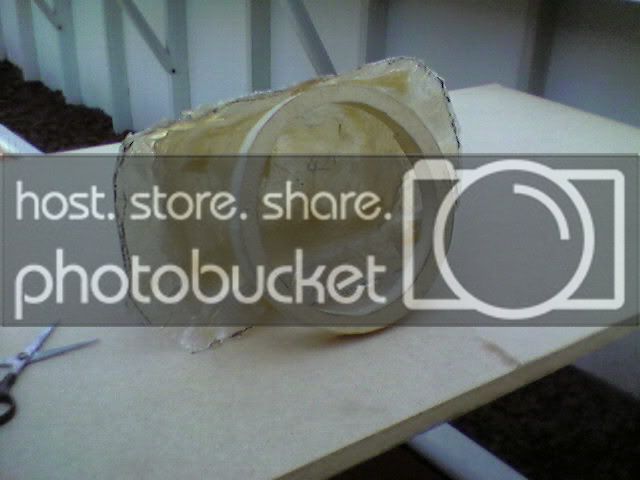

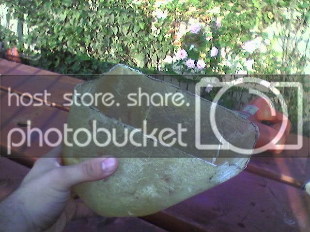

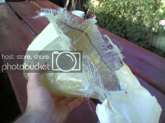

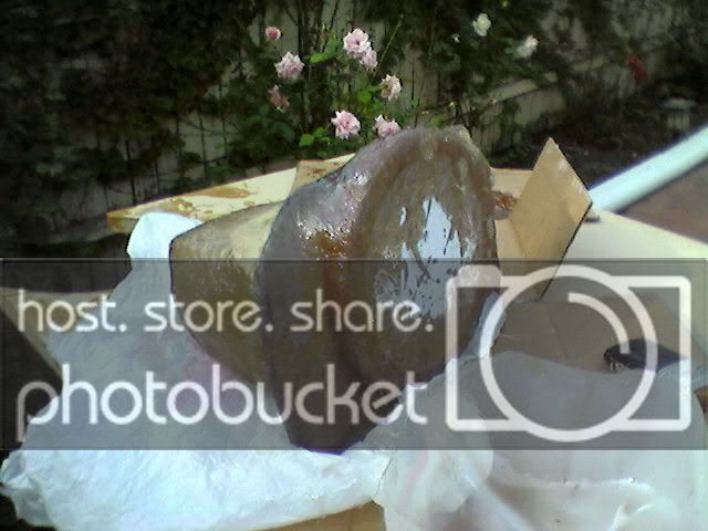

here she is all dried and somewhat stripped of tape. ive already marked my outline where i want to cut. since i made it rather thin(because of it being completely enclosed in my door) i was able to cut 90% of it with scissors. the tougher spots i used a saber saw.
unfortunately i didnt plan it perfect. after holding up the baffle and the pod to the door i realized i didnt leave myself any room to mount it! the pod is about an inch shy of the diameter of the baffle =/

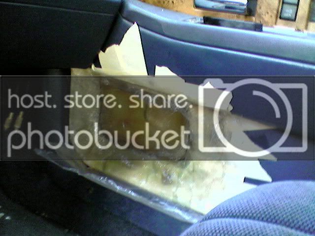

so i threw it back into the door
...and glassed a "lip" around the opening. it serves as a reference point for when im going to mount it internally and also as a place to mount thw baffle. that part i didnt think through b4.
it shrunk slightly leaving about a 1/4 inch gap at the top of the pod. this made it extremely hard to glass infact i couldnt make the glass stick to the top no matter how hard i tried. so im just going to have a little extra patch work when i glass the baffle.

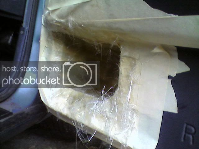

here is the driver side. as presumed, i did a MUCH better job this time around. it is fairly clean, not much excess glass, and i covered a larger area. this time i had the help of a paint brush.
now is the wait.

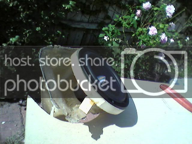

so here is my baffle mounted
speaker in place. had to manipulate it to get clearance for the magnet
so far im coming to realize this isnt going to workout with a flush mount as i planned. the only way to achieve that is to cut a larger opening in my door OR make about an 1.5-2 inch baffle. maybe next time i fiberglass i will take more time to measure and plan.
