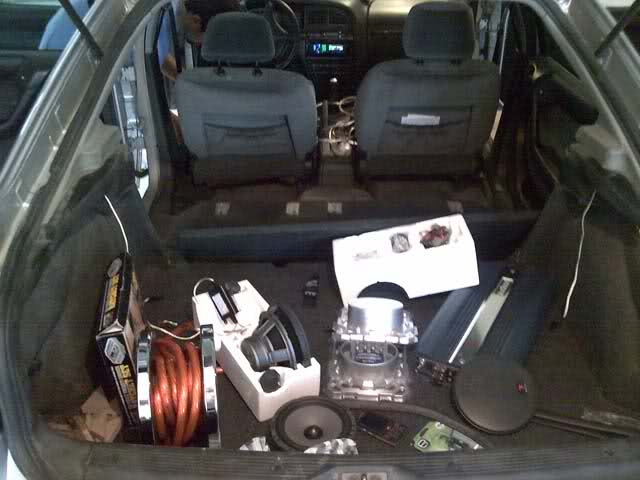

project components:
HeadUnit: Alpine 9887
Ampilifier: Audison VRx4.300
Sound stage: Focal 165v1 component
Subwoofer: Kicker CVR silver 15"
Battery: 80AH Banner
BOX: Vented 150litr tune @ 33Hz
wire: Memphis 0 guage (70mm)

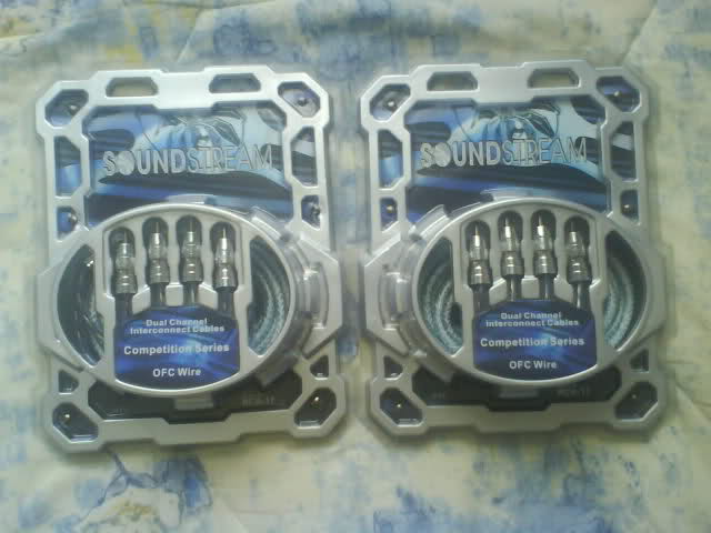

RCA: sound stream competition series

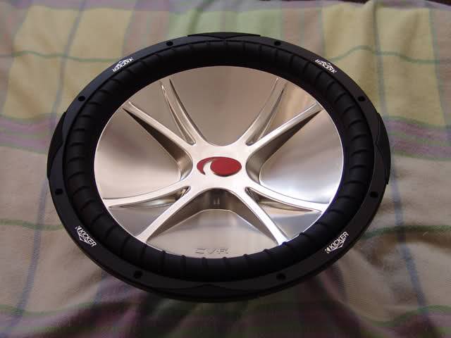

my kicker subwoofer: //content.invisioncic.com/y282845/emoticons/eek.gif.771b7a90cf45cabdc554ff1121c21c4a.gif

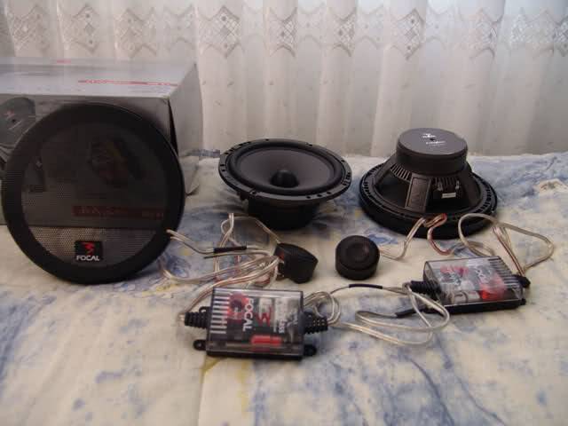

Focal Polyglass 165v1 component:

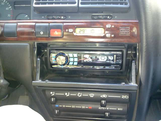

Alpine 9887 instaled on car:

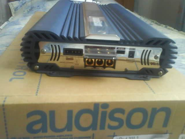

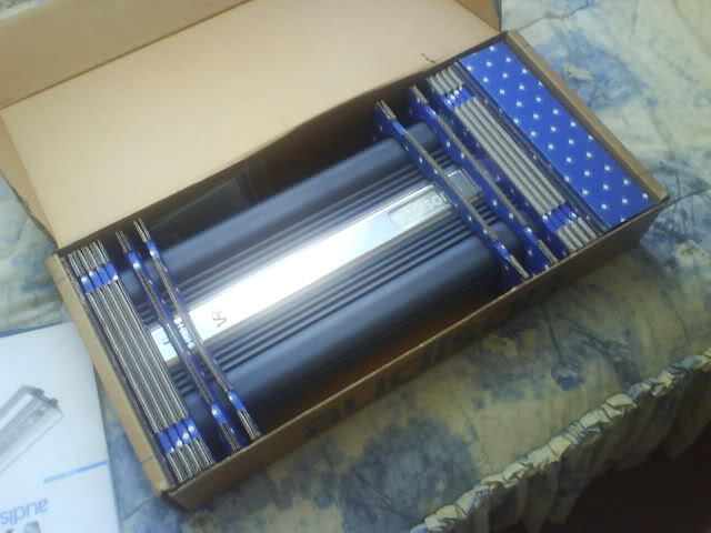

audison VRx4.300 amplifier: //content.invisioncic.com/y282845/emoticons/wink.gif.608e3ea05f1a9f98611af0861652f8fb.gif

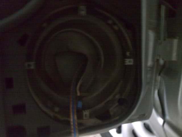

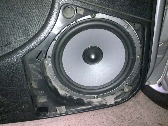

Focal midrange in door:

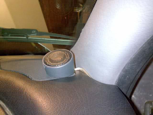

tweeters:

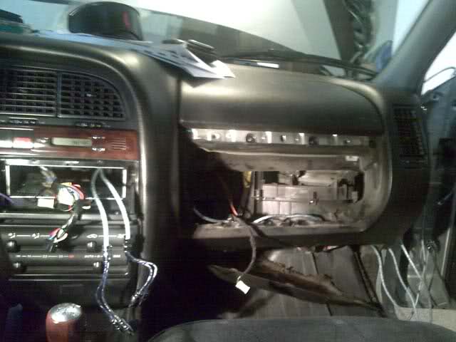

for negative conection:

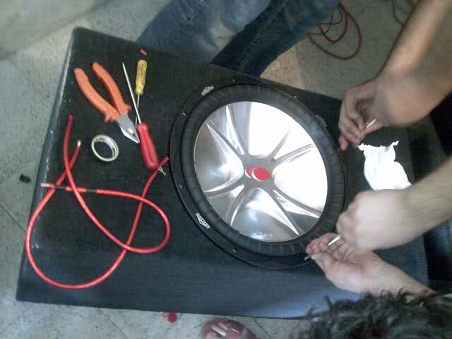

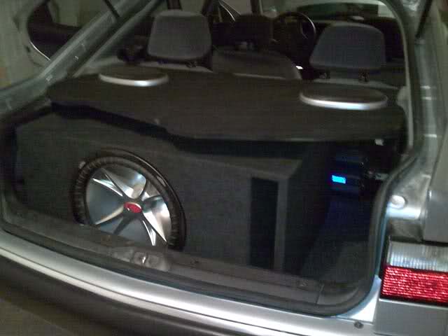

Sub & Box:

2 channel connect on focal components 2x110watt@ 4 ohm
2 channel Bridge on Kicker sub : 1x520watt @ 2 ohm
whats your idea about my project ?

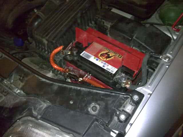

Looks alright, but you need to do something with them tweeters. Put them in the door, glass them in the A pillar or something. I also reccoment getting a grommet for the power wire that's going through the frame, it can move and cut into the insulation on the wire and you could have a fire on your hands.

but the sound of Tweeters was a little harsher than other good Focal components like a K2power or KPS
