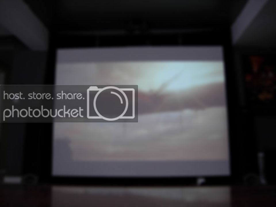

Made projector screen (2x3 frame and blackout cloth)

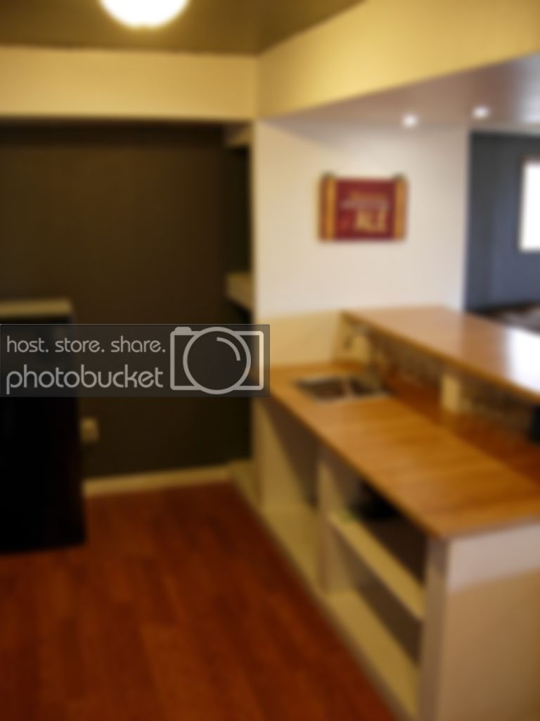

And that’s about it. The countertop is excellent, holds up to moisture just fine, and is sturdy as hell. The equipment and wires and placement seems to be perfect so far. Really no complaints at all. I wish I had more money to dump into it, but I think this is it for a while. I want to put a pool table over on the stone, rather than workout equip, but this works for now. Id love better seating too, but my wallet cant handle that either… so here it is tell me what you think

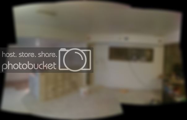

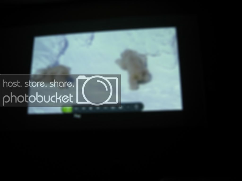

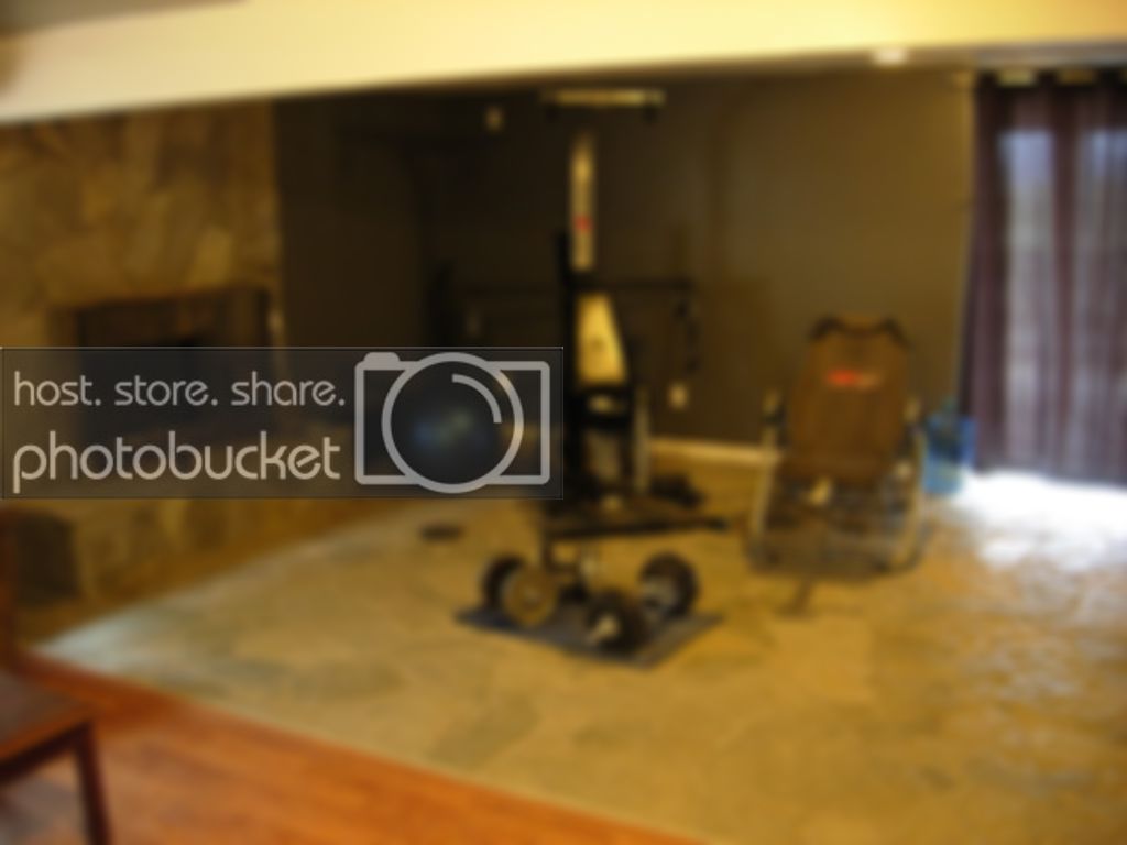

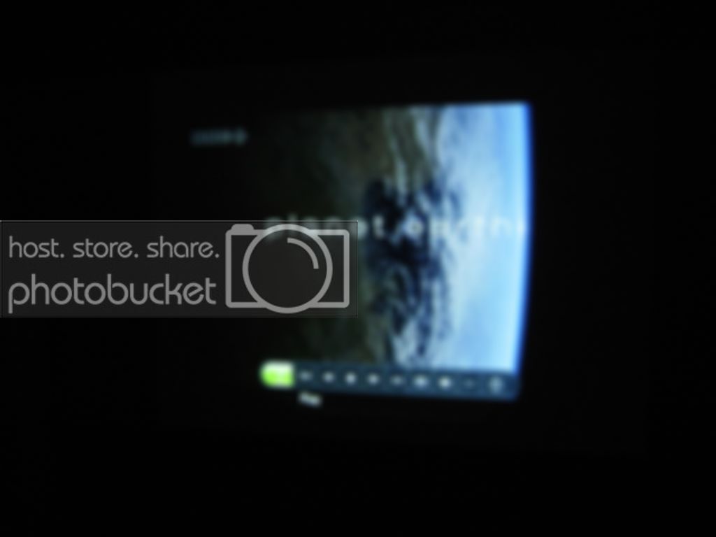

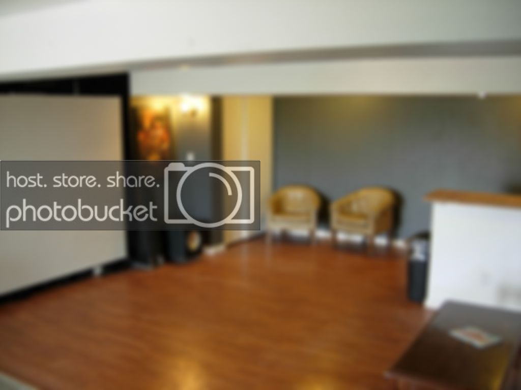

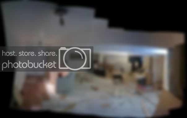

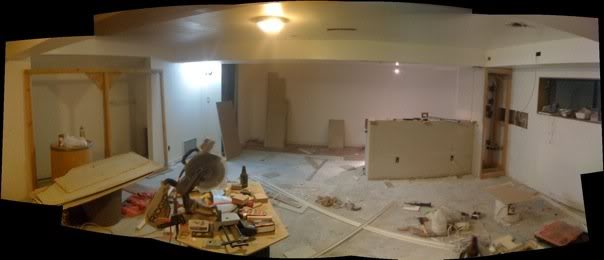

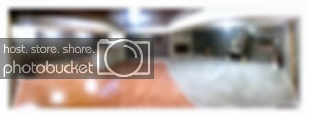

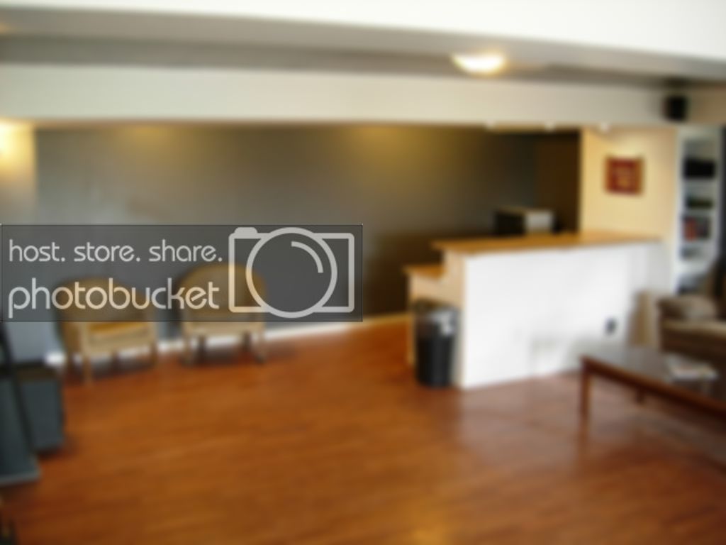

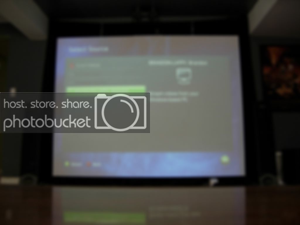

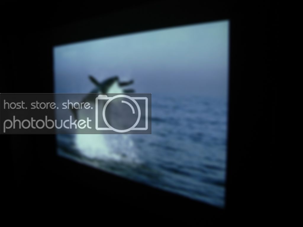

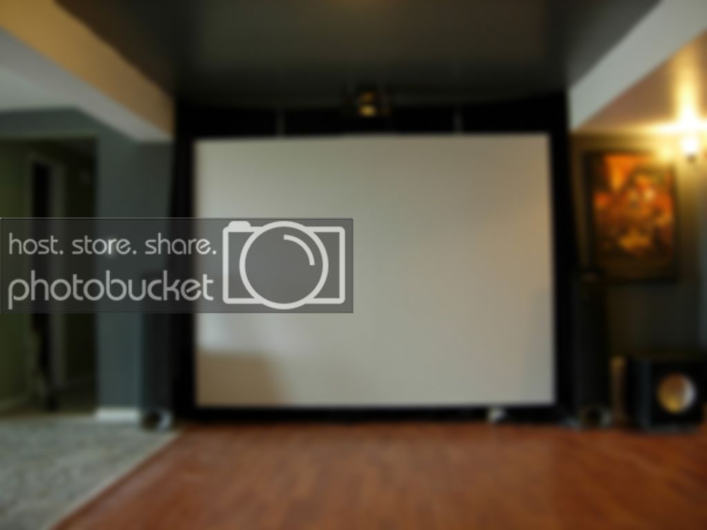

And now for the pics… there is a couple of in progress one, but I cant find and before pics unfortunately. I meant to keep a better work journal of this, but… well, I just didn’t. the soffits that drop down from the ceiling were existing, where it comes down to make shelves and the bar is all new.
