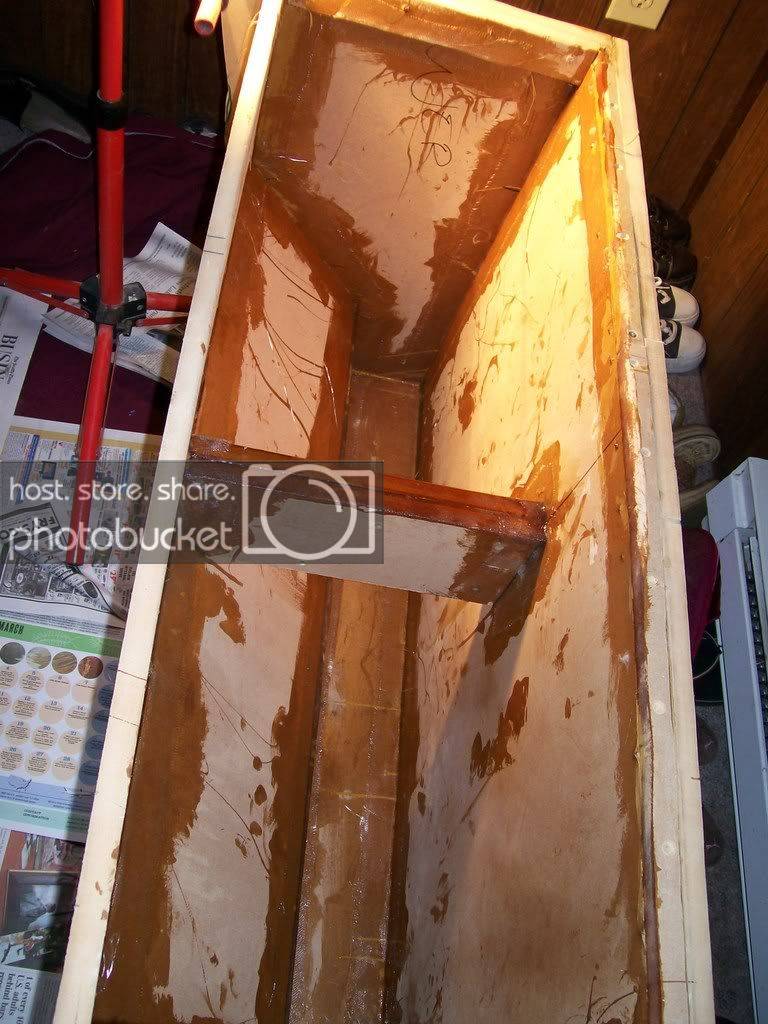

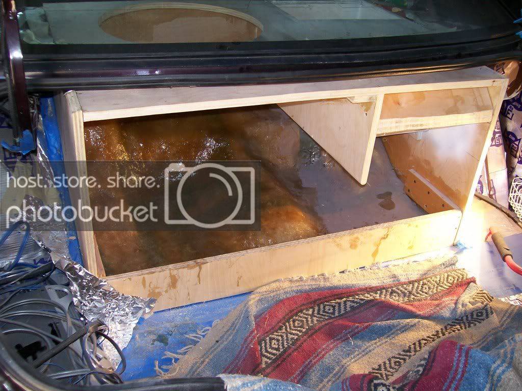

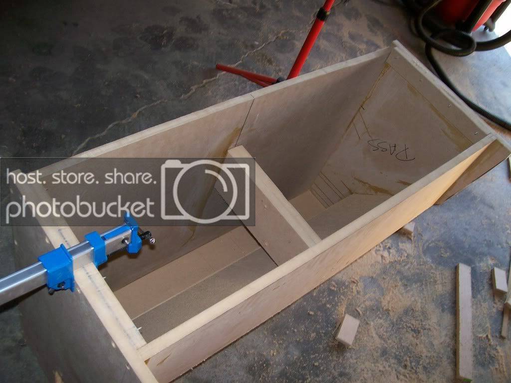

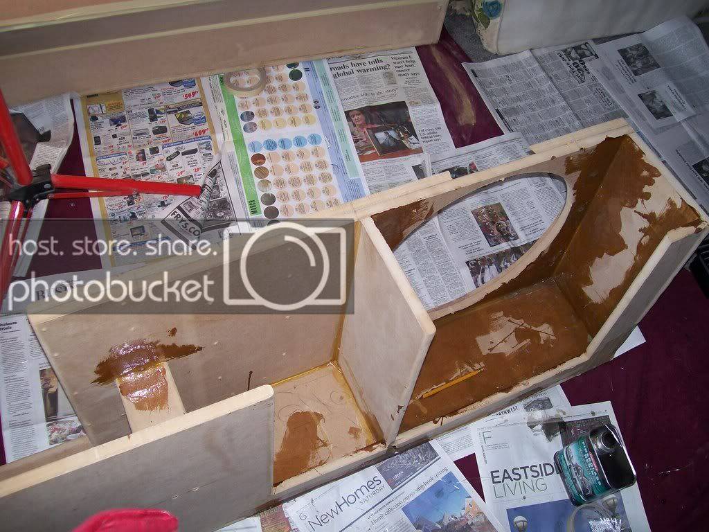

First BTL box build pics
Will have some more pics in an hour
Here is A vid of the first setup
KAPONESS
KAPONESS

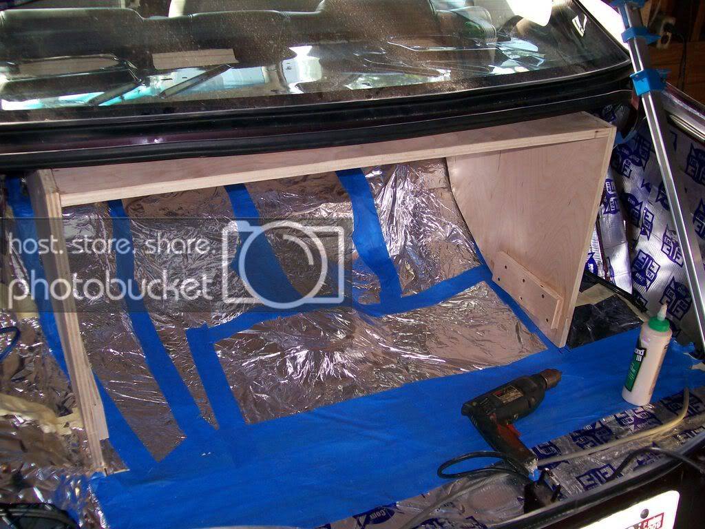

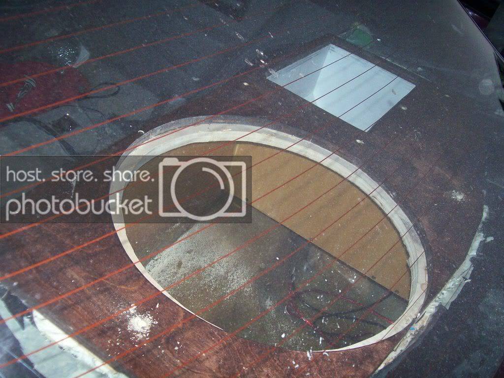

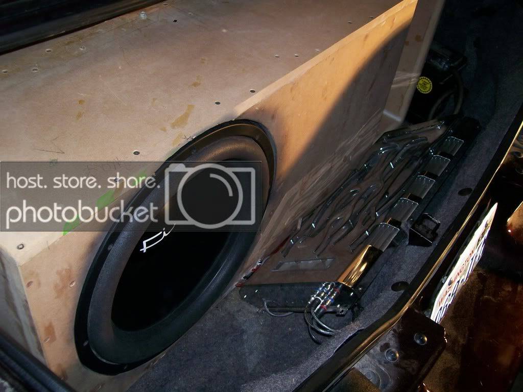

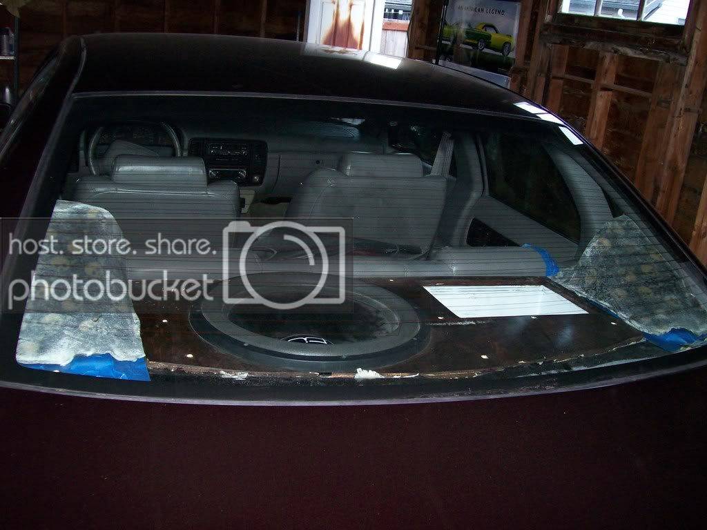

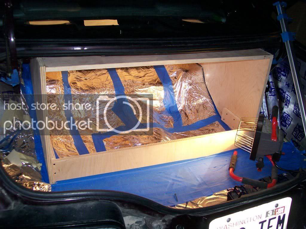

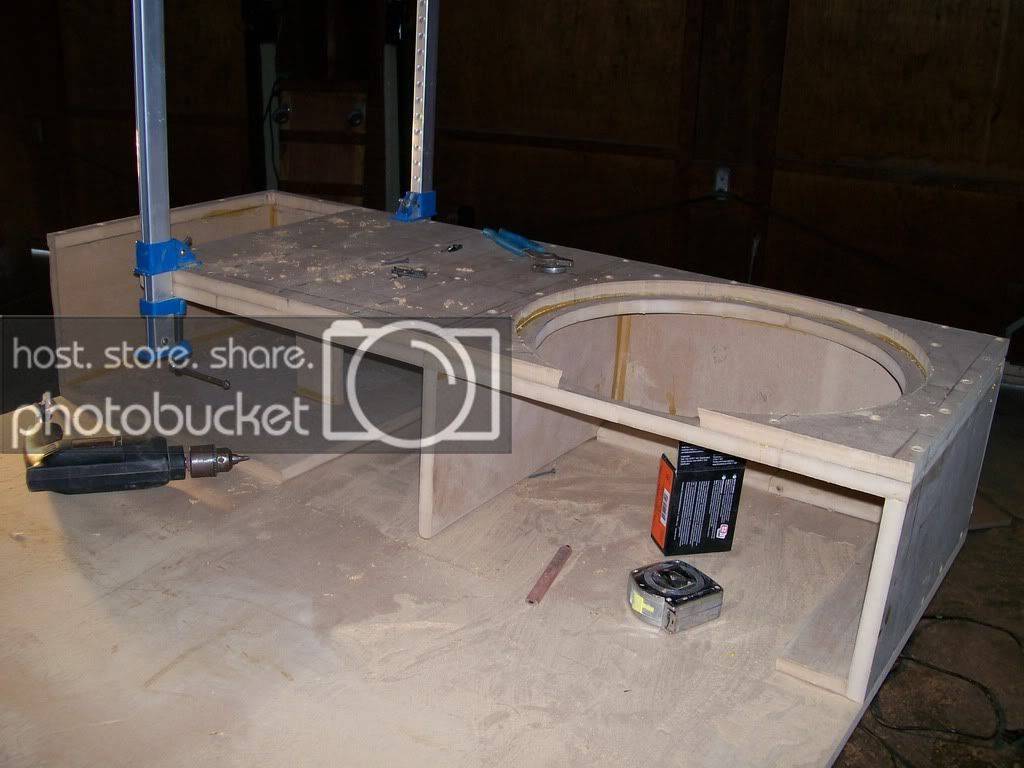

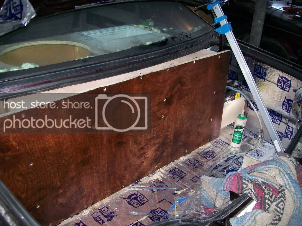

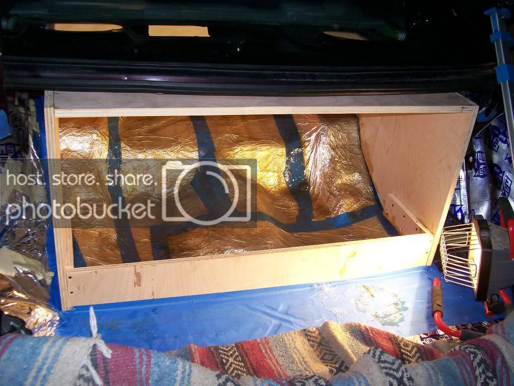

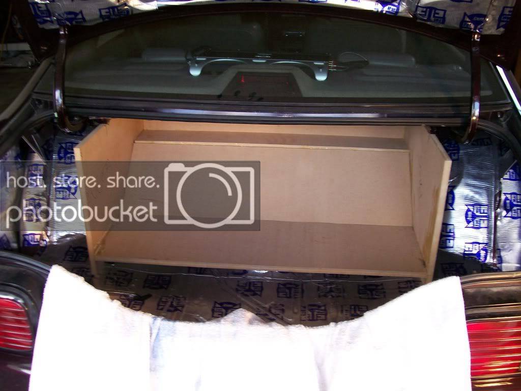

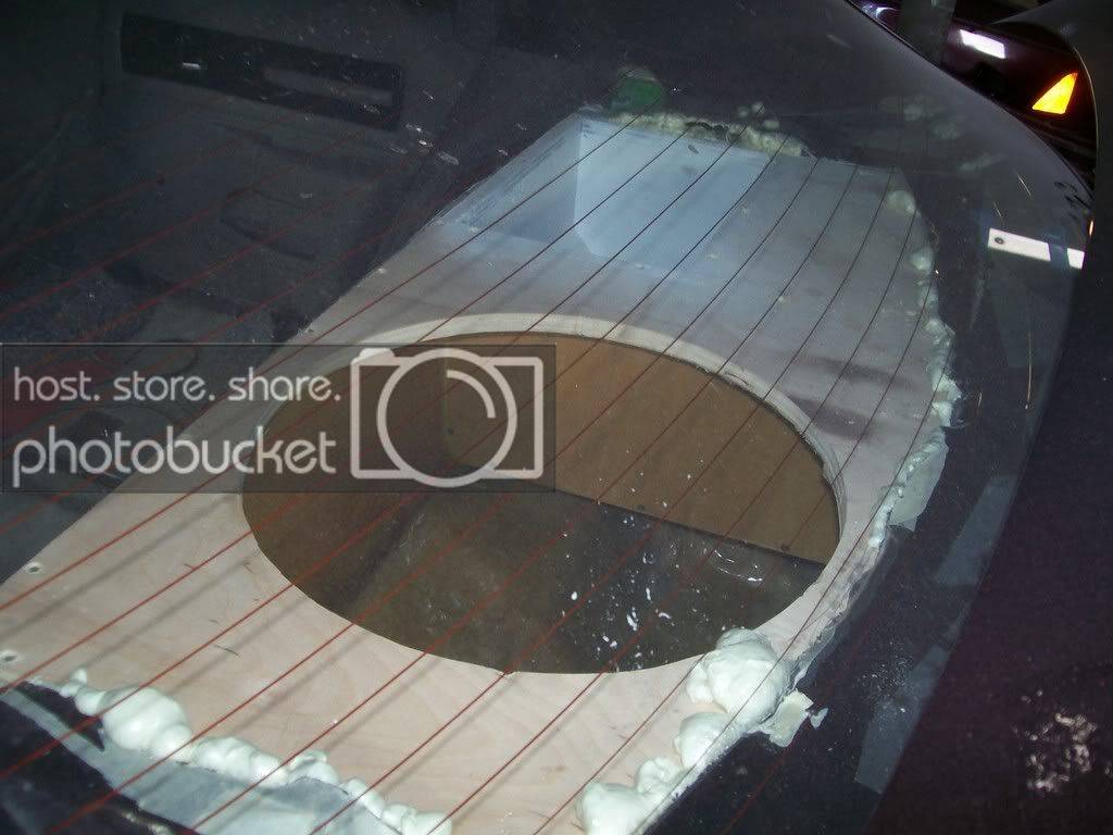

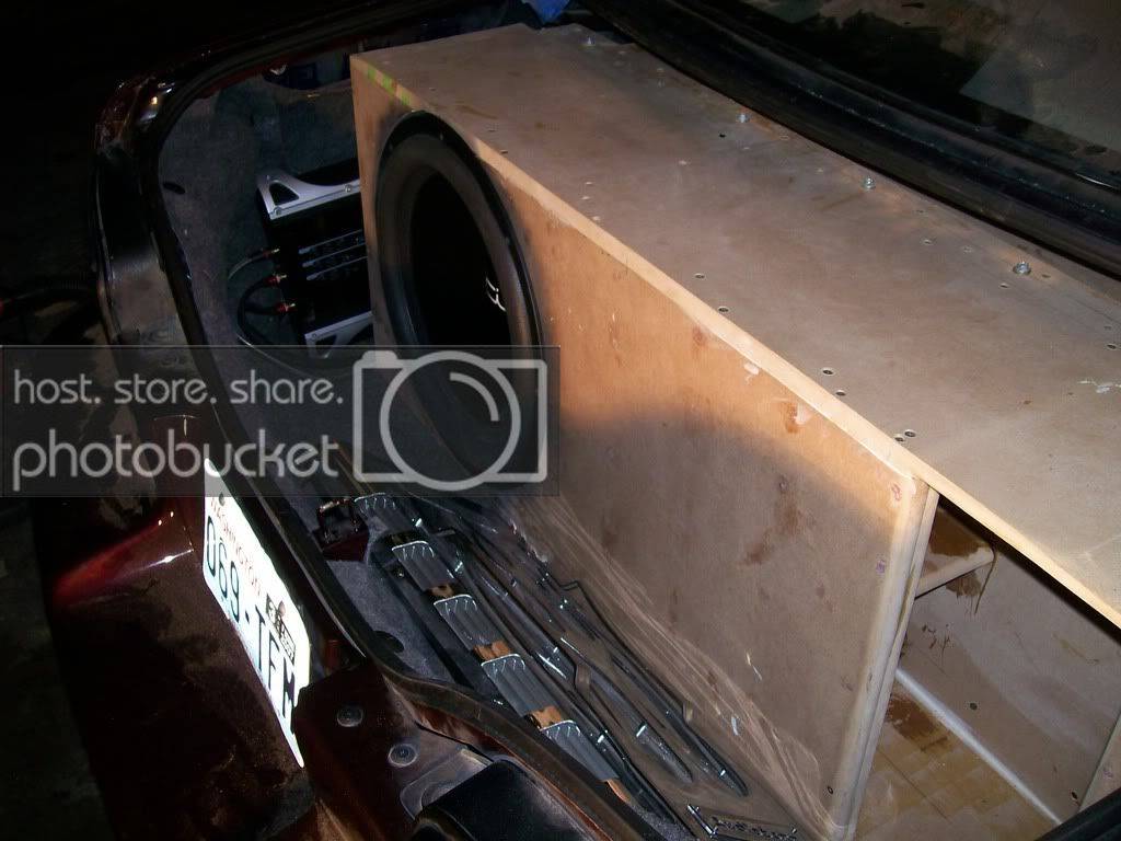

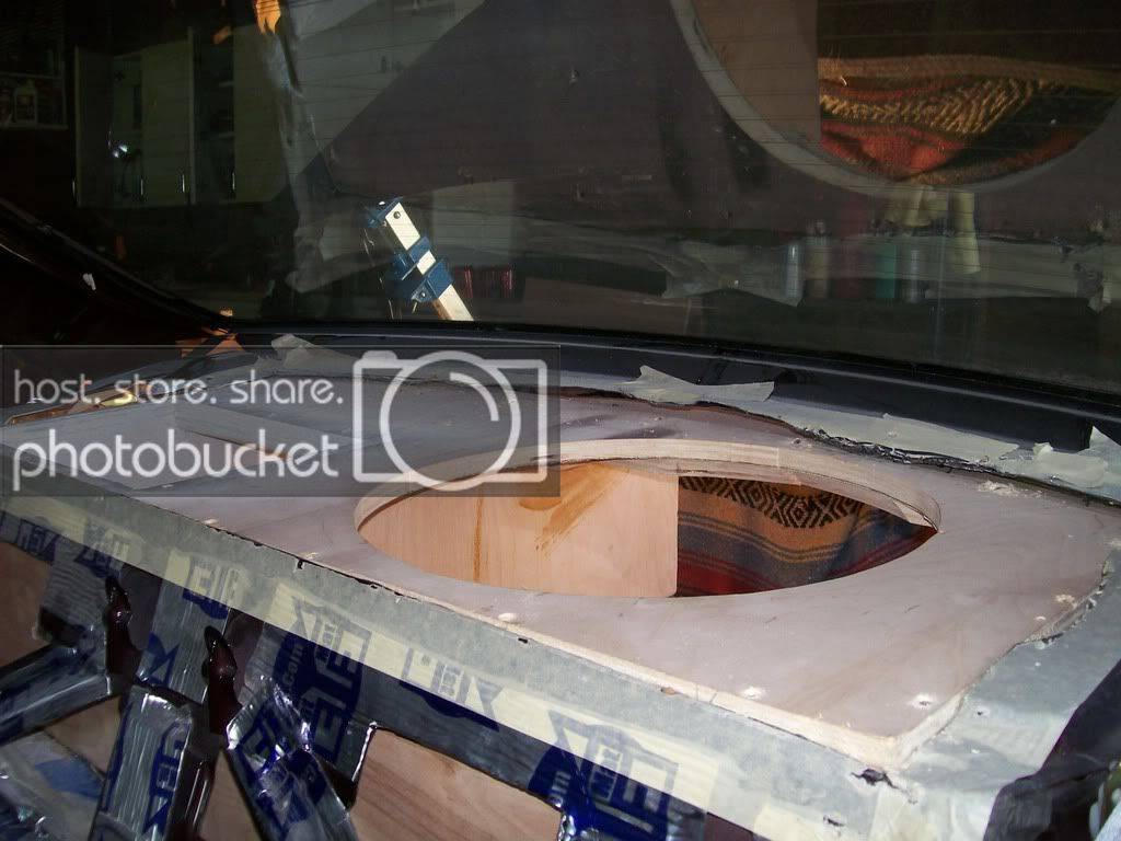

OK the first set-up hit hard as F%&$ so good it ripped my quarter panel from flex so decided to change it and here is the second box build 7.5 cuft tuned to 33hz With sub and port in the rear deck the first box was mdf was so **** heavy so decided to use 9 ply 3/4 birch and fiberglass on the bottom to maximise my space so I have more trunk room.

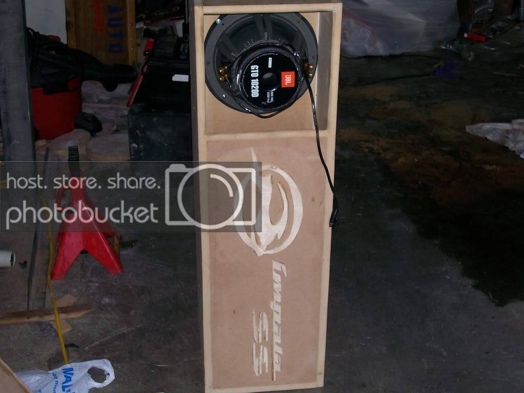

A T-line I built for 10" jbl gto

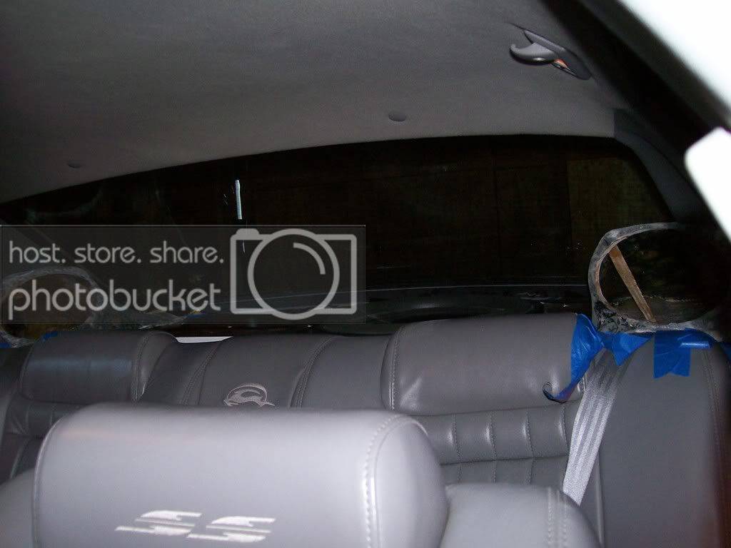

are you getting those windows tinted?If you aren't that is screaming steal me with it in the back window.
id like to see someone steal that sub out of his rear deck... //content.invisioncic.com/y282845/emoticons/laugh.gif.48439b2acf2cfca21620f01e7f77d1e4.gif
