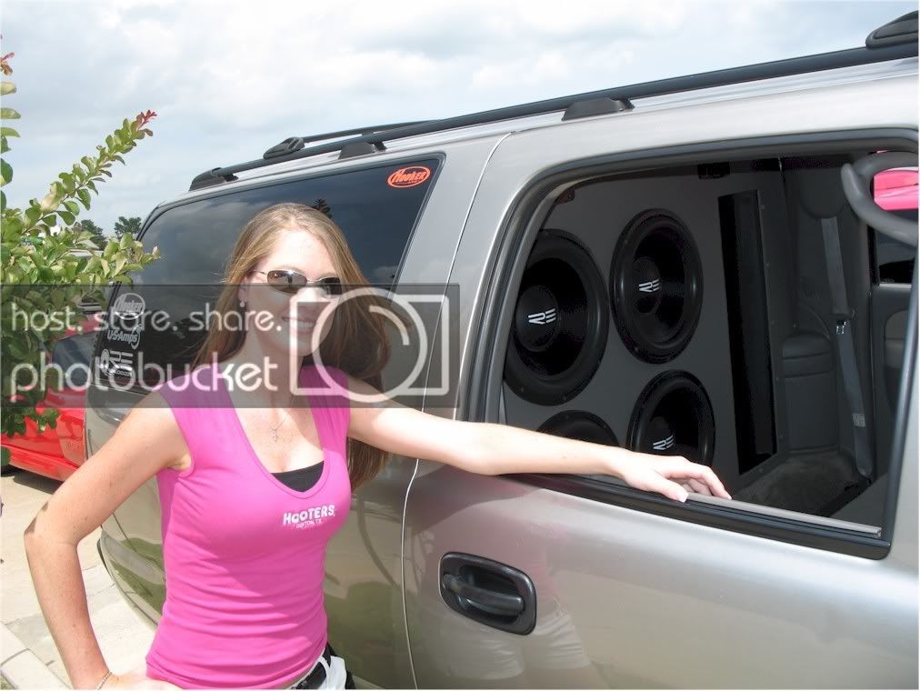

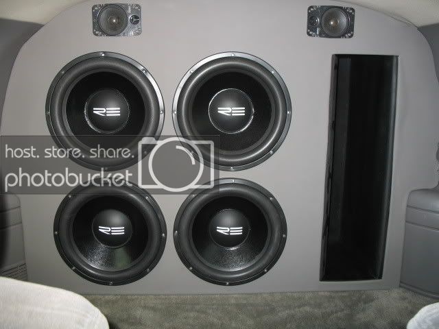

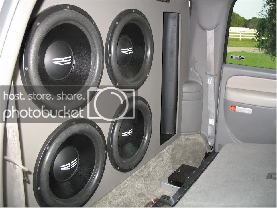

Dual 1.4 ohm coils. Running each sub on a strapped pair of '06 US Amps MD3D's with the coils in parallel.
Still have a few more modifications to try, but right now it will do 157.1 dB @ 36, 37, 38, 39, and 40 Hz on the TL. Man music is LOUD on this setup.

:eek:WOW:eek: That's a hellova nice setup!
I like your HT setup too. Have any pics of that? I'd like to see it //content.invisioncic.com/y282845/emoticons/biggrin.gif.d71a5d36fcbab170f2364c9f2e3946cb.gif

isnt that kinda small of a box for 4 15" MT's ? //content.invisioncic.com/y282845/emoticons/confused.gif.e820e0216602db4765798ac39d28caa9.gif also, I see alot of places inside the box that arent that smooth or refined...is this just for daily beating or competition ? //content.invisioncic.com/y282845/emoticons/confused.gif.e820e0216602db4765798ac39d28caa9.gif

Man it is does not sound small. These things are killer on music. David told me 3.25 to 3.5 works good for the MT 15, so I went with it.
It is slowly becoming more of a competition vehicle. That is part of the box mods I need to make this weekend to hopefully get a little more out of it next weekend at Texas Heat Wave. If you have any suggestions, hit me with a PM!!!
