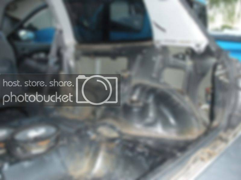

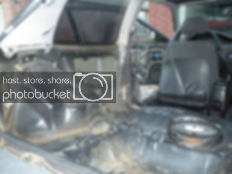

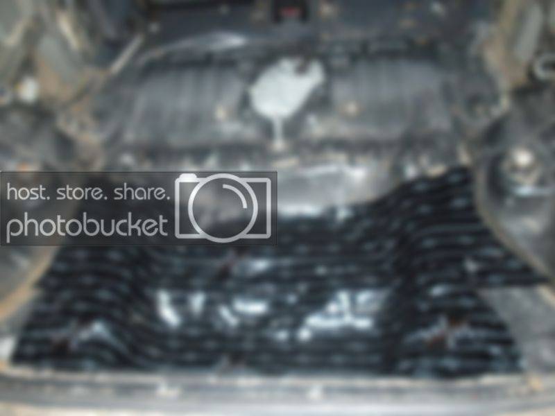

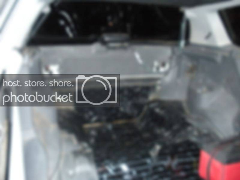

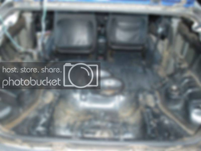

Here are a few crappy pics of the install. I can update the thread as time goes on to make sure it is sticking well through the winter!
Notice NO factory deadener
Wheel well covered. After this, I extended more mat to the rear corners.
