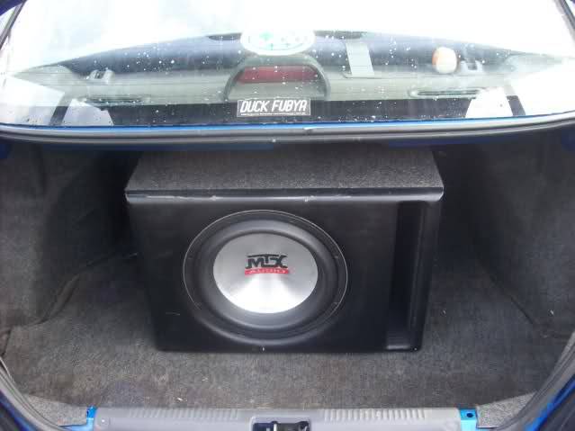

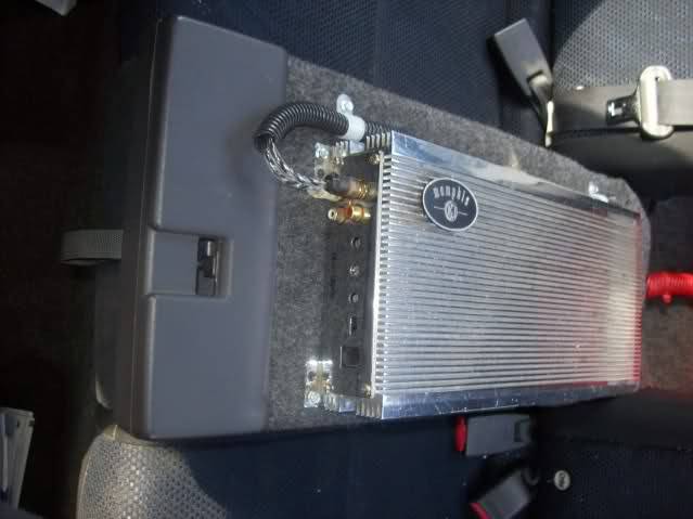

I am wondering what you guys think about these prefab boxes??? do you think i can get more outta this if i were to turn the box around or should i just build another box??? this is the box mounted in my wrx.... also my amp is mounted on the fold down armrest, there is a access hole so i was wondering if it would be more beneficial to turn the box around. Thanks guys....
ahh fellow sledgehammer owner. although i do love the magnet support lol im gonna get a new box made if it doesnt sell. trust me when i say you can get more output/better response from a custom designed box. i called mtx and even tehy say the sledgy is too small for the sub. they told me 4-5 cubes if i remember correctly for my 15 and the prefab is only like 2
i have the sledgehammer box. it's good build quality, but it's tuned WAY too high.
turn it around and try it. if you don't like it then build a new box.
sooo true, it doesnt like the lows, and i can never turn itup with songs that have a long low bass line cuz it sounds funky like its about to botto mout. if mine doesnt sell i was thinkn about going with a clamshell or snailshell watever you call it tuned to like 30-34.

yeah thanks! so how much bigger do you think i should go??? I know that my lil john cd used to bump harder when i had 1 15" in a sealed box, but my slash metal sounds incredible...
what sub is it? it's not the 9500 because that box is silver (the one i have). unless thats painted
Wrong, my box looked different as well, but looked the greatest //content.invisioncic.com/y282845/emoticons/wink.gif.608e3ea05f1a9f98611af0861652f8fb.gif
