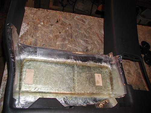

You should use my method if you want a piece of fiberglass that will conform to the shape of the area your trying to attach to. It gives you a base to work off of. Something that you can trim to the exact shape you want and is strong to boot. Attach anything you want to the base and finish it anyway you want. There are an unlimited amount of options for finishing. Thats all up to your skill level and your imagination.

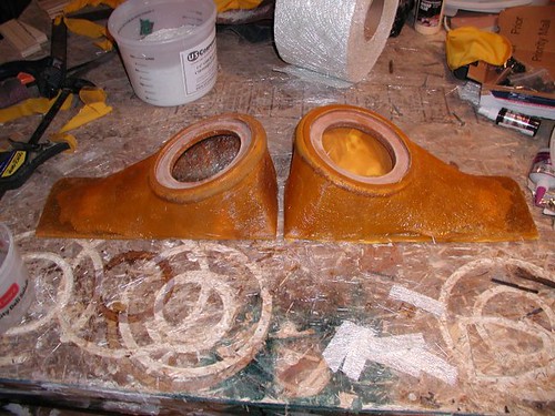

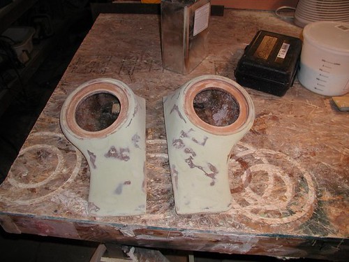

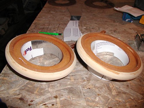

Heres and example of what im talking about. Pods I did for my rear Silverado doors.
Base
Rings
Glassed
Prepping with Rage Gold
Finished
