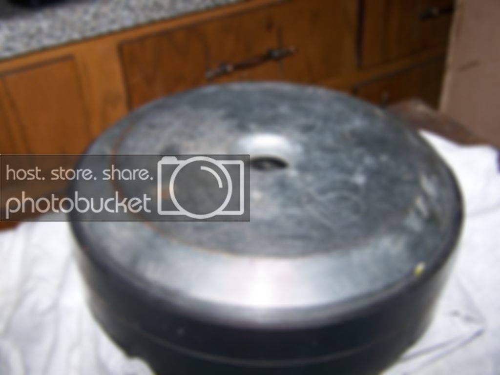

I turned one of my DD motors from this:

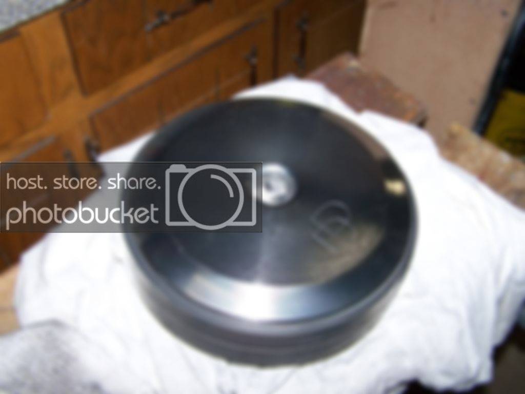

Into this:
Any idea what you used Tommy?
Both of them are 3M polishing compounds usually used for automotive paint and such.
One is a heavier grit to get rid of swirls/scratches, the other one is a lighter compound to clean up what the heavier stuff left behind. Then usually after that you would use a wax/sealer to bring back the shine if this was a painted surface.
Oh, and I used a electric buffer. You can do it by hand but be ready for your arms to be sore. //content.invisioncic.com/y282845/emoticons/smile.gif.1ebc41e1811405b213edfc4622c41e27.gif
