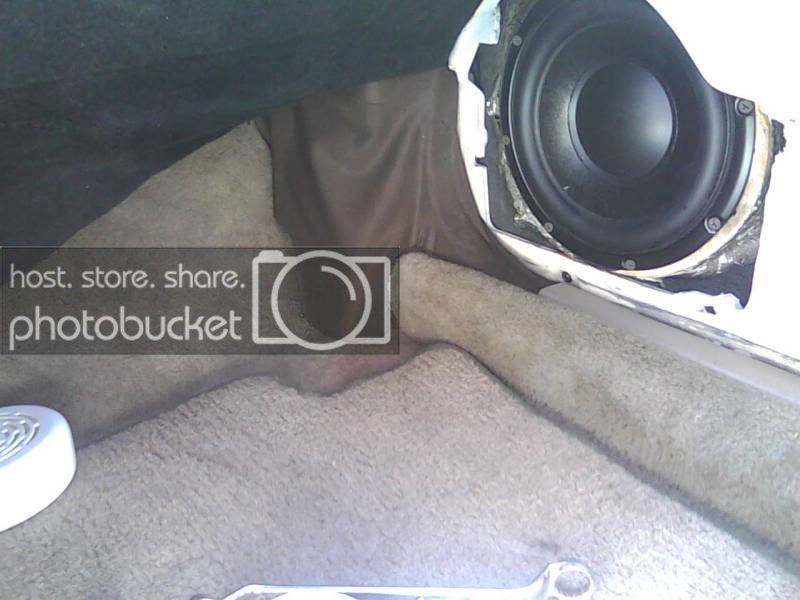

Of course, a larger speaker better be able to play lower, with less effort and more output. But you got to look at cost vs. reward. not knowing what vehicle makes this a little difficult. Is it worth the ouput gained in the midbass regions to do the work to make 6.5's fit. Some vehicles it's a no brainer and do it too it. I can think of a few ( most audi) that it would require an arse ton of work for minimal gains. I'm a do it right, and only once kind of person. My doors had 5 1/4's and thought I needed more midbass

I like the dude at diyma who had the pair of sls 6.5's on each side. Tons of effortless bass-midbass right there...it'd be taxing on the rattles though.
Drake I think has the dual 6.5's
I don't remember who it was exactly, I just remember solid steel enclosures in the doors.
