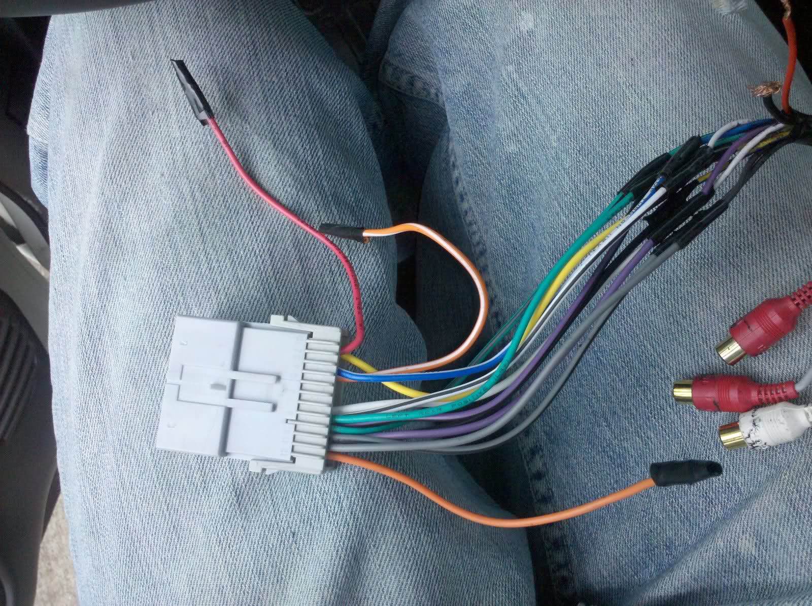

I have figured out everything up to this point. I'll admit, im a noob to this but i refuse to pay someone over $100 for something I can learn. I went to the car stereo place and they sold me everything i need to hook up my Dual dvd player. The only thing I am having a problem with is this seperate red wire they gave me that is called a "Metra 12v ignition/switched wire". There is also a little gold metal piece that comes with it and I'm not sure what it is used for. One end of the wire is male already stripped and the other is female with 2 places for a wire insert.
I read somewhere I should hook one end to the fuse box (12v) after finding it with a mulitmeter. The only problem is I do not know exactly how to find it and which end of the wire hooks to what. There are 2 places on the opposite end of the wire for a wire insert (female) and I do not know which wires to put in there. If anyone can help me with this I would REALLY appreciate it.

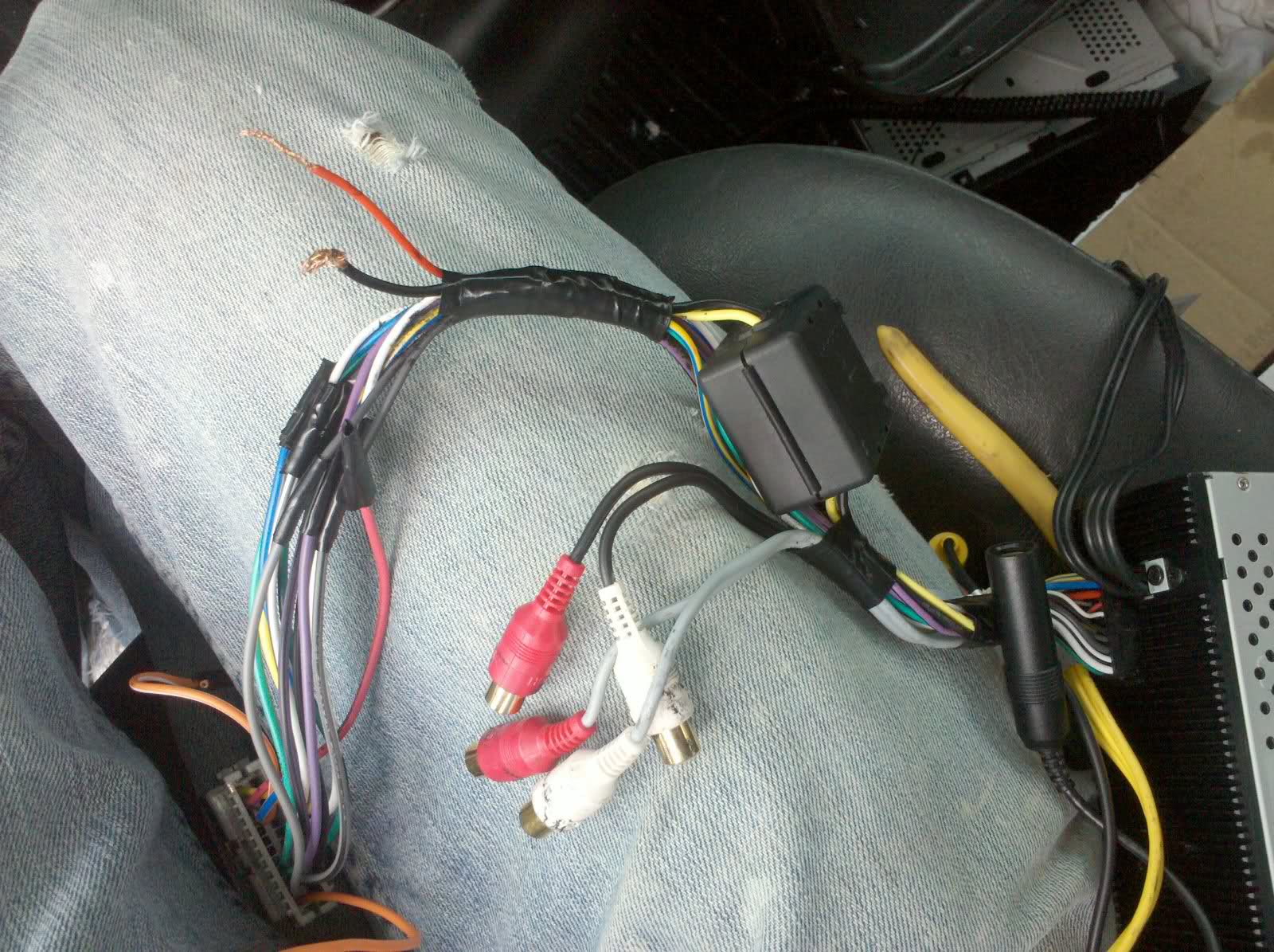

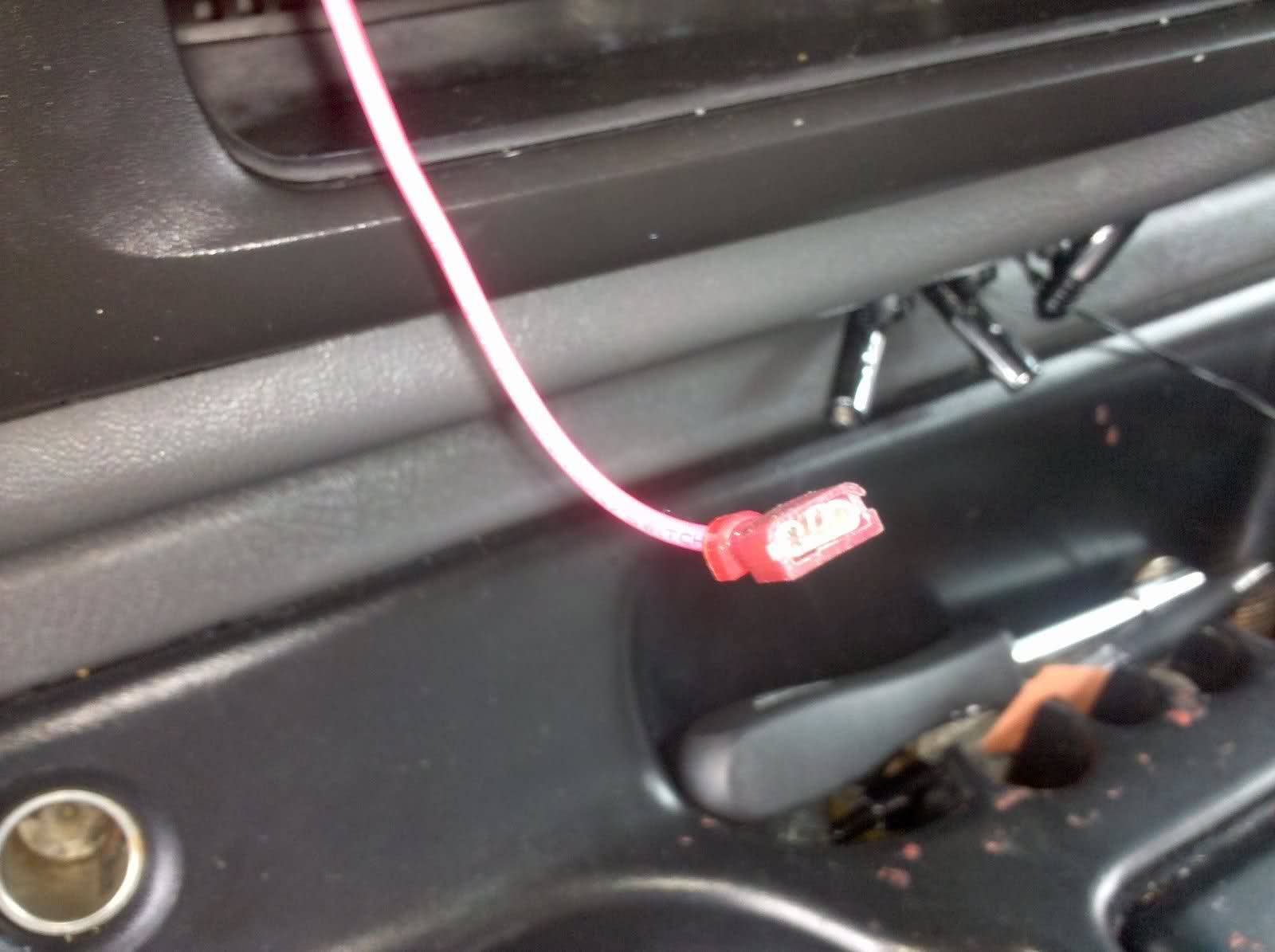

It still isn't working, but I have progressed lol. I attached one end of the 12v ignition wire to the 12v fuse (not the live connector) and it still isnt working. I have a loose black cable, guessing ground, that has no other wire to connect to so I attached it to a metal screw and put some electrical tape around it. Still not working. If anyone else has any suggestions please let me know!
Actually Ill post some pictures of what I'm talking about so you guys get a better idea.

Sweet I got it working! All I had to do was ground that black cable to some metal...but i still am having some minor problems..
1) How do i get the black cable to stay grounded? When I would tape it down I had to literally push down on the top of it for there to make a connection with the metal. If I would take my finger off the dvd player would turn off.
2) My key wouldn't come out of the ignition until i unplugged the red wire. What could fix this?

Ground: Self tapping screw to bear metal, wire wrapped around it.
Ignition: Why cant you hook the igniton wire up to the Ignition wire on the back of your harness. There is one that goes right to the radio.

I know exactly how to what you should do. Pull all of your HU install out and do it over!!!
Get rid of the dam black tape and BS. Solder and heat shrink or at least use crimp caps.
Also, I'm guessing you have a GM vehicle and you didn't want to pay for the GMRC-style harness. That is why you ended up w/ the cheap harness w/ separate ACC wire.
You have most likely tapped the WRONG wire for the ACC.

To show I'm not a total dick........The red wire you are asking about will do you no good. It is an ignition wire in a few cars but gm changed to data turn on in its factory radios. You will need to run your own switched power wire. You can find this at the fusebox or the ignition harness at the steering column. Fuse this wire!!!! Hook this to the red wire on your headunit harness. The black wire in the factory radio harness goes to the black wire on your radio harness that isn't connected in your pic. Or you can run a ground from your radio harness to the kick panel, scrap some paint away and use a ring terminal, star washer and self tapping screw to make your own ground.
