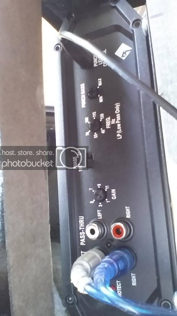

Thanks, I thought that might be possible.. I turned down my Gain, but I'm not sure which direction the Freq. needs to go. Here is a picture of where its set at now. Sorry if the picture is HUGE, but I didn't want to shrink it. Incase it couldn't be read..
20140619_163303.jpg~original
Gain needs to be set with a multi meter low pass at 80 hertz. Phase on 0 no bass boost

I went ahead and put the low pass at 80Hz and the Phase on 0. Doesn't hit near as hard as it did...I have only had two systems one in a hardtop Wrangler. One 12in in a Custom box and the other was in a small hatchback. two 12's in a bandpass...Maybe I'm expecting to much from one 10in Sub in a Trunk.
