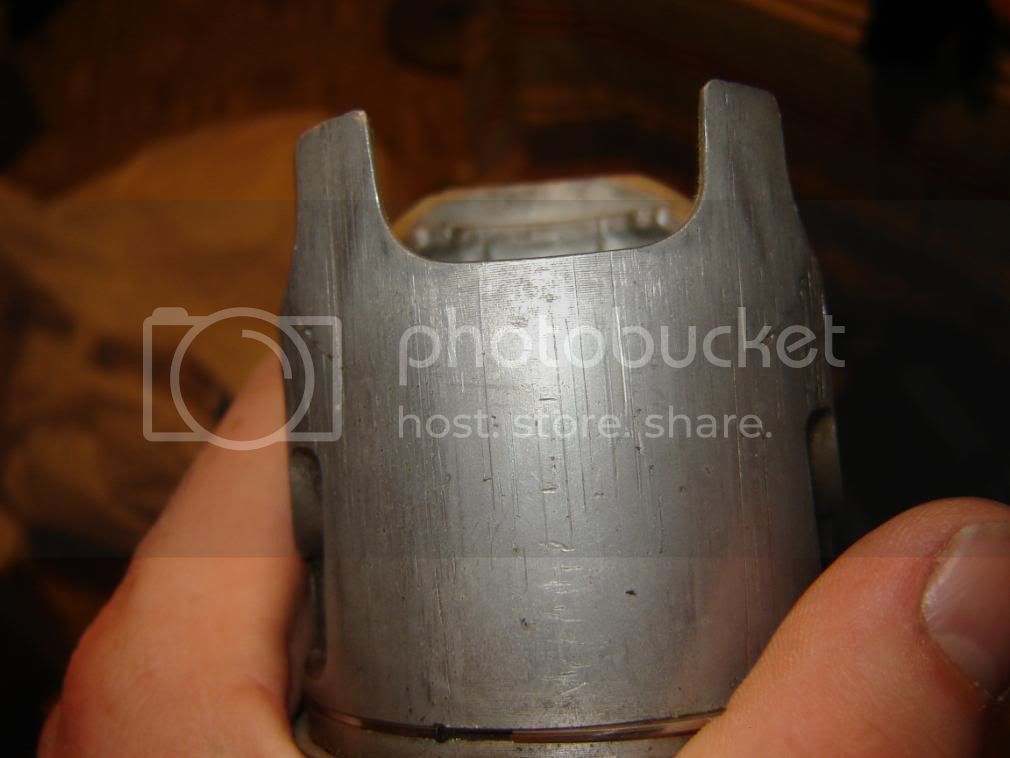

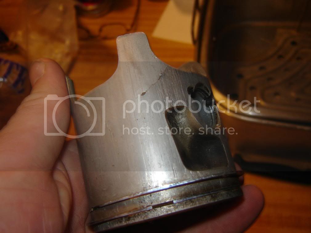

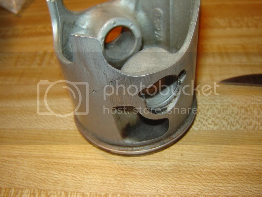

So my friend bought a Honda CR250 dirtbike. He tells me the wal-mart 2 stroke pre-mix for weed eaters will work in his bike. I said naw man you need to go to the bike shop and get some Motul 800 or Amsoil, something high quality if you want the bike to last. He didnt listen. We went to the track a couple weeks ago and going down the straight his motor locks up. We just tore the bike down last night and look what we found. . . . . . .

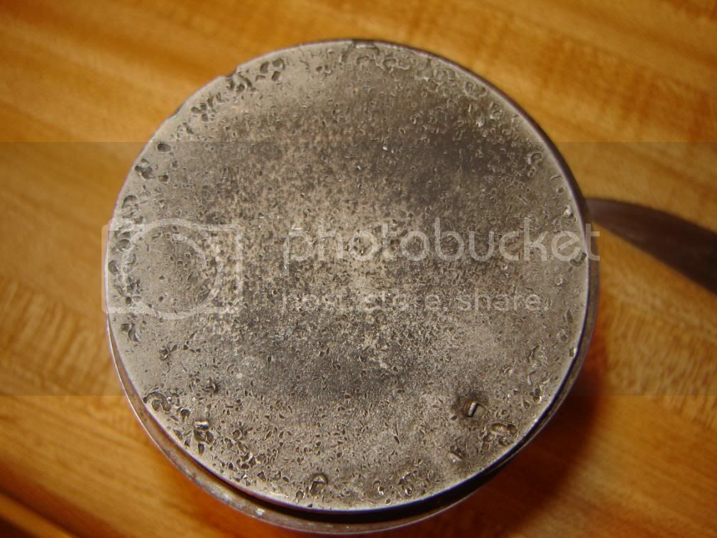

The top of the piston has a shit load of dings from the rod bearing flying around

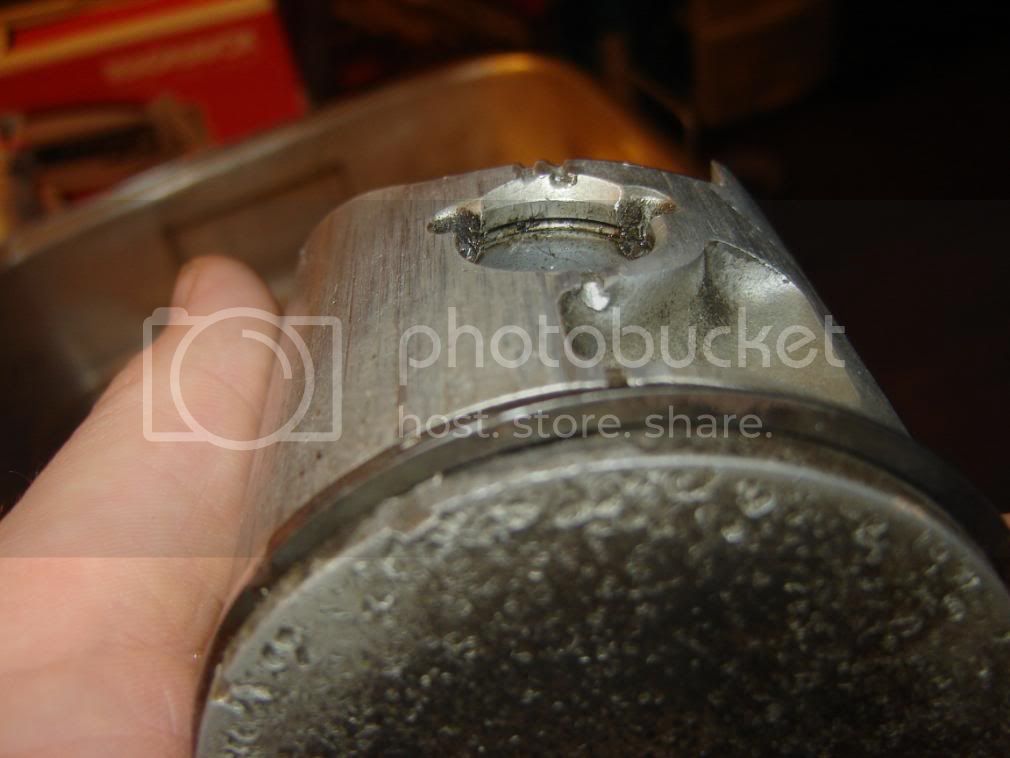

Huge grooves in the side. It melted the ring into the piston

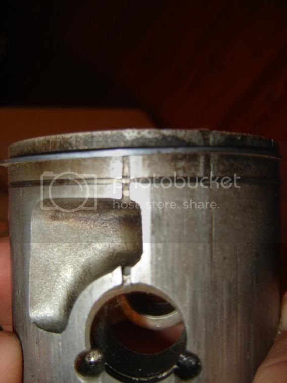

Another shot
And it even cracked the shield
Yeah I tried to tell him its not the same stuff. He got what he deserved because he didnt listen. We are sending the motor off to FMF to get a job done on it. Should be badass when its done.
