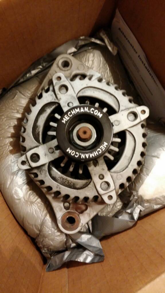

I purchased a 240A Mechman from SSA for my 03 Accord V6 back in May 2014. A couple weeks ago it stopped charging the battery. I had it tested at Advance, and it failed the output voltage test. So i sent it back to Mechman for warranty repair.
I got the repaired unit today. The invoice says that the alternator is functioning properly, but the brushes were at their limit. Correct me if I'm wrong, but aren't brushes expected to last at least 100k miles (if not far more)? I've had this alternator 1 year and 4 months... and i put maybe 20k on it tops (probably less).
Also, when i opened the box i rotated the pulley by hand, and it sticks at a certain point in every rotation. It takes a little effort for me to spin it beyond the point at which it sticks, and then it rotates freely until reaching that same point again. It's not so bad that i need to crank on it, but i do need to grip it pretty tight with my fingers to manually force it through this part of the rotation. And there's not a chance on hell i could give it a good hard spin and have it rotate itself through that region of resistance... just trying to give you an idea of how much resistance it has lol
Is important to note that the pulley did not previously do this when i sent it in for repair. I just took the new unit to Advance, and it tested good. But I'm really concerned about this pulley issue. Are the bearings going bad? And I'm also really concerned about how quickly the brushes wore out. I plan to contact Mechman again, but i wanted to get some feedback on these issues first. I am not reinstalling it until I'm confident that it will function properly.
BTW, I'm running 2 Fi Qs off an MD2D and Diamond S600 mids + Seas textile tweets on an MB Quart Onyx 4-ch (forget model #). I have a Die-hard platinum under the hood that tested good two weeks ago. 1/0awg Big 3. Belt is reduced size for smaller pulley (Goodyear gator something or other lol), no squealing or signs of wear on belt; however, mechman is claiming there's "belt matter" build-up on the drive side. There's SOMETHING on the drive side, but it definitely isn't pieces of my pristine belt.
By no means should this alternator be under excessive load, and it also shows no external indication that it is.

the pulley and internals should rotate freely, i dont think any hesitation is a good thing especially with just free movement in your hand, but im also not an alternator expert.
sounds like a bad alternator or its pulley, hard to say. ive had a friend have trouble with mechman properly diagnosing their alternator before, he spent 3 months and hundreds of dollars in shipping and hours of his time to send his alternator there and back to only hear that the alternator was "fine." it wouldn't excite unless he rev'd the engine up to ~1200 rpms, apparently they couldn't reproduce it on their bench so they blew it off as nothing. he sent it in a 3rd time and they finally found the problem and fixed it without apologizing, must of just figured customers don't care if they get jacked around

I am not an alternator guru either, but I wonder if the new brushes they installed under service repair may be a little tight on that one side. It may wear even over time and rotate freely. You may want to contact the dealer and explain the issue to them and get there feedback. Good luck, I just installed a 170 amp HO alternator from alterstart on my 2008 Honda Civic and the pully rotate freely, you have every reason to be concerned, these HO alternators are not cheap.

it won't hurt to add an engine block or alternator to battery ground, in fact it may help. shouldn't be any problem with running a ground from the battery to the engine, chassis, frame, or alternator for that matter.
i'd be concerned about the stiffness you felt in the alternator as well, if there's a local alternator shop that knows what they're doing and you really want to figure out what the problem is go talk to them.
