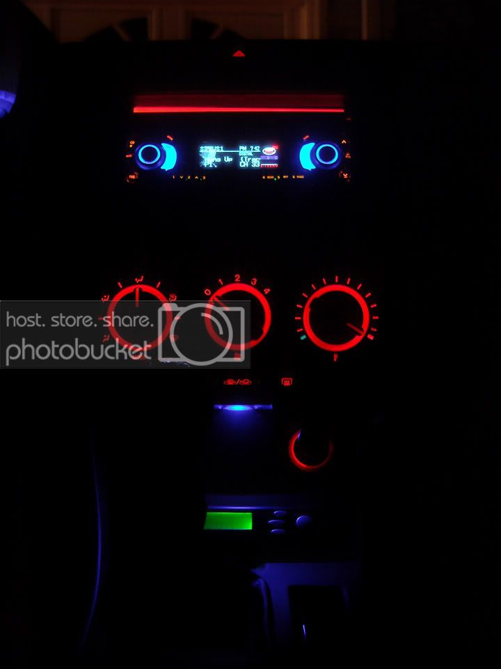

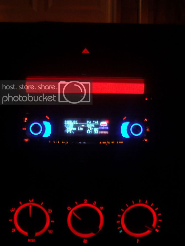

I've got a mazda3 and recently added an aftermarket head unit to it. No problems whatsoever-there are two dash kits available-one from metra and i forgot where the other is from. The only thing you lose when adding an aftermarket head unit is the little lcd screen above as it is connected to the radio. However with the 06 models, there is a seperate wire harness for the lcd display since it has climate control and trip computer functions so this probably wouldn't apply to you. I on the other hand ending up wiring my factory head unit into the trunk so i still use the display. Since the factory radio is single din, there's a pocket underneath the single din opening of the metra kit. I'll be getting some more images tomorrow in the light if you're interested.
As for keeping the stock radio-i used a navone loc for a few months to run my sub but once i upgraded the stereo had no need for it. People have used just a LOC though but the sq obviously won't be as great. There's also the JL cleansweep but if you're gonna spend that much you might as well just get a nice head unit. I like my eclipse because the colors go pretty **** well with the interior i think...
I took some pics tonite actually:
