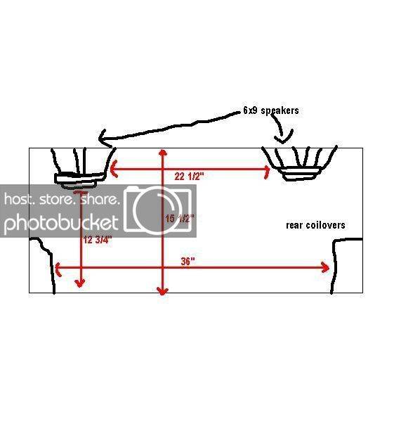

edit: i would still like to see some dimensions. im assuming we're are going to shoot for maximum efficiency as well. tiny alt, tiny batt, little power. gonna need some efficient equipment to get these going IMO

thats the measurements
and its about 22" from seats to hatch so 22" deep

also, if you build a box exactly 36 wide you will scratch the **** of you plastic that covers the struts
so you max width is more like 35.5"
and iirc its 22 deep at the top, more like 30 at the bottom
