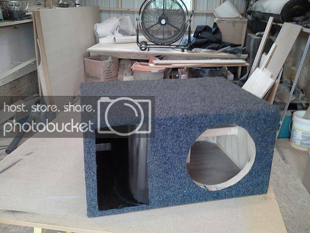

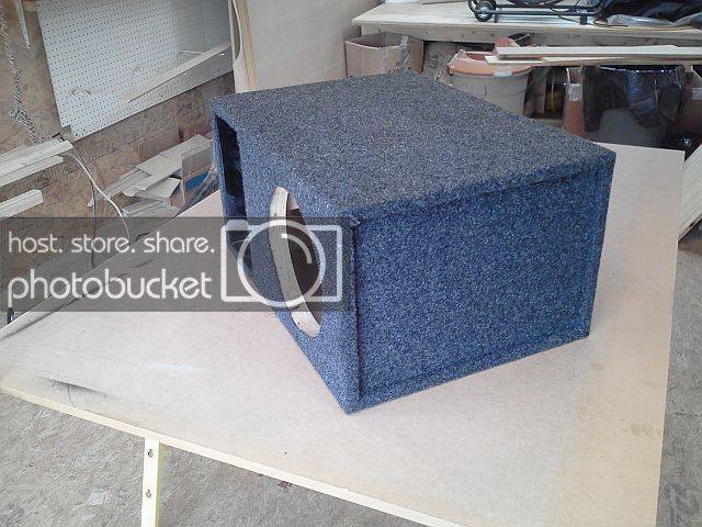

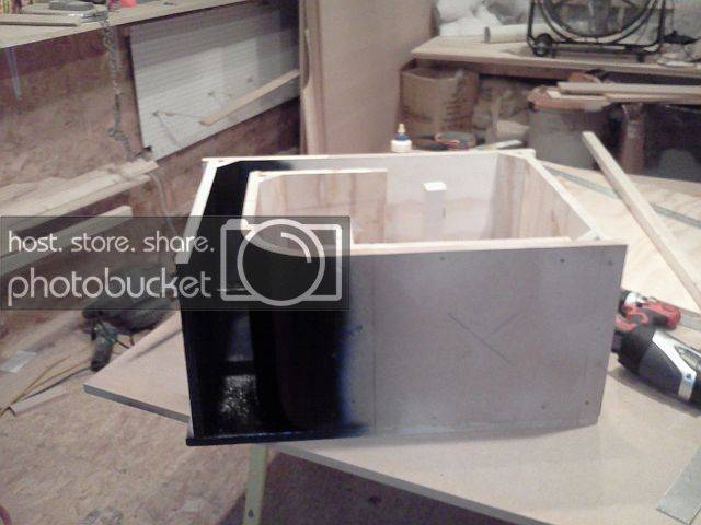

This was a local build that I done a couple of weeks back......It houses an AA Mayhem 12"....It's built out of 23/32" Arauco except for the front baffle......2.5 cubes and 35hz........He is running a DC 3.5k on it and man it sounds amazing!!!!....I will upload more pics later on after I finish his amp rack......
