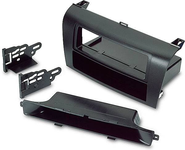

Since nobody makes a cheap 2DIN kit for my car, I'm gonna make one out of this 1DIN for my Mazda3 to house my new Alpine IVA-W200:
Of course, it's gonna need some cutting and fiberglassing to complete.. Is there anything I need to know about fiberglassing over plastic? Has anyone here done anything like this?
It's not gonna need all that much customizing to make it fit.. I need to cut out the pocket on the bottom and fill in the gap.. The cutting I can handle, I just don't know how well the plastic and resin are gonna mix.. Any pointers would be appreciated from anyone with experience doing something like this..

Ya, it looks like polyurethane is the way to go.. Now I'm glad I asked before I went and bought resin instead.. This is only a temporary solution anyways.. I will pick up the Metra kit when it's available, but I can't just have a W200 sitting around for months without being able to use it!! //content.invisioncic.com/y282845/emoticons/waycrazy.gif.f4a380c3f94043939fd369defd9e6be2.gif
you might want to look at it when you get that kit. the metra kit i got for my double din for my new jetta tells me to just cut out that middle piece and that makes it the double din
