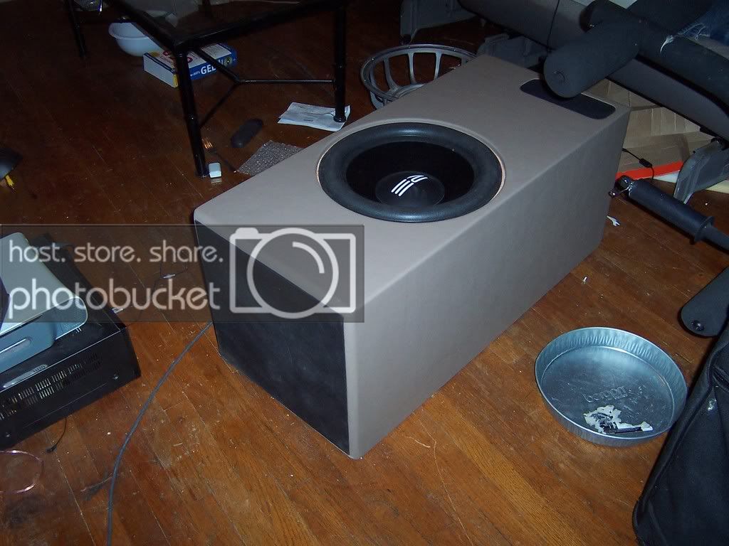

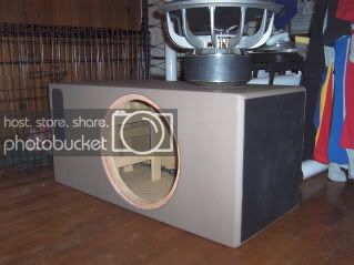

Lookie what I bought today!
i think it looks sweet, and i love the sticker backwards
LOL, that was the first thing my sister pointed out... "Uh oh, you put your sticker on backwards..." //content.invisioncic.com/y282845/emoticons/rolleyes.gif.c1fef805e9d1464d377451cd5bc18bfb.gif
Well seams are hard to hide with vinyl. I would get a 1/4 thick mdf covered with the vinyl and attach it to the sides to hide those seams. Usually when I would build a box I would have a half inch allowence for the sides and round that over and sand it, then get another piece with vinyl on it also and stick in in that slot. Here is a pic of what Im talking about
I know the port is small, it was my first box, and someone else did the math for me.
Well done man!
Yep -- round the corners, and use seperate cover panels that are prewrapped for the inset sides to hide stuff. //content.invisioncic.com/y282845/emoticons/smile.gif.1ebc41e1811405b213edfc4622c41e27.gif

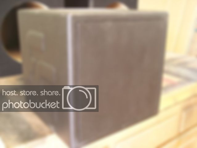

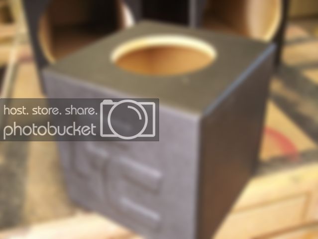

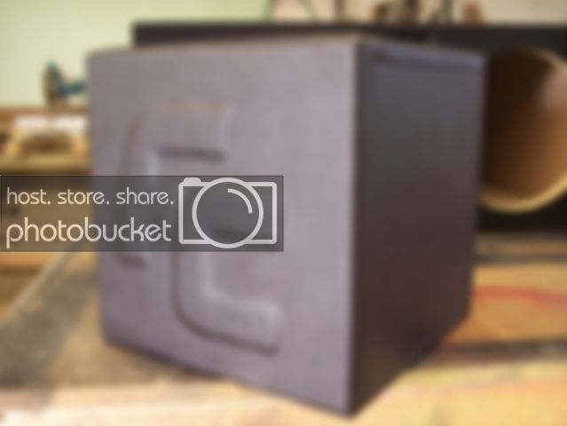

Round II:
Picked up a few technique ideas, so I thought I would give it another shot. Still want to do some things differently, as far as insetting the side, but I will get it figured out.
Thoughts on these?
The other side looks like poo, so I didnt take any pics of it, LOL.
