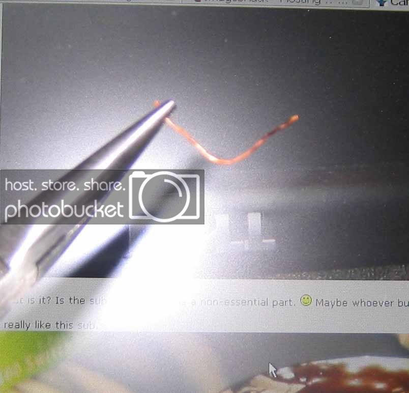

So this sub starts rattling and I put the old one back in my truck and forget about it. Cleaning out the garage, find the sub, decide to get it fixed if possible.... I can't find any answers, so I start looking at it closely. Nothing happens so I turn the sub upside down and right to left and this piece of copper wire falls out.
It's around 1 1/2" long and is bent a 90 degree angle.
What is it? Is the sub broke or is this a non-essential part. //content.invisioncic.com/y282845/emoticons/smile.gif.1ebc41e1811405b213edfc4622c41e27.gif Maybe whoever built it accidentally dropped it in there, right? //content.invisioncic.com/y282845/emoticons/thumbsupwink.gif.129404938effda6ad9cca39e7f4b58a3.gif

Looks like you got yourself a piece of the voice coil //content.invisioncic.com/y282845/emoticons/crap.gif.7f4dd41e3e9b23fbd170a1ee6f65cecc.gif
Read the resistance of the coils with a DMM. Make sure its not 0 //content.invisioncic.com/y282845/emoticons/crying.gif.ec0ebefe590df0251476573bc49e46d8.gif
what you might have is the connection from voice coil to tinsel. usually under the dustcap and USUALLY coated in CA glue.
prolly not "part of the voice coil"
but it could have been dropped into the motor when they clipped the extra connection.

I think req is on to something. 90 degree angle. Copper. Could come unglued. Looks like I could fix it myself, but would need to take off the cap, solder it back, glue it down, and then glue the cap back on. I'm hoping it's some random piece of wire, but I would think Ascendant wouldn't make any mistakes like that. Is this something that would come undone due the manufacturer or because I pushed it too hard?

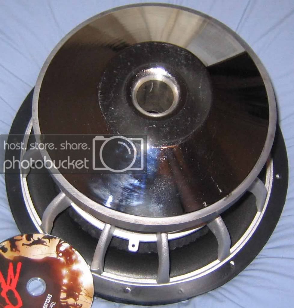

That DVD is a crappy promo I got from BB. It rang up free and had a ticket for the movie so I have a few. Used as a size reference in the full pic, but yeah it would be nice to have a copy of the movie right now. //content.invisioncic.com/y282845/emoticons/wink.gif.608e3ea05f1a9f98611af0861652f8fb.gif
