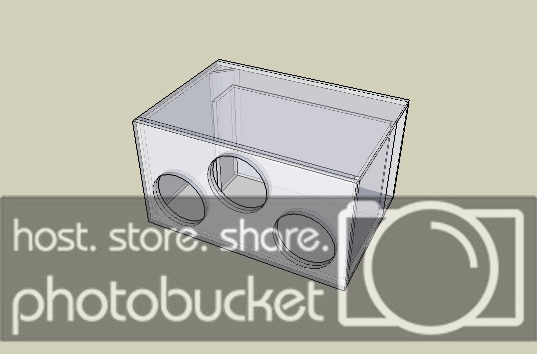

Local Buildup - Trey E - 3 JL w6's, 7 Cubes, 30HZ

Original W6s or V2? The originals want a huge ported box tuned really low for max flat response. The enclosure you have speced there is going to give you a huge response peak at about 35hz. It will also not be able to handle much power. With about 750 watts applied, you'll reach Xmax above tuning. You'll also need a subsonic filter set in the mid 20hz region to keep low notes from killing the driver entirely.
