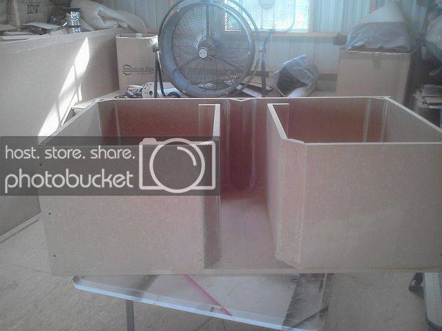

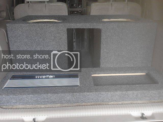

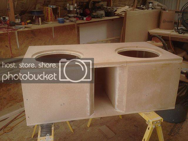

This is for 2 DC Audio LVL 4 15s.......just under 7 cubes net......34hz.......Subs up & Port back...........
I finally got to tune his amps with DD1 and meter this setup today.....It done a 148.0 @ 44 hz on music........needless to say the guy is pleased......Two DC lvl 4 15s and a Rubicon 2500 wired at 1 ohm nominal...
