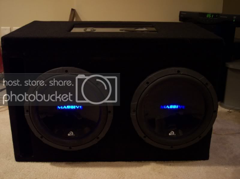

heres what im talking about. this is the dimming beast
cap wont do shit. more battery power will though (and the big of of course). i'd get an 800 or 1200 for the battery. you may still experienc dimmage with the 600. definitly get the 800 for 1200. itll be worth every penny....
put another battery in the back
also a really good idea. only do that though if u have both lead/acid (starter) batteries or both deep cycle. the kinetiks im preety sure are deep cycle.....see if u can get ahold of some cheap *** 40 dollar deep cycle for the front, and stick the 600 in the back, youll be set.
