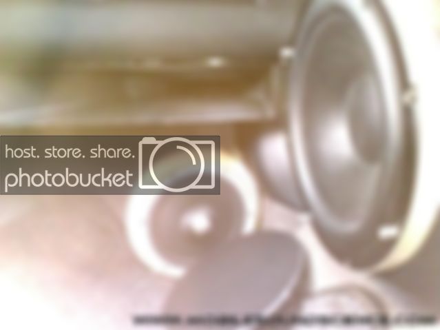

heres mine...06 altima..only way to fit was to flip them over..
passenger side needs the carpet/pad cut to angle it better..
