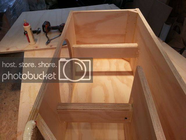

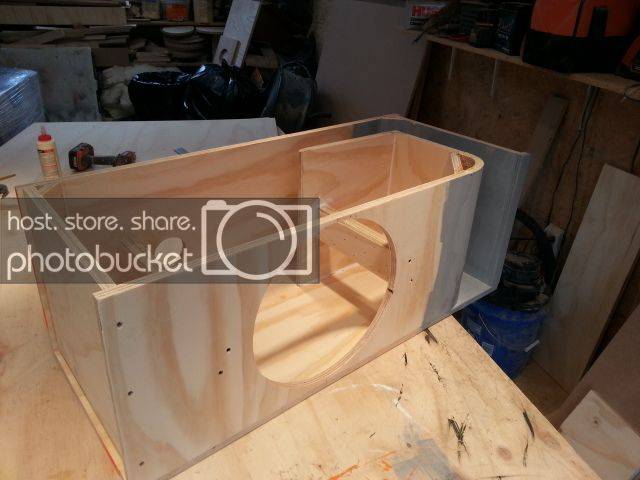

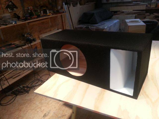

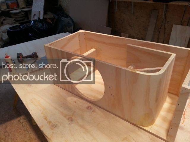

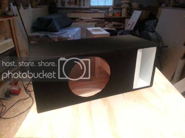

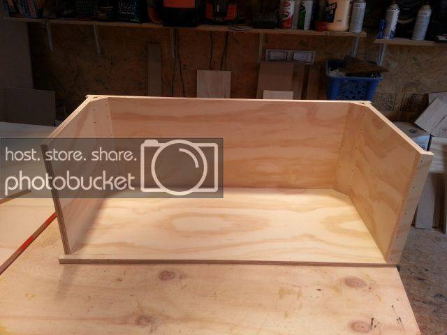

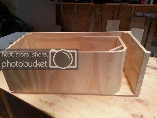

double 07 10+ year member CarAudio.com Elite 2,129 9 Etowah, TN May 5, 2013 #1 Single IVX 15" in 3.5cf net @ 34hz.....Arauco constructed....kerf port....black carpet...white port Click to read more...
OP double 07 10+ year member CarAudio.com Elite 2,129 9 Etowah, TN May 5, 2013 Thread Starter #3 What's the dimesion on that? Looks nice. Click to expand... Thanks...it's 16"h x 40"w x 17"d I believe...my card with the numbers are out in my shop...
