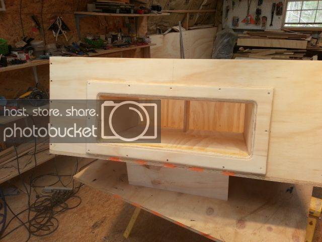

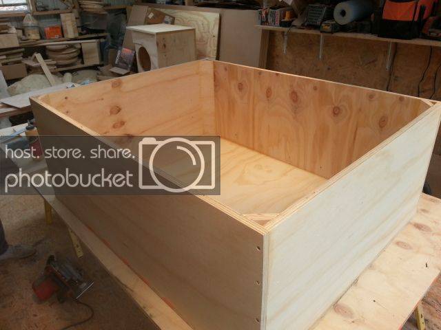

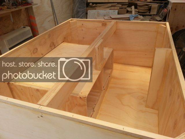

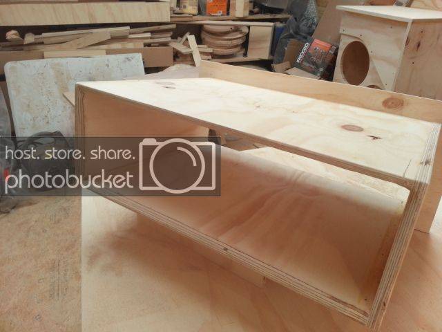

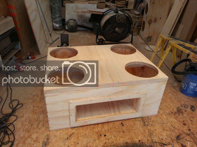

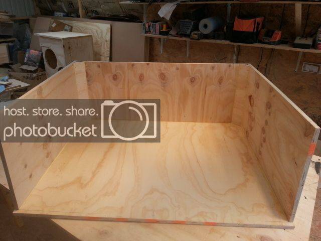

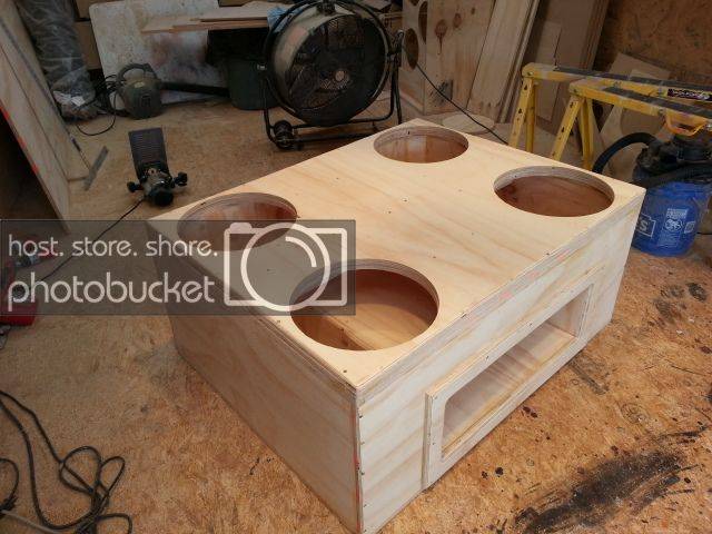

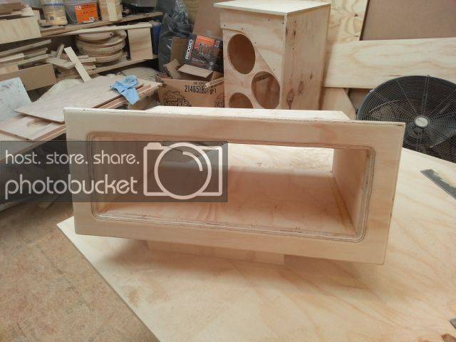

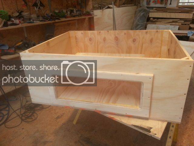

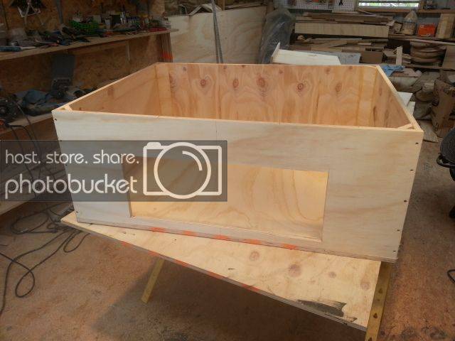

Four DC XL 15s in 13cf net @ 36hz....subs up/port back......Double top baffle......raw arauco enclosure.....NO CARPET.....
Dang that's a big boy there. Is he local or do you have to ship that beast? I'm thinking I'd like to do Arauco on the next one you build for me.
Looks great! Man that's one big port
Shipping it to Austin TX...this is for a buddy of mine.....He has had SEVERAL of my enclosures...He is one of those guys that changes setups a lot...LMAO
can you guys prep boxes for body match paint? usually requires bondoing screws and a skim coat of something over the wood, like resin or high build primer. you guys seems to always reinforce joints too so that would be covered already.
