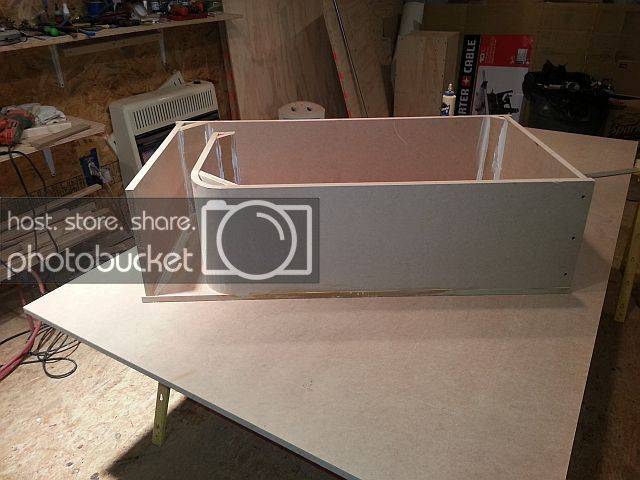

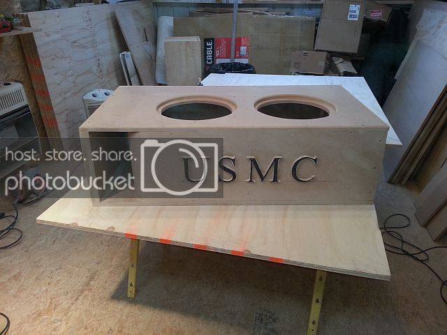

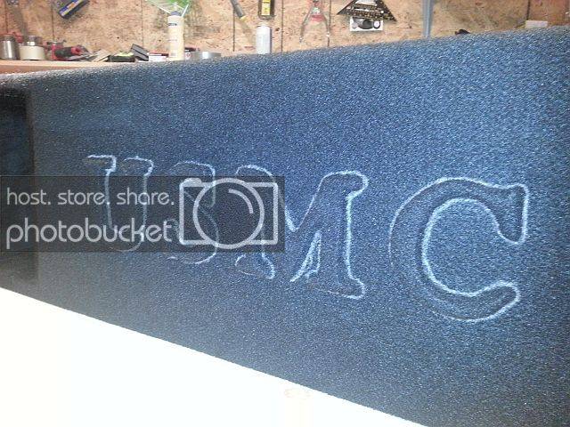

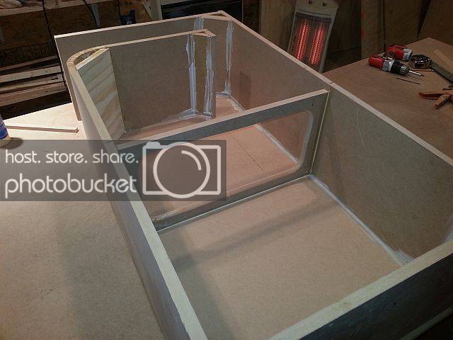

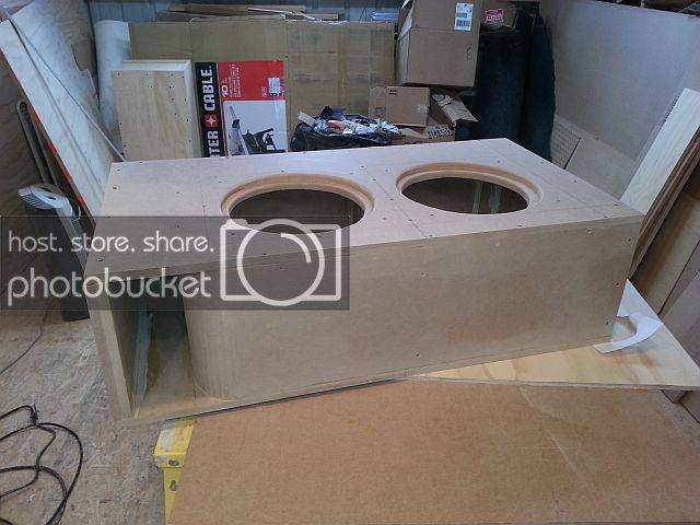

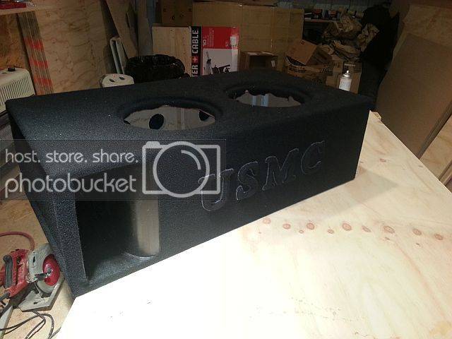

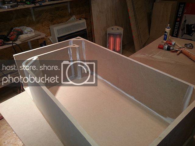

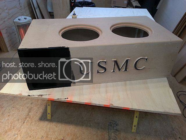

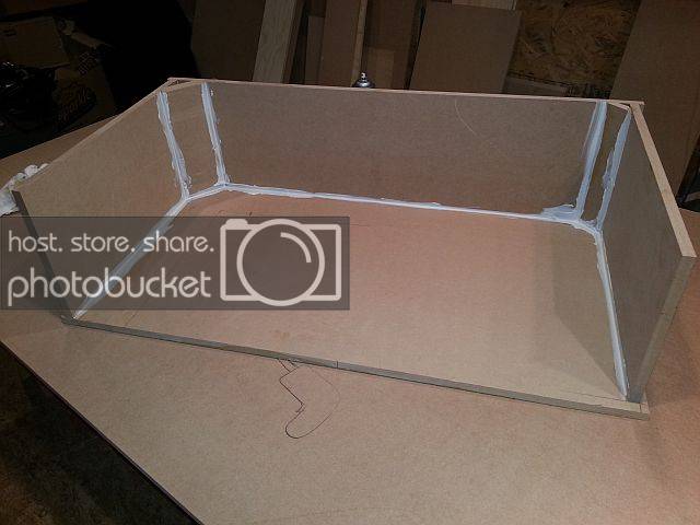

This is for two RE MX 12s.......4.1 cubes net 32hz......subs up & port back.......flush mount...kerf port......USMC logo on back....

IT looks great thanks again cant wait to start the install. I have had this setup for about 4 years and have not been able to get around to it I am so excited it is finally coming together. SEMPER FI!
