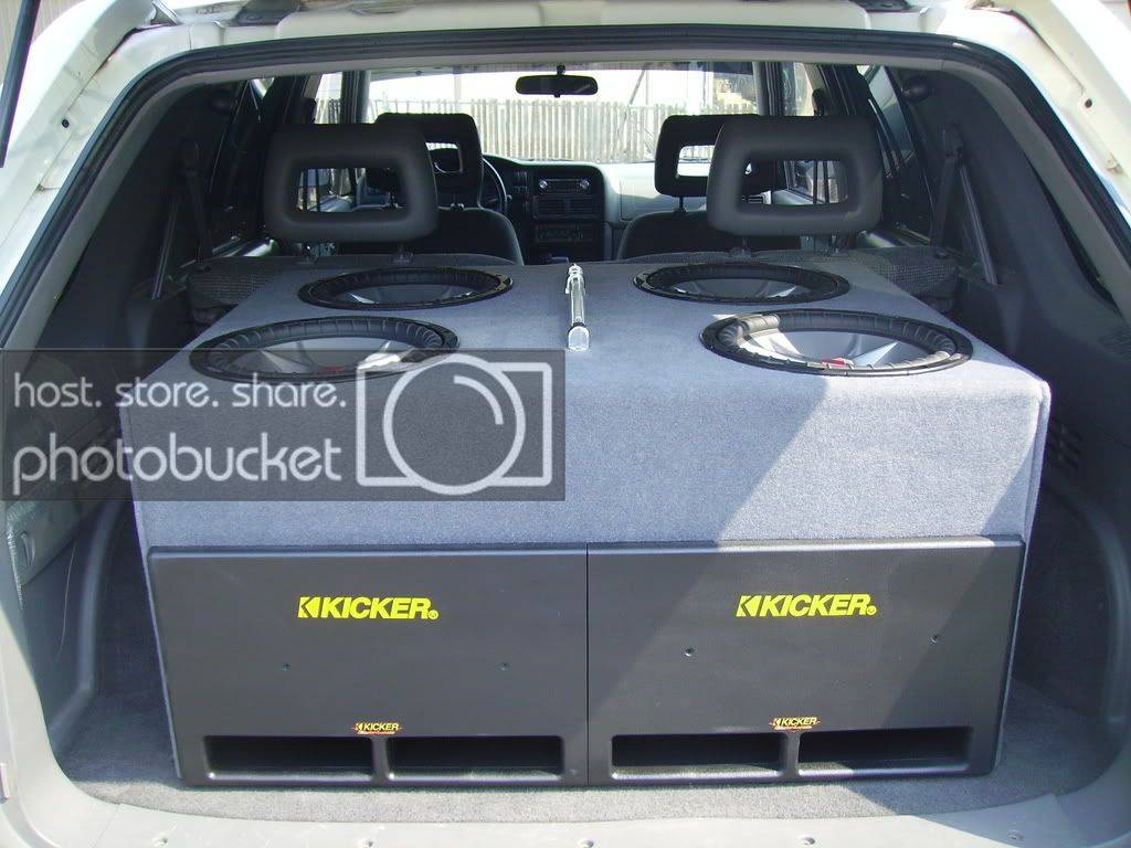

How about CRX style box? Like So.... Mines 8.4cuft Tuned 34hz.... Gets pretty loud... 145's 146's on music... 4x 12's... 2k watts
This is almost exactly what you need. Didn't mean to flame you so hard op, but your first attempt box would look nice n all but its just not practical.Your cu ft. and tune are good. the crx style box compared to yours will probably give you atleast another 3 db. all your equipment looks good though. Just do the big three and get your self a nice battery or two to keep your voltage up.

where could i find dimensions for this box in the pic??
ya they say that. but they dont give box dimensions or port size or anything like that. all of that would help out. something that i can look off of and build a box. thats help
So you cant fit a box thats 26x36x17?
Thats what size my 4 12Rs box was with 2 6in aeros
yeah you could use those dimensions above and port it. you'll stay around 6 cubes net if you port that size box with a slot port that is 4" tall, 20" wide, ~13.5" long (~34hz). and thats with a double baffle included in those dims. definetely possible. fire the port towards the rear
