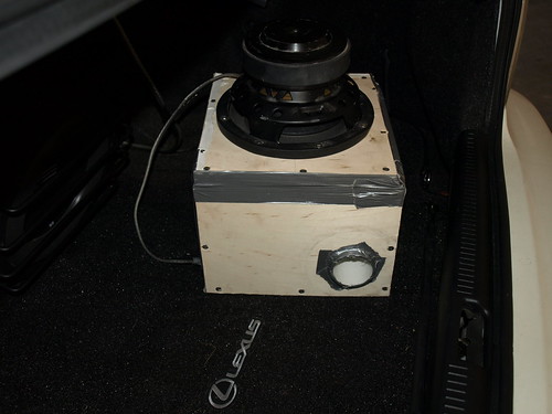

I know that nobody does Isobaric builds anymore, but I've always wanted to try one and since I have decided to go with 10's, I have e8's that I am gonna try some different designs with. The iso was up first because it's the smallest box and I could do it with the scrap wood I have laying around.
As far as the sound... it actually sounded pretty good, but holy port noise. 2" was as big as I could go without having to go external. Really solid lows but not exactly an SPL box. Tried it firing through my pass and it didnt' work. Corner loading sounded the best. Love the fact that the box is so small, but I just need more. Now I know why no one does iso's anymore. Don't know if it's normal but there was a lot of "chuffing" from the inverted sub. It also might have sounded a little better if I took more than half an hour to build it and actually used sealant instead of duct tape, even though there wasn't any air leaks.
Anyway, (2) Sundown e8's in .3cf and tuned to 32hz...

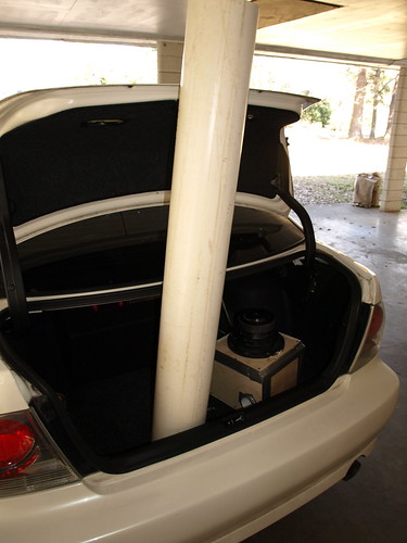

Up next, t-line tube... if I can figure out how to fit 8ft of tube in the trunk.
Isobarics work fine, but if the subs have any mechanical noise then you'll hear it. Also critical is where the subs face each other, it has to be totally airtight and lined up 100%.
A 2" port will never be adequate for a subwoofer so that certainly doesn't help.
Also, the output is only going to be equal to a single sub so with 8's it's not exactly gonna hurt your ears...
I've only used it once personally on a pair of twelves and the SQ was quite good and the box size small, but a single sealed twelve just doesn't have the output I like, so I only kept it in a few days.
T-line with the e8's fs of 34.9 = 8ft of line. Obviously I will have to put some 90's in there or fold it with a box, but I have that pvc laying around so...
Yeah, the ouput is -3db of one, but with twice the power of one I figured it might even out. Like you said, the SQ was quite good, but the output wasn't overwhelming. Maybe I'm just used to my ported DD 10 though. I will say that the subs weren't exactly frog's *** tight, but I didn't want to ruin the gasket by nutting them down. I may try a 3" aero external and tighten the subs up tomorrow to see if that cleans it up.

Your T-line doesn't actually need to be 8ft long...you can use fiberglass insulation or pillow stuffing to fill the line and make the effective length longer. A 6ft line stuffed properly will have good extension and is much easier to fit.
