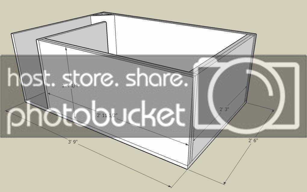

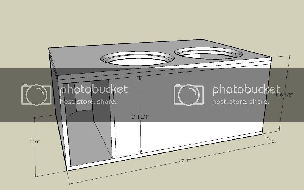

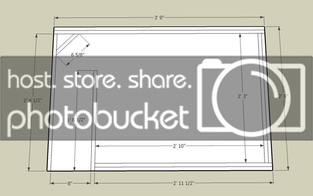

Is this to big off a ported box for 15" cvr's
rookanga
I don't want to build a box and find out it is two big for I'm just wondering if this is two big for 15" cvr's
Specs come to:
-8.1 cubic feet net
-32.5hz tuning
-130 sq inches of port area
