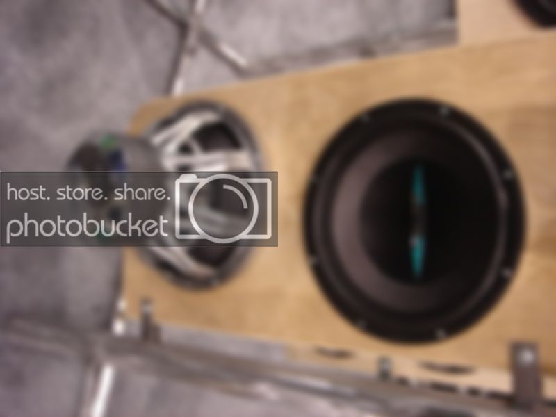

Is this a no no?
ThomasG
Ive been told bye some people that your not supposed to do this and ive seen proffesionals do it at car shows..
Having one sub sticking out of the box and having one going in the box
Meaning you switch the positive and negative.
You hook up the amp positive to the subs negative, and the amps negative to the subs positive.
Exactly...
If you wire them both the same both subs will be pushing out when you are playing them. One pushing out will be going in the box and the other pushing out will be out of the box. This will cause them to cancel eachother out.
If you wire the one sticking out where it fires in reverse, both subs will be moving in the same direction (out of the box) and no cancellation will occure.
Exactly...
well said
I like the look of one going in the box and one going out. I really wanna do one going out of the box because the GTI is a large sub and it looks pretty cool
