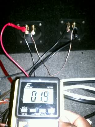

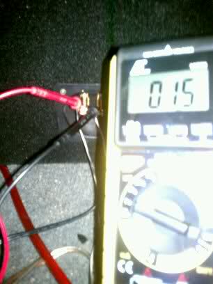

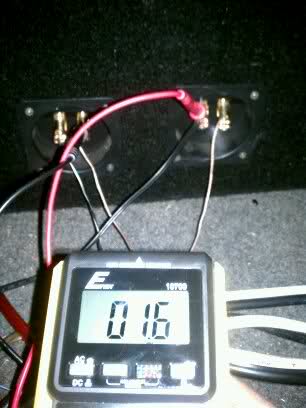

I tested the terminals...well ill just let you see. I read somewhere this is not an accurate way to get the ohm load but i just did it anway. I set the DMM to 200 ohms and tested each terminal at the sub, while still wired though. Each + and -terminal combination gave me 1.5-1.9 ohms. Im lost as u can see idk wth im talking about lol but here are some pics of what i did.
1.
2.
3.
4.

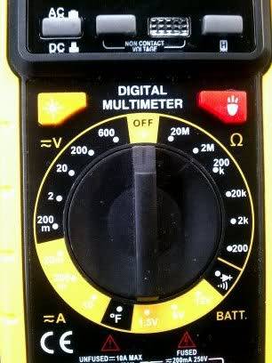

@akheathen - If you could, can you tell me what to properly set the DMM to to test your methods. Here's a pic of my DMM
Disconnect the speaker wire from the amp and get a final ohm reading of both subs using the speaker wire that goes into the amp.
Measure the voltage while the car is started, with the - lead on the amp ground input and the + lead on the amp positive input than test the remote wire + on the amp also using the amps -

lol, put your meter on 200v, and put that ac/dc button on ac. do it first with the speakers off. then do it with the speakers on and see how high the voltage goes before it shuts off. you have 2 2ohm loads on it, so you can series those to 4ohms, instead of running them parallel. however, looking at your readings, you may have cooked wires...they look kind of pansy. so, while you have the wires disconnected, ohm each on out. that reading that you took that shows 1.9, is .4 higher, and that's all in the speaker wires. basically, paralleling the 2 wires you didn't have the meter on, so it should read like .8......... sounds like you are getting extreme resistance in the little wires, reading over 1ohm each without load, blah, blah, blah.... basically, i believe they are cooooooookeed..... start with those, then see if it still does it
