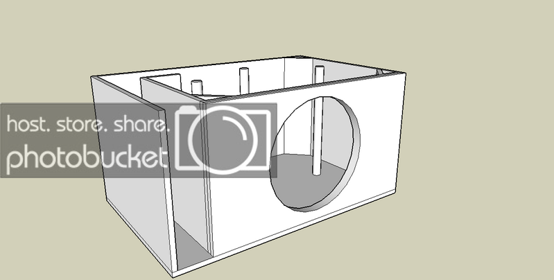

is 102 square inches...
You really should just go with what mazdakid said, 6.5cubes, 80 square inches port. You seem to think that the bigger the box gets, the lower and better sounding it is. This is not true at all. The tuning frequency, and port area are by far the greatest factors.
just as a visual here is the box...
