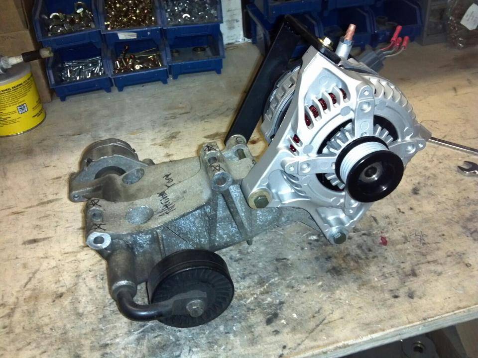

I contacted mechman, dc power, singer, and excessive amperage about sending them my cars Alternator bracket. Which has my cars tensioner on it and it is where the A/C mounts to. Dc power, singer, and EA said that they can't help me. Mechman said they could sell me a universal 220amp alternator that I can play with.
I sent my bracket to Iraggi. Dominick grabbed a Ford casing. And it mounted like factory to my A/C mounts. So no need for anything custom. And he added a idler pulley.

But. I just measured the space between my Bracket and the radiator. And it is a close car. There is about a 1/2 to 1" clearance. And I am going to have to get the radiator hose out of my way.
so there are some obstacles that I have to overcome. I am 22. I am not a fabricator, and am not some expert. But I know with help I can get this done. It may take a while though. I plan on starting as soon as I can drive my other guy. First thing first. Will be to pull the motor.
My friend came up with a great idea. My car currently has an A/C radiator. It is 6 inches wider than a Non A/C radiator. That might give me the space I need without have to hack up alt or bracket!
