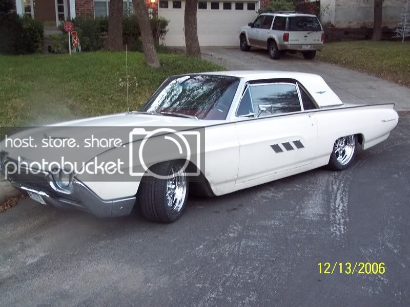

Hi... I have a 1963 T-bird that I want to install some new speakers, tweets, subs and amps in but want to keep my classic radio.

Just out of curiosity, was that car at the Seaside,OR car show last June? The cable you posted would work. Than if necessary, get a female to female connector and add a longer RCA to it.
Nope.. This car has never been to OR as far as I know and definately not in the last 5 years.

There was a car very similar to that one than. About the cable - I meant if the cable wasn't long enough to get to the amp from your IPOD. Those are only four foot cables. Not sure where your amp will be, however if you are going to put it in the trunk, you'll need an extension. That's why I mentioned a female/female plug and an RCA extension, but on second thought, if you need the extension, just get a female to male extension. I'm thinking of a different application. Sorry about the confusion.
