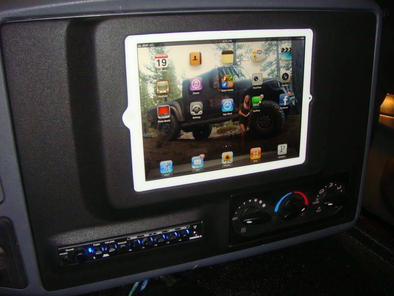

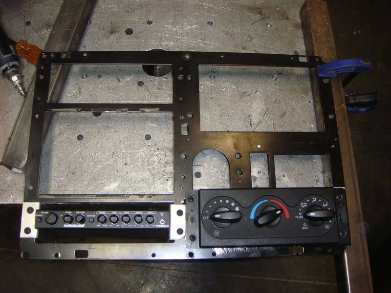

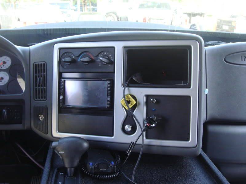

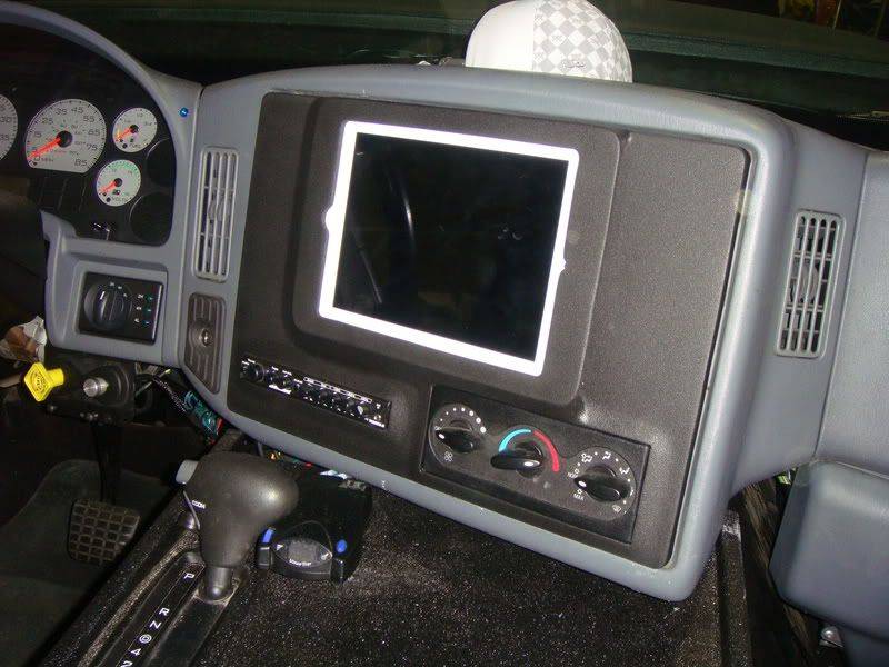

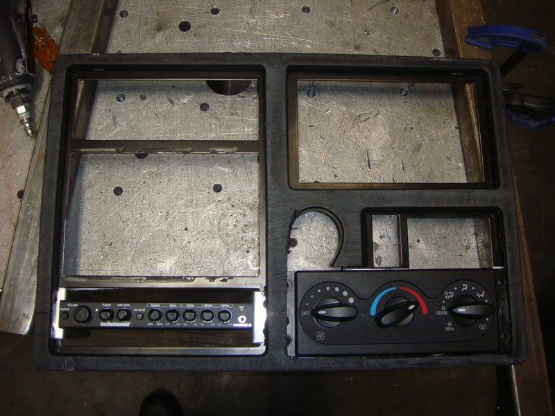

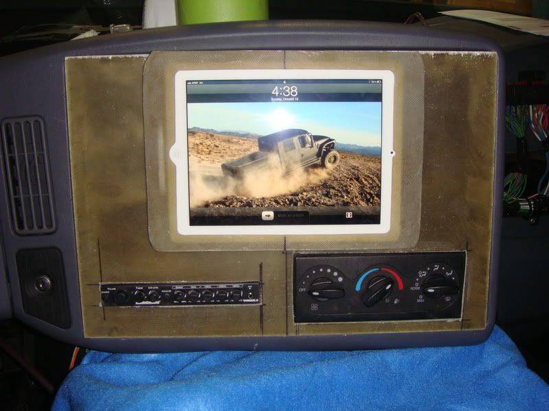

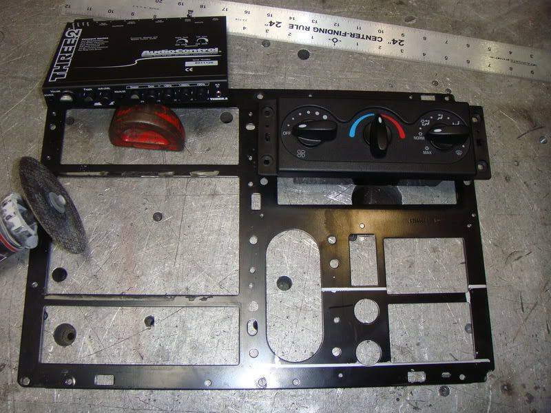

This is my friend's '08 MXT that I will be installing an ipad 2 as the source unit with an Audio Control Three.2 EQ. I will be relocating the air brake switch and the turbo boost knob to a bracket just below the steering wheel to the right and the HVAC will also be moved.
I went up to SoundMan last week and met Doug and Jonny. Doug hooked me up with the iPod pan, 90 degree passthrough, and the Schose AV cable. Both great guys that answered all my questions no matter how dumb they might of been. This will be my first iPad install and thanks to SoundMan this project will be alot easier using their products.

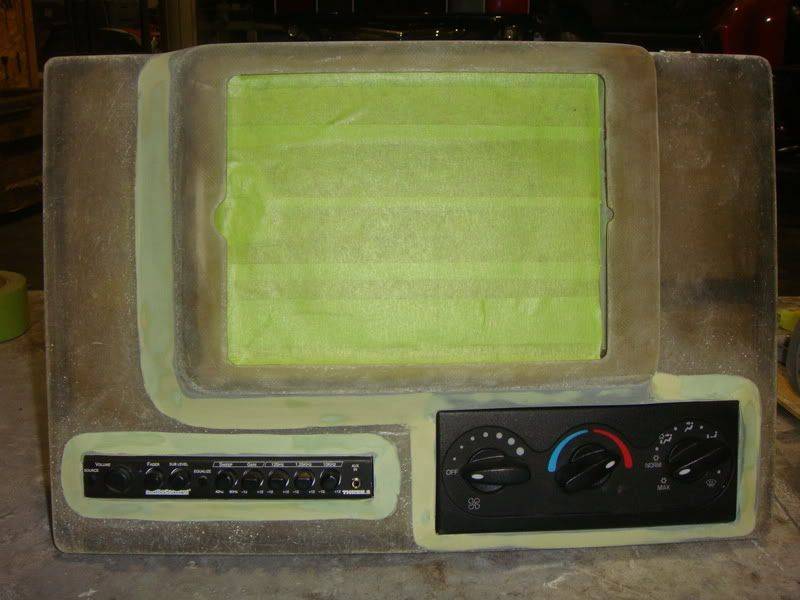

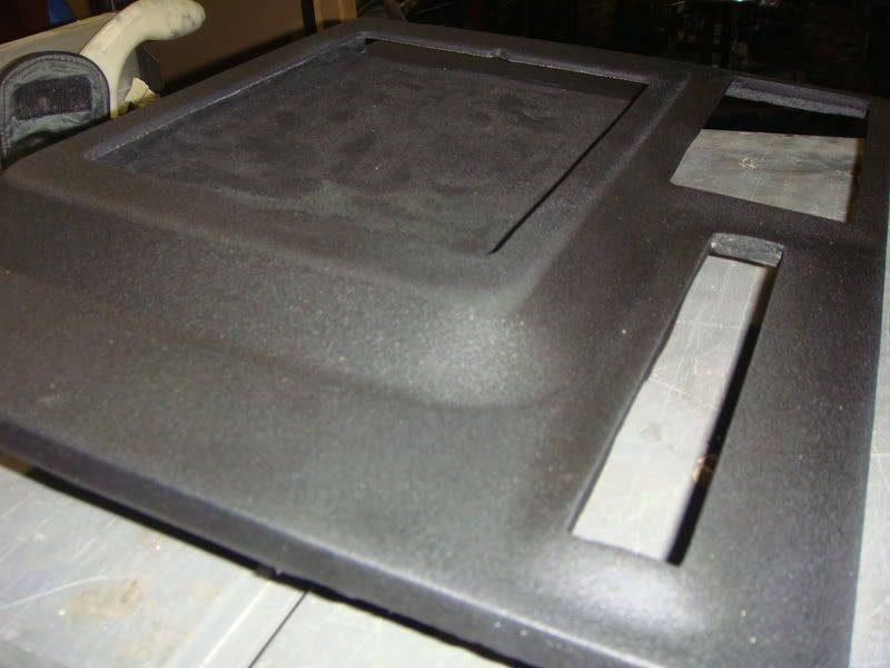

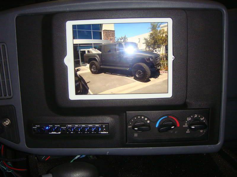

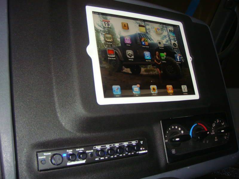

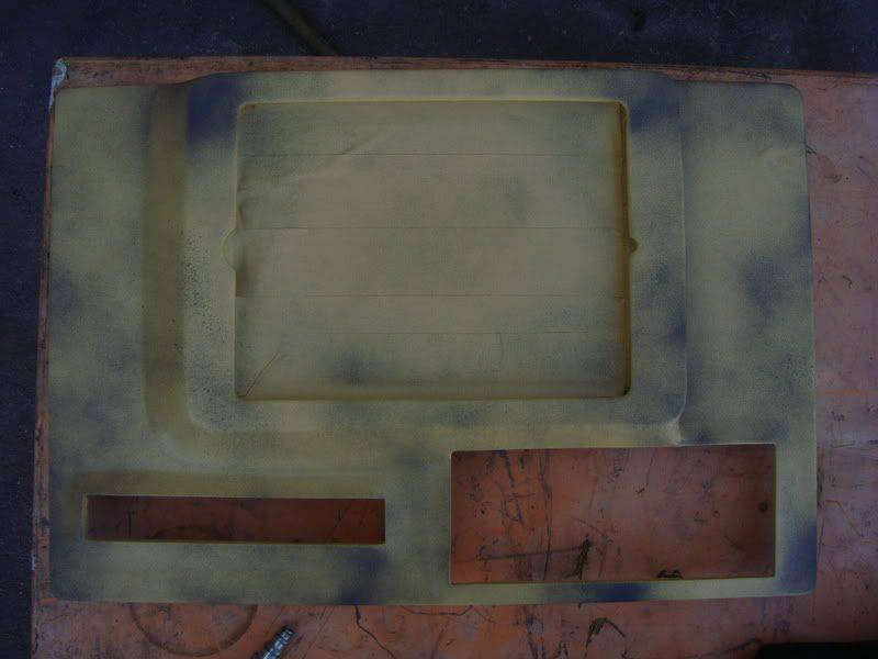

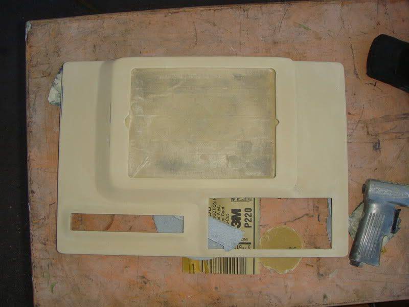

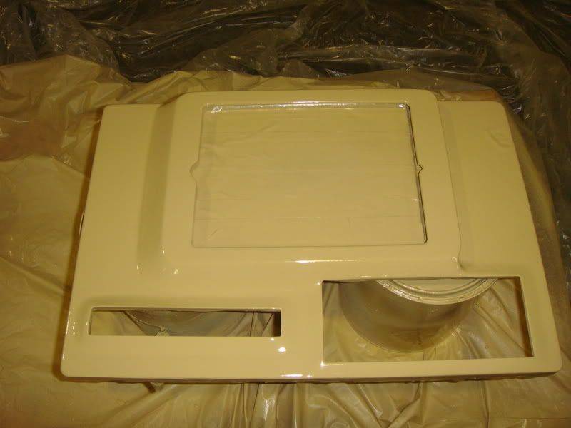

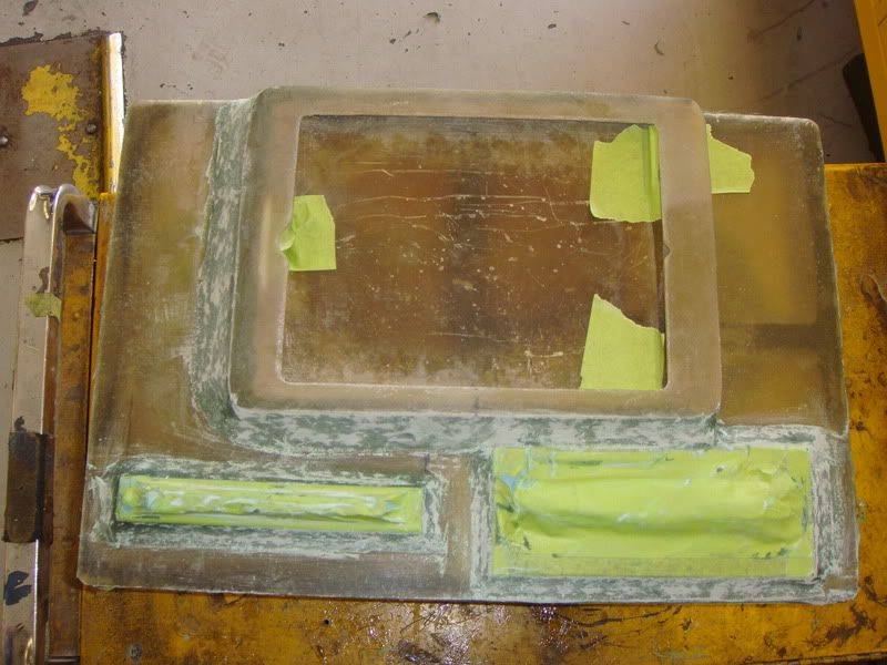

I guide coat sanded to 600 then sprayed with Duplicolor Truck bed liner to match the center console/sub enclosure with 2 15" Treos that has been Rhino lined along with complete exterior of the truck.

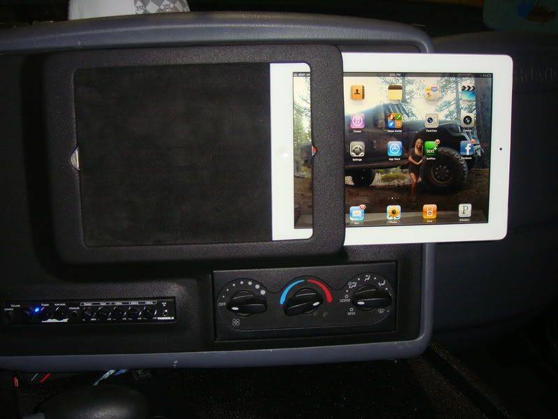

I then added a sued insert and epoxied in the 90 degree passthrough.
