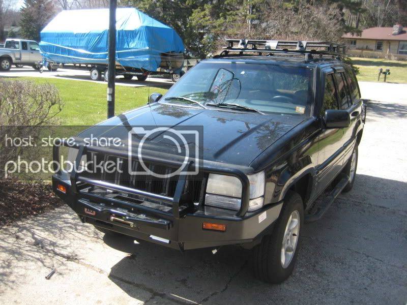

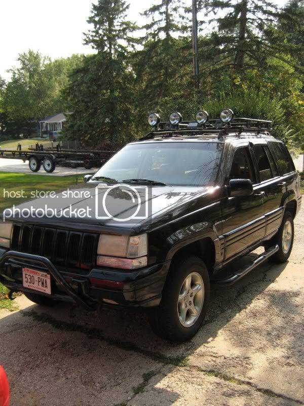

Just realized I didn't have a build log up on here, so I figured I would put one up. Here is when I first bought my Jeep:
Threw a Defender roof rack on it:

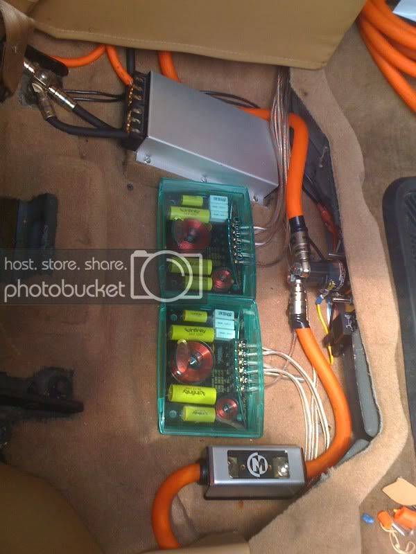

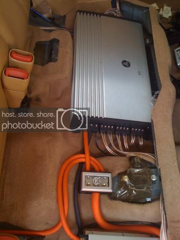

Here is the start of my install, had a JL G6600 under the rear seats, powering some Infinity Kappa Perfect 6.1's, along with an Alumapro 5 farad cap.
Started off with a 10" custom Fi BL powered by an Infinity 1210a, was pretty nice until the surround tore. The box was the first one that I build and was pretty horrendous, so no pictures lol.
Next setup is my Lightning Audio Storm X2.H10.V4 Neo, powered by a Lightning Audio Storm X1.2000.1D:
In that pic, the 4 gauge went to the cap, the G6600, and my Infinity 1210a. Now I have a 1/0 run back to my 2000. And I will be ditching the cap soon, I now have 2 Stinger batts in back.

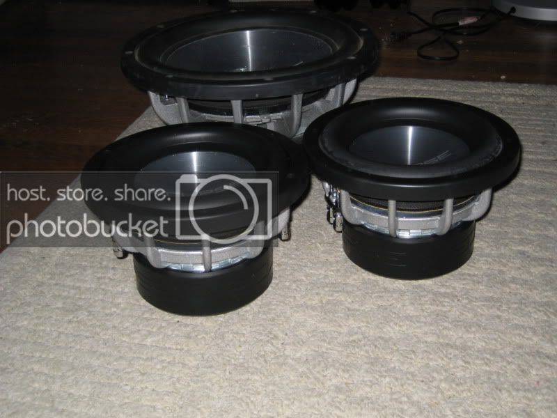

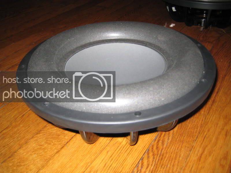

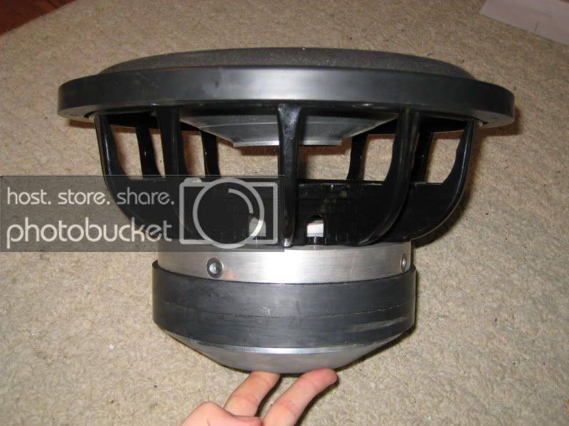

Then managed to find some awesome old school Eclipse subs (I am a huge Eclipse guy, I've got tons of Eclipse stuff laying around waiting for a 2nd car to be installed in), so I built a box for them.

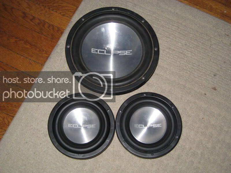

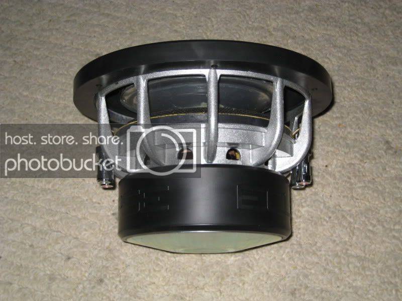

Eclipse 88080DVC's next to my old 88120DVC

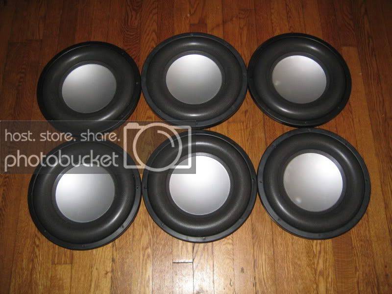

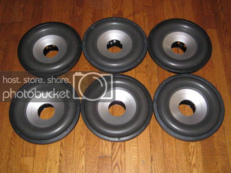

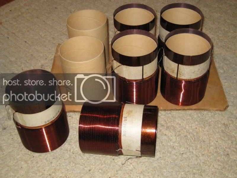

On to the new build, the only multi sub setup that I have had is this 4 8" setup, so I wanted to try something a bit bigger. So I will be building 6 custom 12's with TC9 motors. Gonna be using standard 12 spoke baskets, real nice Ground Zero 12" cones, oem TC Sounds 4 layer roundwound coils, along with 4 8" spiders and double leads. And if I can find some more of these QCA's, I will be using these on all of them, currently have 2. If anyone has an extra, hit me up, I want it lol.

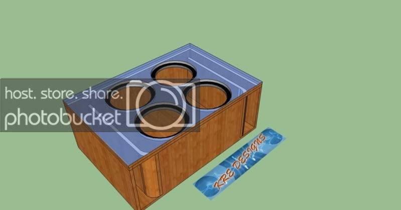

I currently have a 2nd X1.2000.1D that was blown over at Tubenut's shop (Great guy, will definitely be using him again for any amp repair needs), and along with repairing it, he did a few mods to it, should be about 2500@1 ohm when all is said and done. So as soon as I get that back, I will be sending him my current 2000 so he can mod that, and then will be running them strapped on all 6 at 1.8 ohms (coils are D2.5's). I will probably be building a box for 2 of the 12's with a single 2000 on it, and then got this design for 4 of them:
Pics of the sweeeeeet cones:
With full inverted caps:

And the coils:

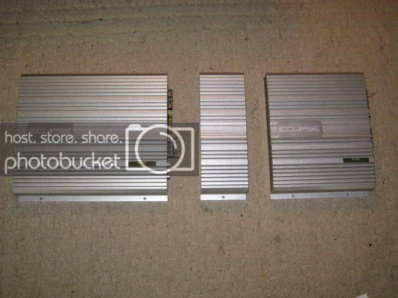

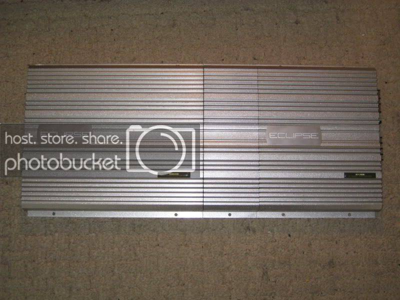

I am a huge Eclipse fan, and I have been searching for one of these to go with my DA7232 for over a year, and finally found one //content.invisioncic.com/y282845/emoticons/smile.gif.1ebc41e1811405b213edfc4622c41e27.gif An amp bridge for that series, here it is with my 3242 and 3122:

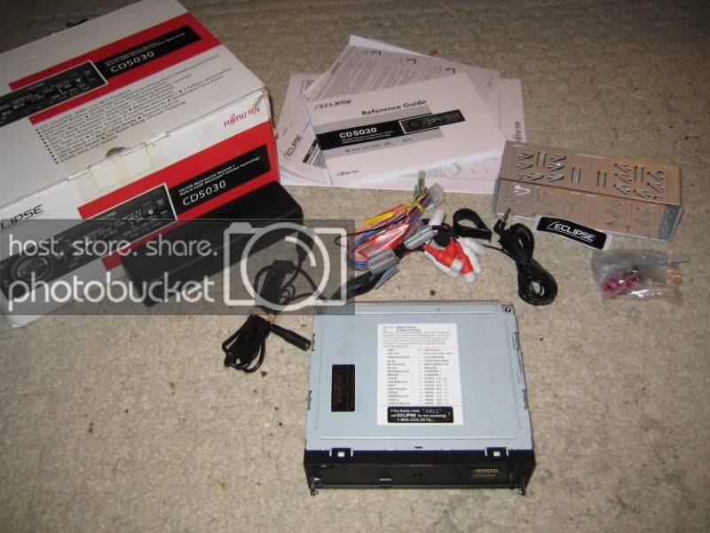

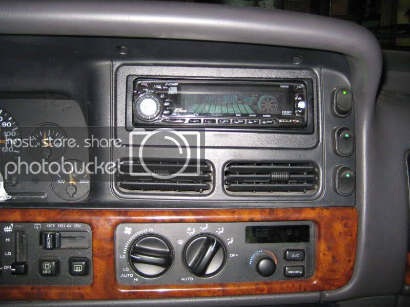

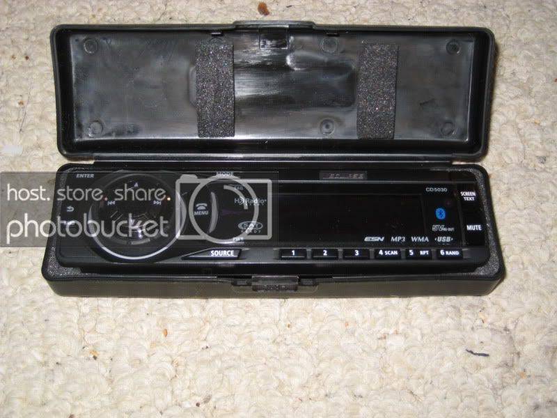

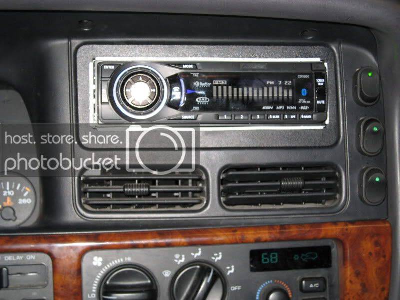

And I got a new deck, an Eclipse CD5030:
Pretty sweet unit, built in ipod and bluetooth. Scored it for a great deal on ebay the other day. It will be replacing my 55040, will be nice to have something a bit newer with ipod controls, bluetooth, usb, and steering wheel controls as well.

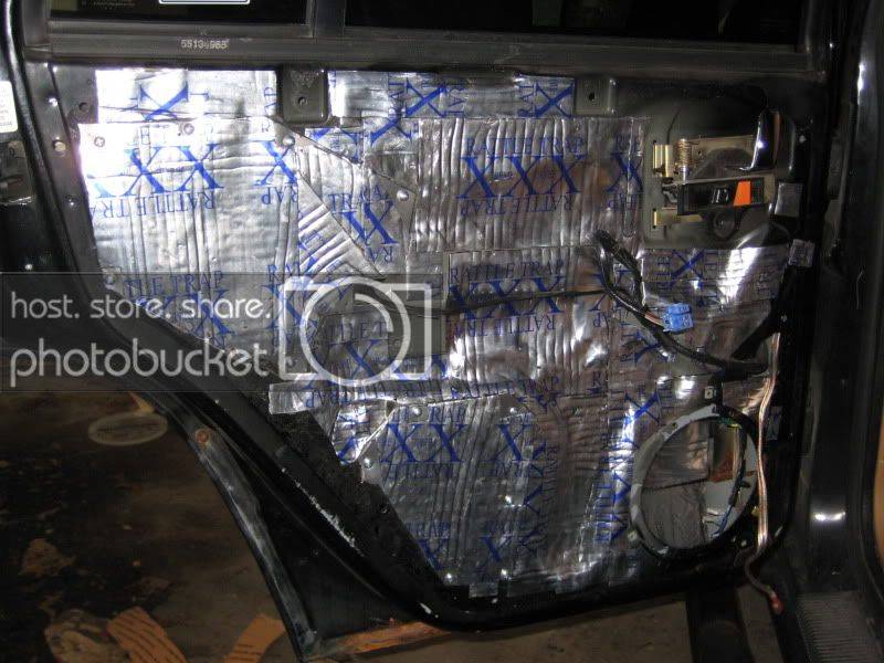

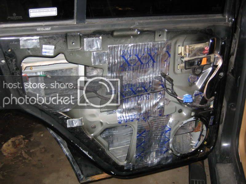

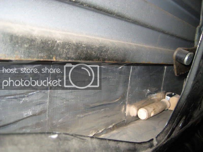

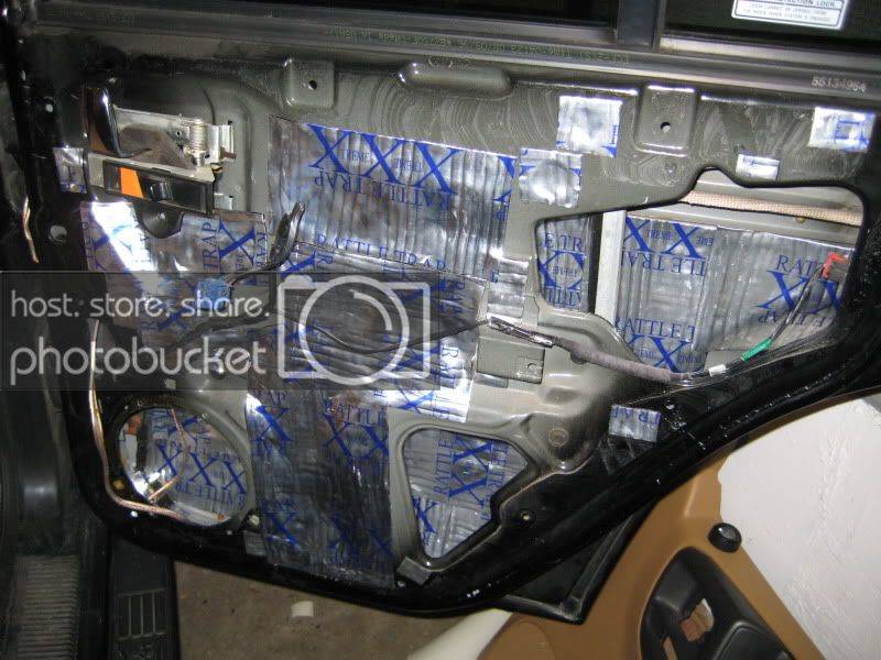

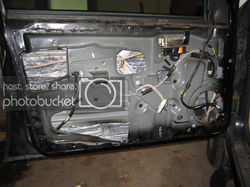

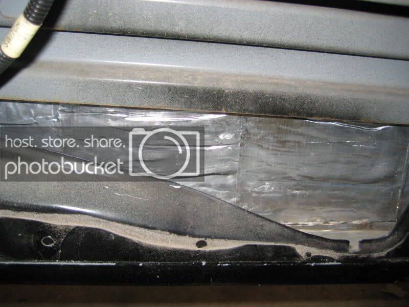

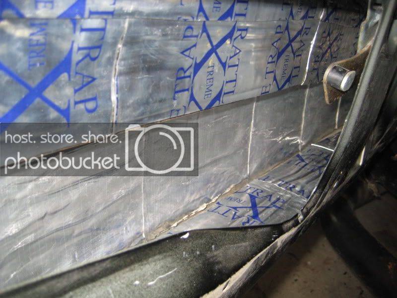

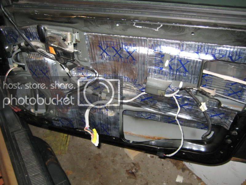

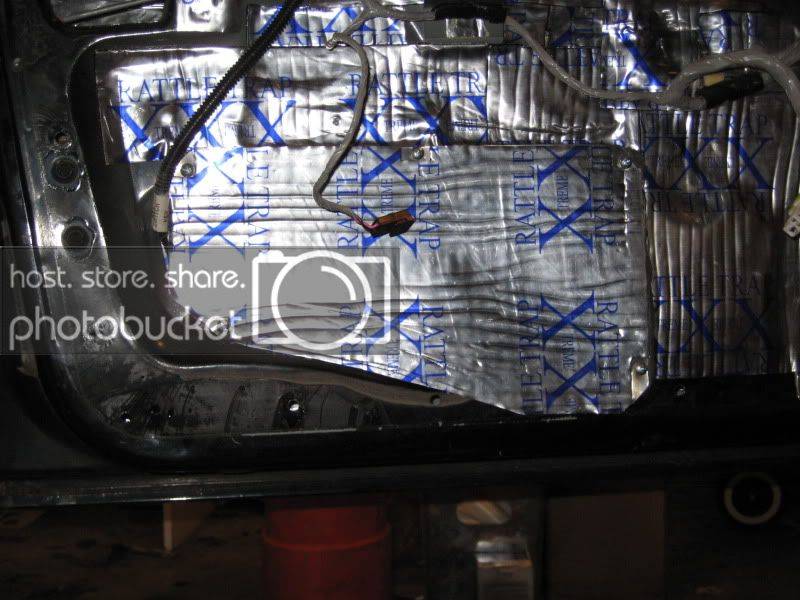

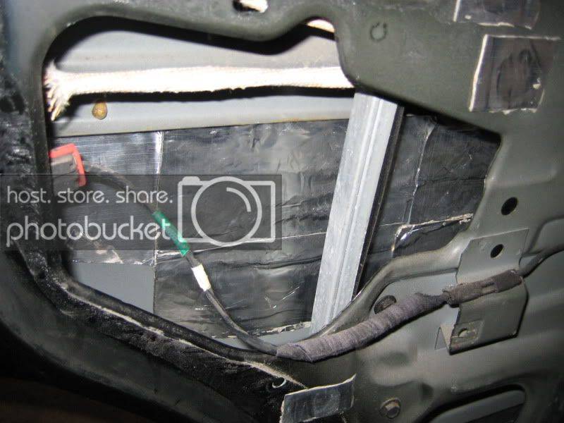

Started with my deadener install! Used a mix of Audio Technix 60mm and RattleTrap 80mm. This is my first time working with any deadener, so feel free to give me any pointers that you guys have. Here is what I started off with:

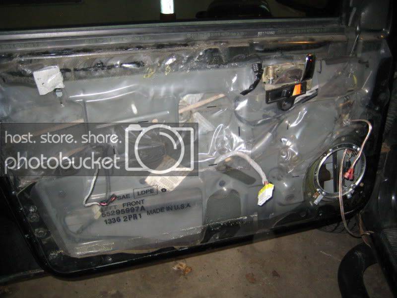

Took off the layer of stock coverage(it actually is pretty nice, I would like to reuse it on top of the deadener that I put on, anyone have any suggestions on how to re-secure it?):
Then removed the plastic:

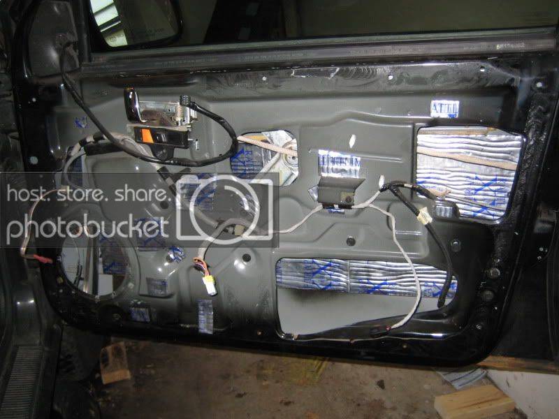

Started the install on the door skin:

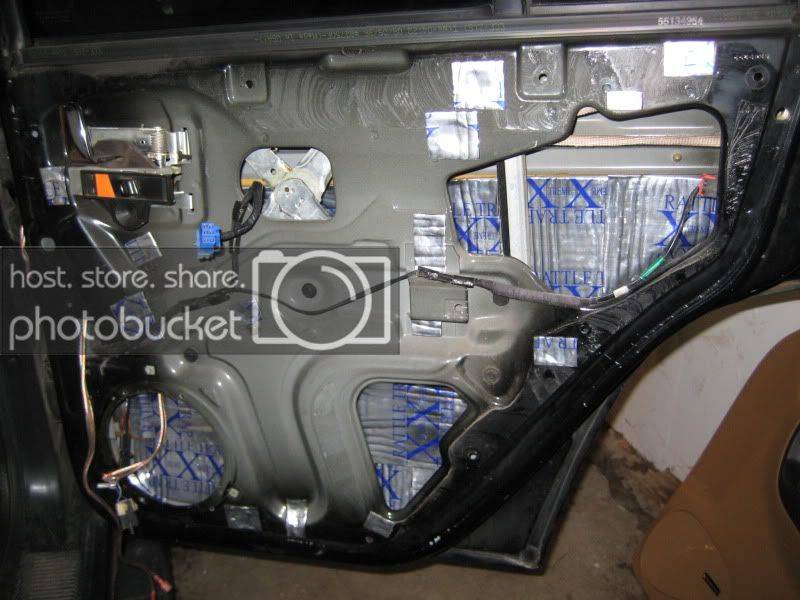

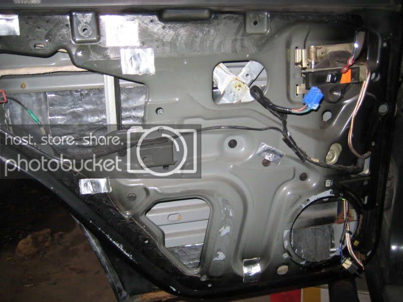

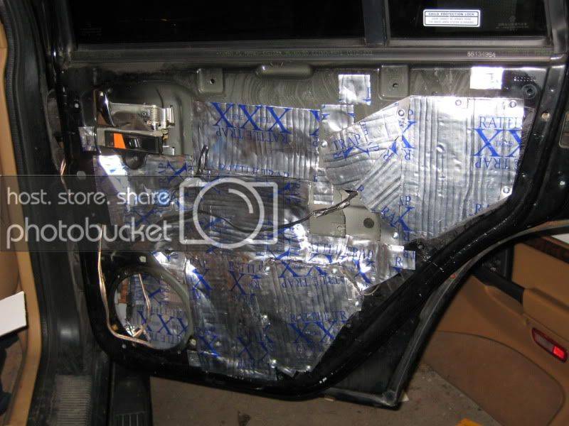

Then to the drivers side rear door:

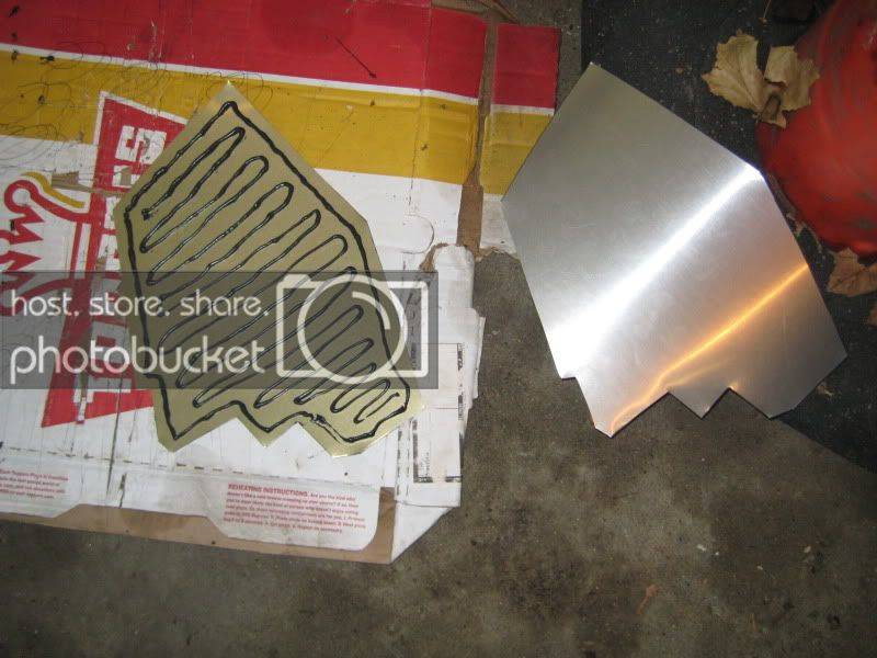

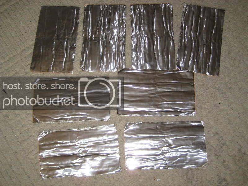

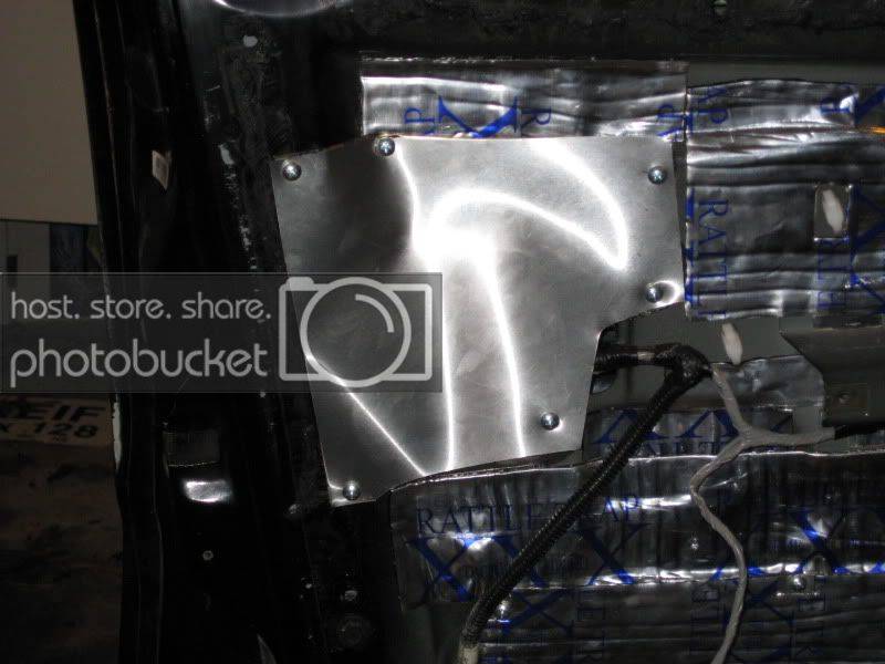

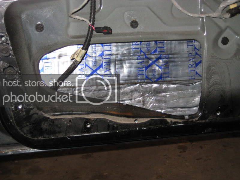

Picked up some aluminum flashing to fill the large gaps in the doors as well. On to the progress:

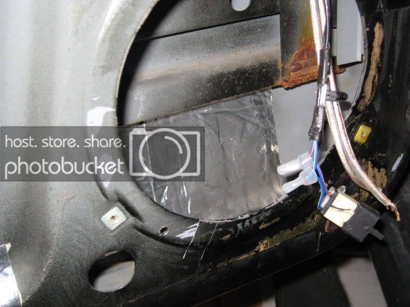

Got the passenger side started as well. Found a problematic rust spot in the inside of the door, underneath the caps on the door, so I ordered some POR-15 to fix it. The rest of the deadening on that side will have to wait a few days.

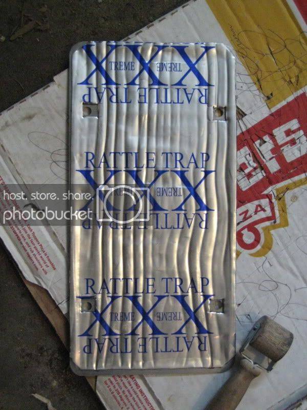

And can't forget to deaden the license plate:
A bit more work done:

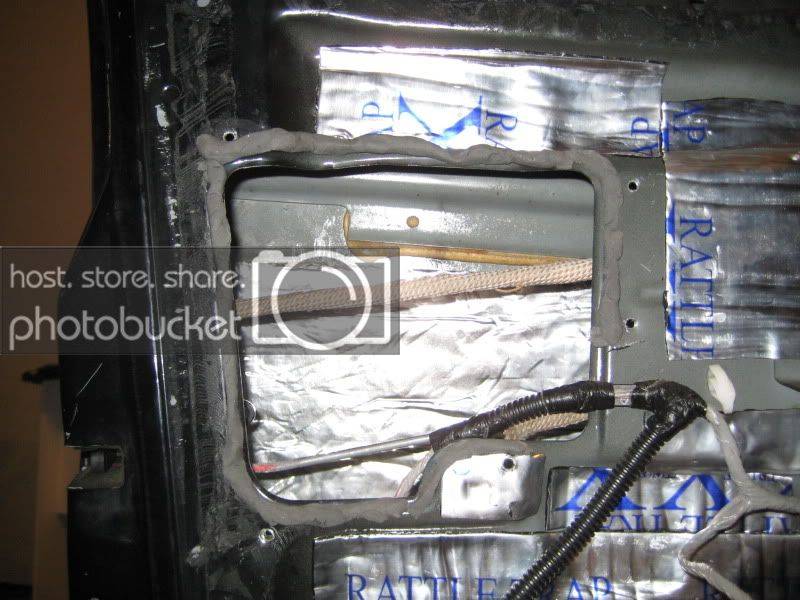

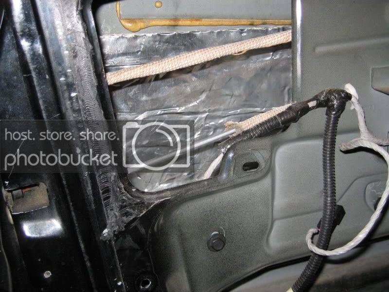

Here is the installed finished flashing panel:
And here is how it started, double layered with silicon caulk:
Used some GB duct seal to seal the corners:
Panel installed:
Final product:

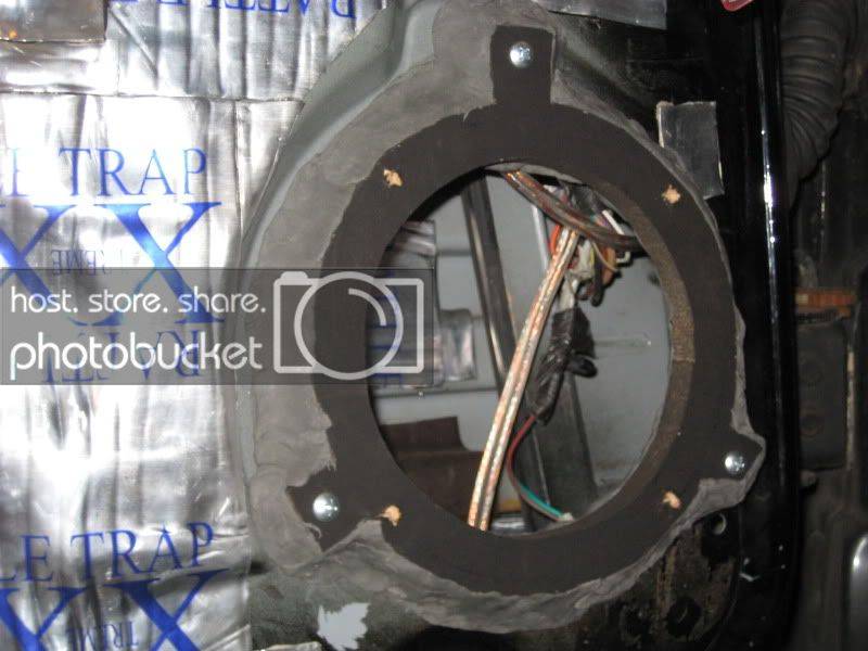

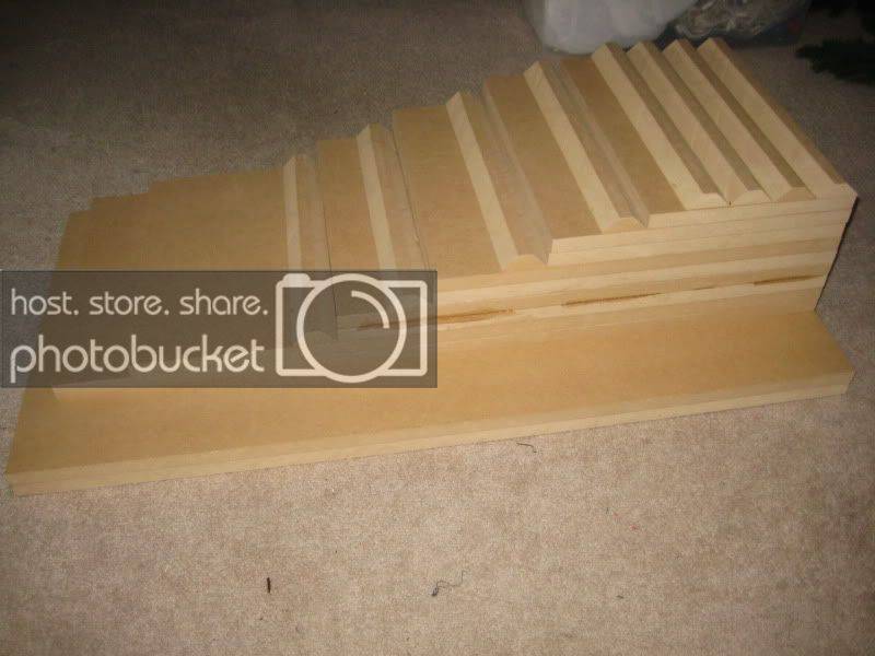

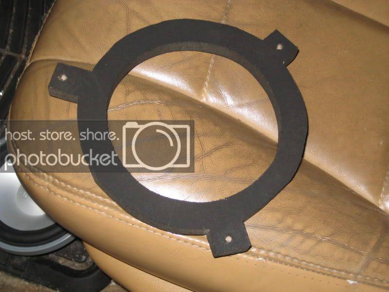

Got a bit more done today, almost finished now. Made some 1/2" mdf baffles, painted them with some black rubberized undercoating:

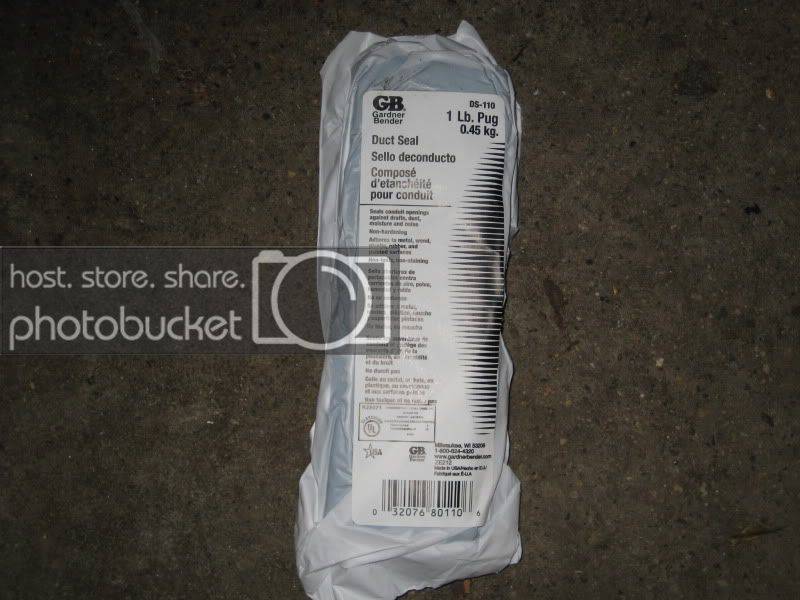

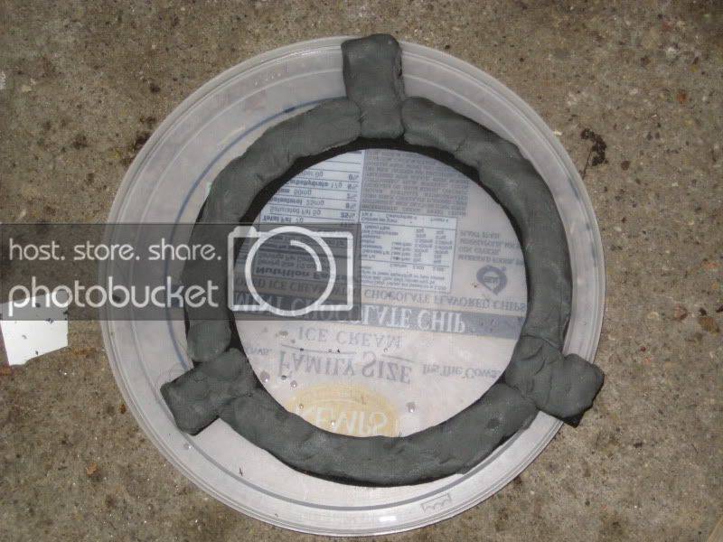

Then used some of this GB duct seal:
On the back of the baffles:
And arounf the outside of the installed baffle:

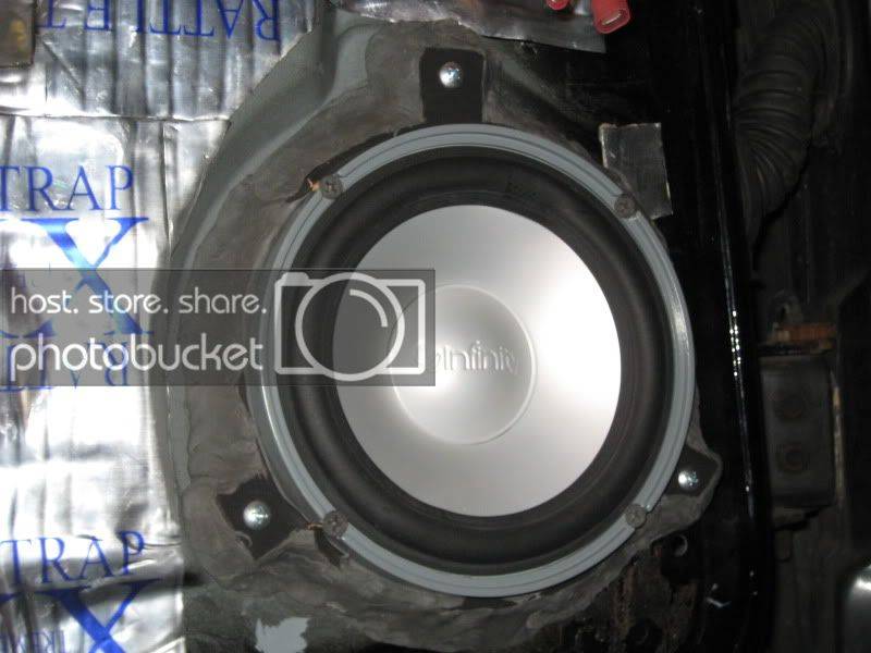

And with the speaker (Infinity Kappa Perfect 6.1) installed:
