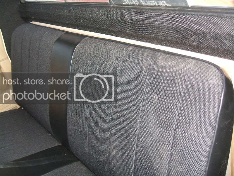

interior pics of the dakota

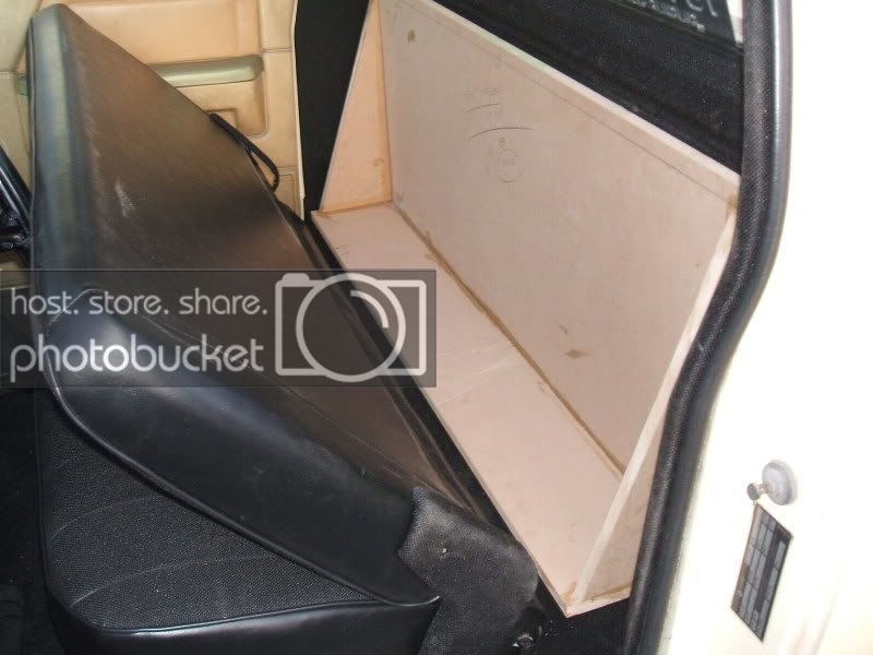

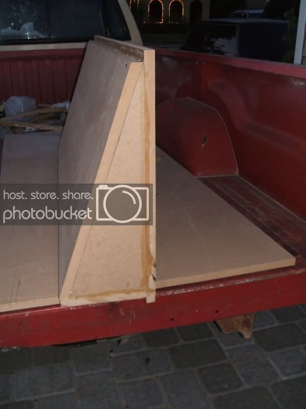

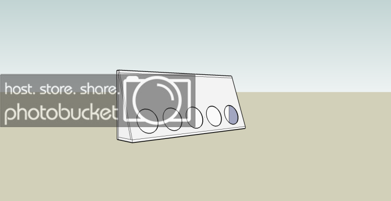

not done.. its about 2.5 cubes sealed gross. going to run either 4 or 5 8s. maybe 3 10s (shallow mounts)

If ypur talking about vids of the e8s i have no camera so i have no vids but it mixes in very well. Theres not much flexing i dont know that you would be able to get much flex out of 4 8's sealed up. But 2.5 probably to big for four E8's sealed probably half that for sealed. 2.5 would work for ported but then you would need an externall port.
why would u want flex. Flex is bad, not a good thing?
