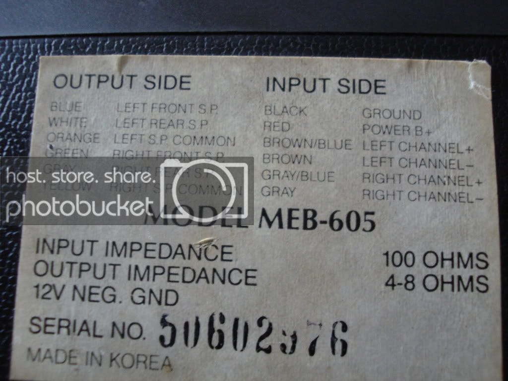

I've got a EQ I took out of an old Dodge Ram before we sent it to the scrap yard. I guess its a stock EQ, not really sure but its all pretty self explanatory as far as wiring goes except for on the input wires (power, ground, +/- L and R speakers) there are 2 extra wires which are for "left speaker common" and "right speaker common" and on the output side there is just +/- L and R.
So basically what are those common wires for? I'll take a pic of the EQ in the morning to see if that helps anyone figure it out.

First, I'd try excluding the amp and all the speakers but one first until you get some audio out of that one speaker.
Second, in your first post you say "... except for on the input wires (power, ground, +/- L and R speakers) ..." but then you say "there are 2 extra wires which are for "left speaker common" and "right speaker common" and on the output side there is just +/- L and R." ... That's backwards from what your picture shows.
Might you need to just take another look?
Finally, another possibility: Maybe the EQ needs low level RCA inputs, and you're feeding it high-level speaker signals? I think you'd still get some audio, though.

Oh crap think i switched up the input and outputs. The input should be connected to amp and output to speakers duh. That was stupid. But if I got it I right now I connect everything on the input side to the amp, power, and ground and everything on the output side to the speakers.
But how do I wire to the speakers? The EQ has 6 wires that need to go to 4. If the common is the ground where do the other 2 wires go? Thanks
The eq has outputs for 4 speakers...which would have been 8 wires, but the left side shares a common wire, and the right side shares a common wire...
Gotcha that makes sense. Thanks for all the help. I'm gonna go outside and see if I can get this working. Does that input impedance of 100 ohms and output impedance of 4 to 8 ohms matter at all in the way I hook it up?
I'm running a 2 channel amp @ 4ohms each channel.
