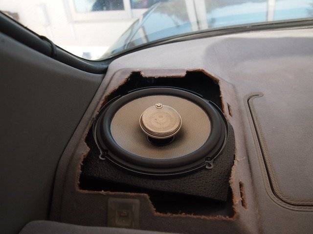

did you replace the seal that goes around the front of the speaker, and stops sound from re-entering the door cavity? Like this..
You need a seal in between the outer edge of the speaker and the door panel. the door is full of holes behind that panel, so sound waves that are coming off of the rear of the speaker are getting through the gap and canceling out the sound that comes out the front of the speaker. and vice-versa. sound that is coming off of the front is re-entering the door cavity. also, do you have a door speaker out of phase? (wired - to +, + to -) and one more thing, how are you getting power to the door speakers? how much of the stock wiring is involved? did you run speaker wire from the amp to the speakers directly, or hook it up to where the stock amp/headunit's was?
a little bit of the stock wiring was used so that i wouldn't have to go through the grommets on the door myself.. then ran those to my amp, and yea they are wired correctly.. if u know where would i get a baffles like the pic you showed me, and ill go head and run the wire straight from the amp to the speaker without any stock wiring used, see if that sounds better.
It sounded better for me, but my stock wiring was garbage. and thats my ride in the pic //content.invisioncic.com/y282845/emoticons/cool.gif.3bcaf8f141236c00f8044d07150e34f7.gif ...anyways, it's just the thickest, narrowest foam cell tape i could find at lowe's in the weatherstripping dept. you can get it at any hardware/home-improvement store. It cost about 4 dollars. The difference in sound was night and day, though.
edit: as you can see, i had to use two layers, even though i used the thickest tape i could find. you may or may not need to bridge such a large gap.
