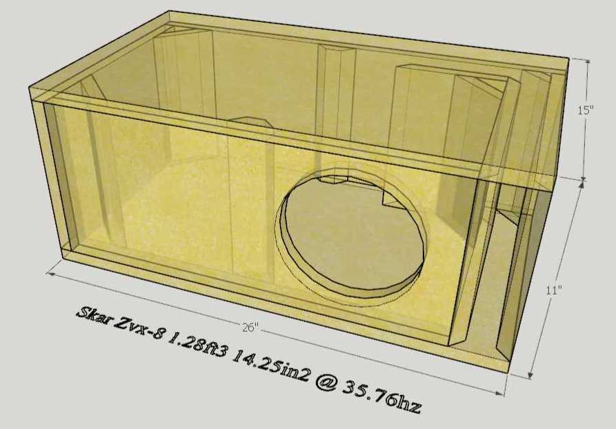

I have plans all done designed to match the Skar recommenndations.
Inbox me if you'd like them.
