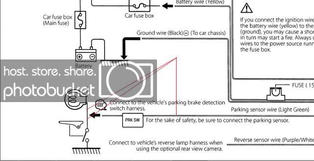

Please; are any of you guys familiar with the Kenwood KVT-512 DVD single din in dash unit?
It would be great to know for sure if this wire is just a ground that I can nail down close to the head?

It shows a "Lt Green" wire and the only thing it says is " connect to the parking brake detection switch harness "
It doesn't say what wire, what color etc?

im tellin you...Mount the green wire with the ground first. My kenwood isnt that old and it worked. I searched forums for this answer. Hopefully that didnt change anything besides removing the brain as a separate unit
No doubt, I will do what you suggest, and thanks for letting me know. //content.invisioncic.com/y282845/emoticons/smile.gif.1ebc41e1811405b213edfc4622c41e27.gif
I'm trying to remember back to my school shop days, by the looks of this diagram from the kenwood user install manual it doesn't look like a power line\circuit.
Is this similar to what you had?
Thank you!
This should be easier to see, I am not doubting you brother.
Just trying to cover all my bases, we all know what it's like when things go smooth and then you get agravated.
