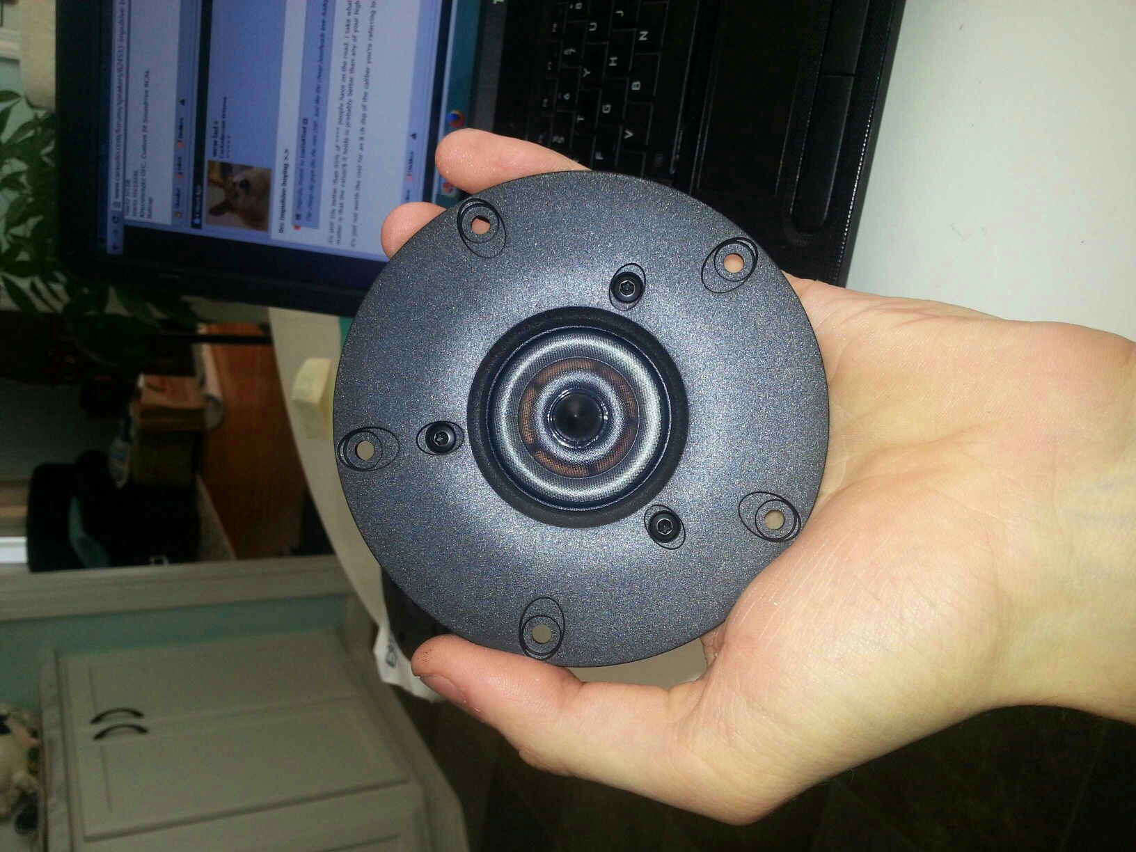

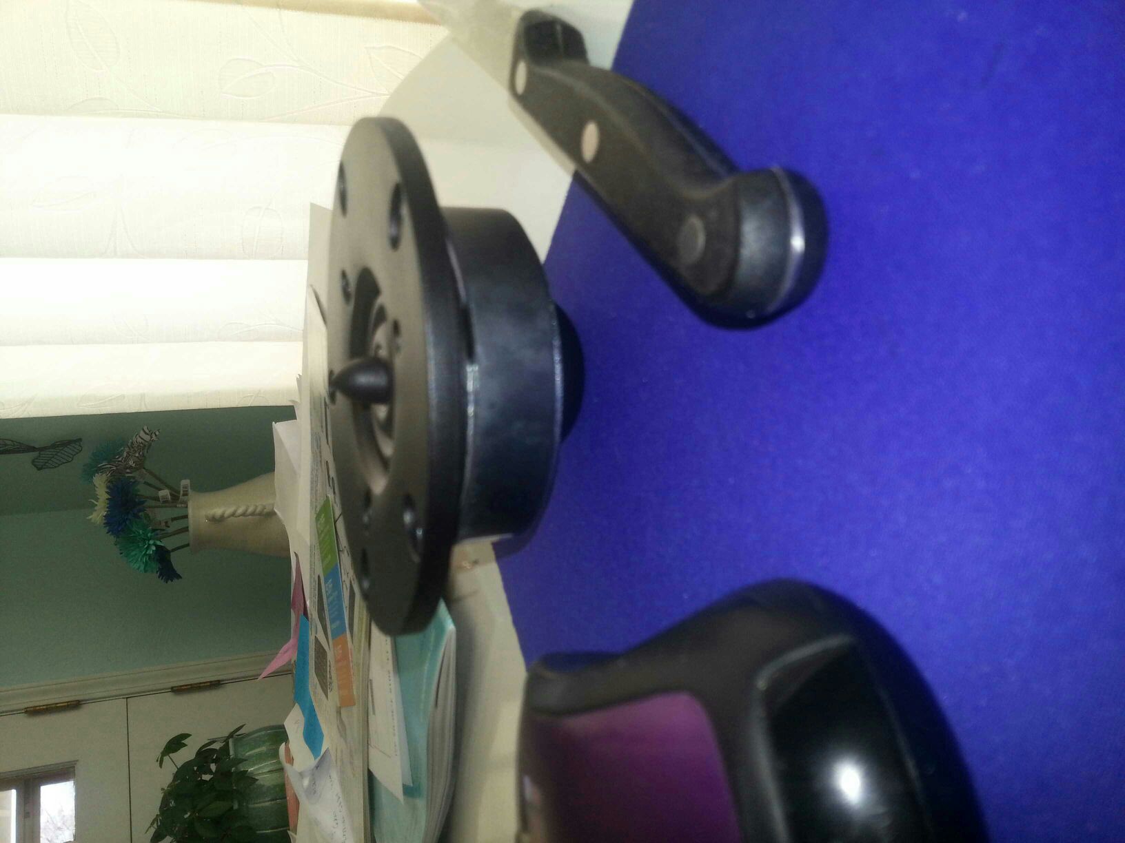

vifa xt25s today, these things are enormous
