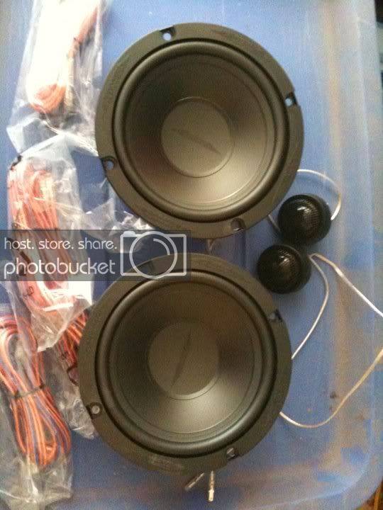

These speakers look pretty unremarkable...except for possibly the giant magnet on the woofers. There is a really heavy duty stamped frame, rubber surround, poly cone with no phase plug, and standard black dome tweeters. I like a stealthy install, so looks don't concern me. They feel incredibly well built, which is what I've come to expect from ID. The drivers have good heft to them and again, the magnets show they are ready to handle a lot of power.

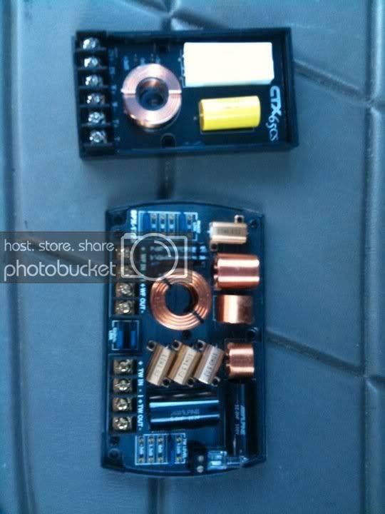

The crossovers are again unremarkable, with an inductor, capacitor, and two resistors. The only adjustment is tweeter level (-3, 0, +3). I was told there is a 2nd order high-pass on the tweeter (probably about 3.5k) and no low-pass on the woofer. The tweeter attenuation either runs the resistors in series, parallel, or out of the loop. But the construction is very clean and solid, components are high quality, and they do the job without being too big.

Speakers:
Crossover on top:

Speakers:
Crossover on top:
