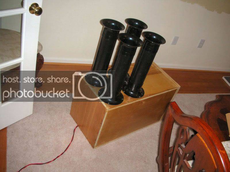

A old style single 15" Fully Loaded Fi BTL
A Externally Aeroported Box Utilizing Four 4" External Aeroports, Box Specs = 3.75 Cubes Net Tuned @ 38hz
