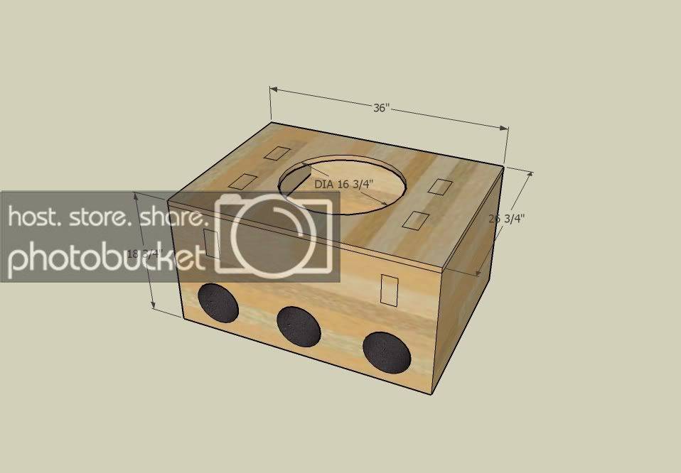

If you know some stuff when it comes to...
...dunno how the tuning works...what changes it etc.

does anyone have that and can do it for me real quick?
Just do it yourself. WinISD is a free program. If you want to PM me the specs, I suppose I could do it for you,
I need the following:
T/S parameters
Box dimensions (L,W,H, and port L,W,H)
I am assuming that you used 3/4" MDF in that design, but if you used something different, let me know
As far as what changes tuning, it is determined by Enclosure volume, port area, and port length.
Ok, I crunched some numbers quick, and here is what I came up with.
6 cubic feet at 28 Hz
W: 36.75 in
H: 14.75 in
D: 23.5 in
Port should be 2" H x 25" W x 18.25" L
Go sub up, port back to make things simpler. If you want the sub facing back with those dimensions, you will need to put a bend in the port
is 28 hz perfect? think its too low???
not to picky about the box...
just that the height is less than 18" and I cant be wider than about 36"
other than that- sub up. port back...
can any hit me up with a design real quick or give me some advice?
thanks a lot
tuned to 36hz... is this what i should go with?
HOW WOULD THIS BE...?
Slot ported box tuned to 32hz for the FiQ 18"
I could also go with the aero port design which is also tuned to 32hz
...but I head aero ports are a pain in deass
