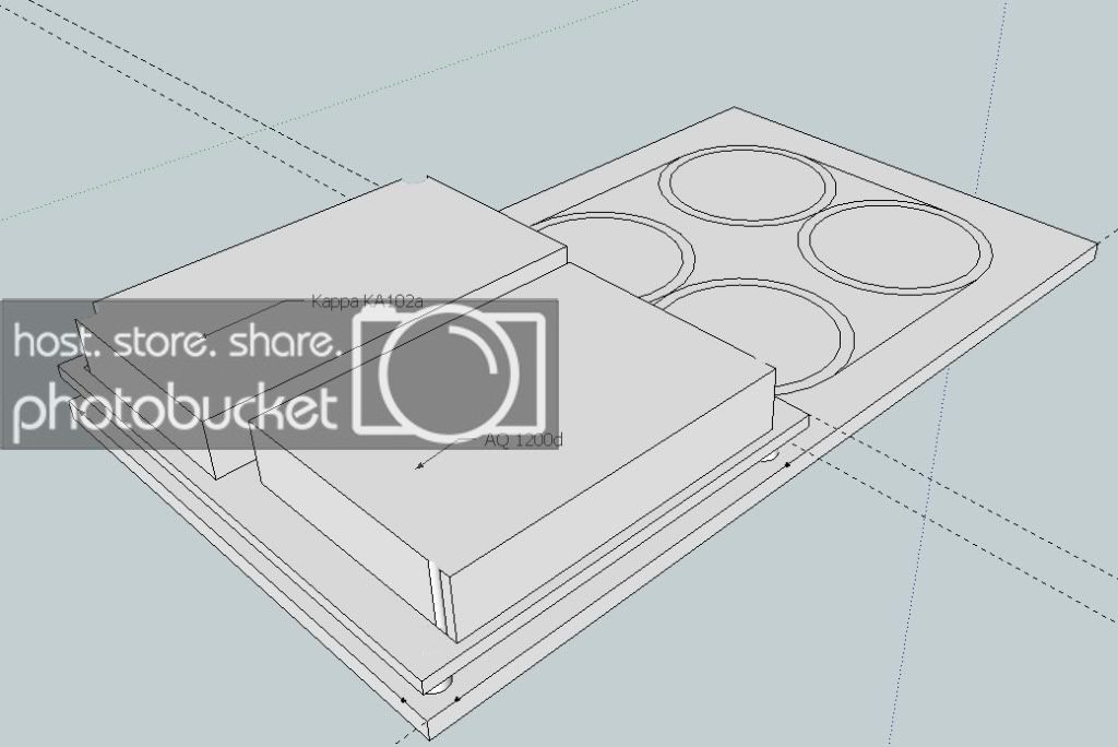

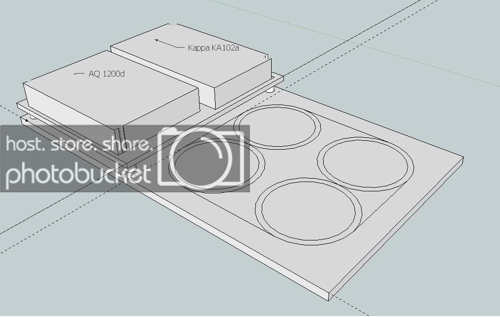

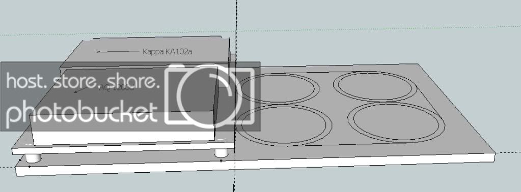

I dig the box you designed thanks.
I made a little sketch of a simple amp rack I might use with that box.
don't ask why there are little holes in the amps //content.invisioncic.com/y282845/emoticons/crap.gif.7f4dd41e3e9b23fbd170a1ee6f65cecc.gif
