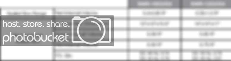

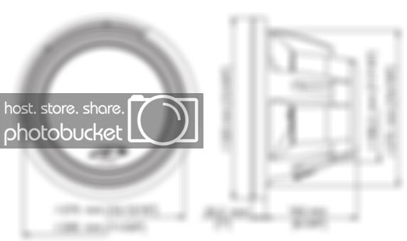

sub sealed.
He are the sub specs - I have the SWR-12D4

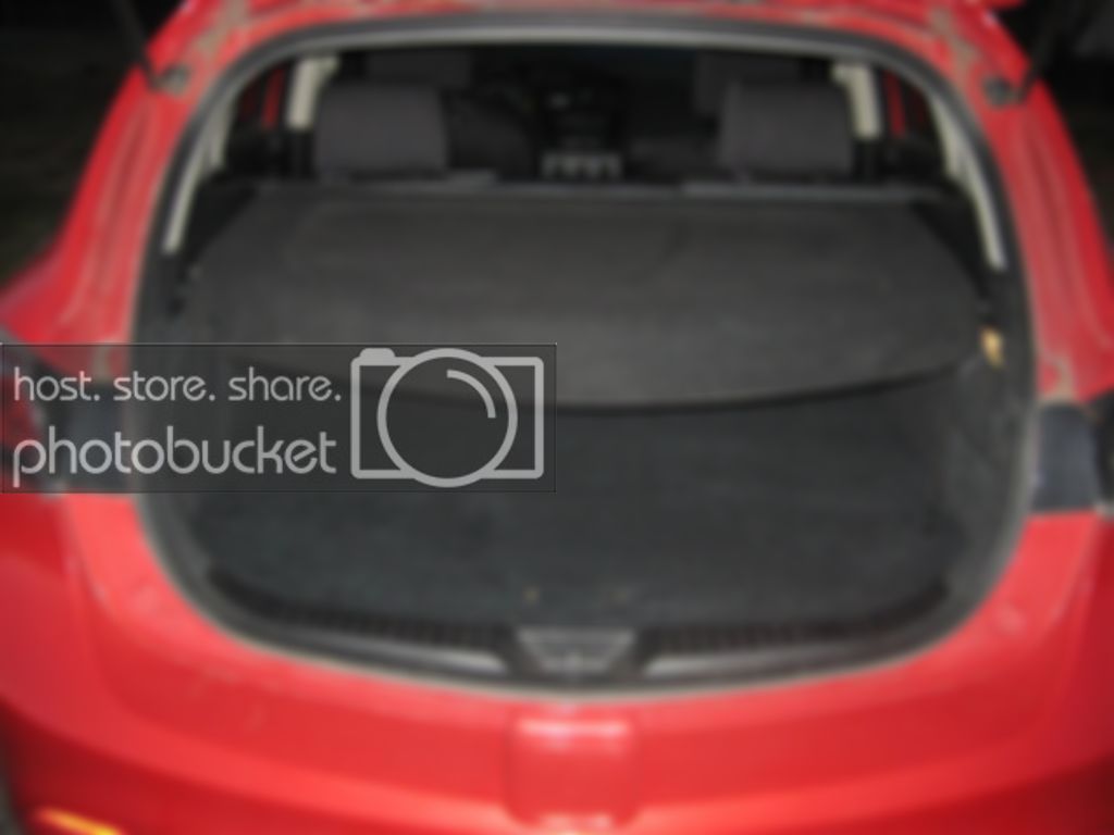

And this is my hatch space I have to work with, remember the canopy will be down. I only have 12" in height to work with. 24" depth and 36" width. I'd rather it be wider than deeper, but I can't be too choosy.

With those dimensions you have over 4 cuft gross. Why sealed?
I meant those are the specs I have to work with, I didn't want to use all that space, LOL.
They do? Lol. Op, go with a wedge 18w12h(1) 4h (2) 16d. .90 gross. But I'd go ported.

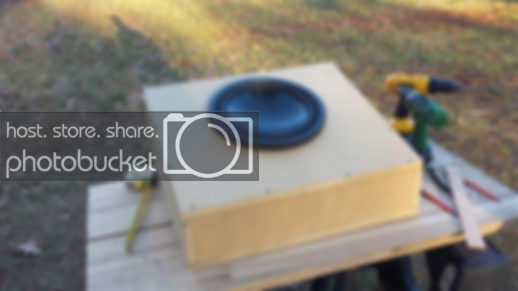

First want to give a big thanks out to CCstang for helping me with the box. Here's the tech specs here he provided me...
24 wide 20 deep 11.5 back height 6 front height
Gives you 1.75 cuft gross and 1.47 net
Slot port won't work, but 2 3" aeros will at 18" length each.
That gives you 9.62 sqin of port and 14.14 per cube.

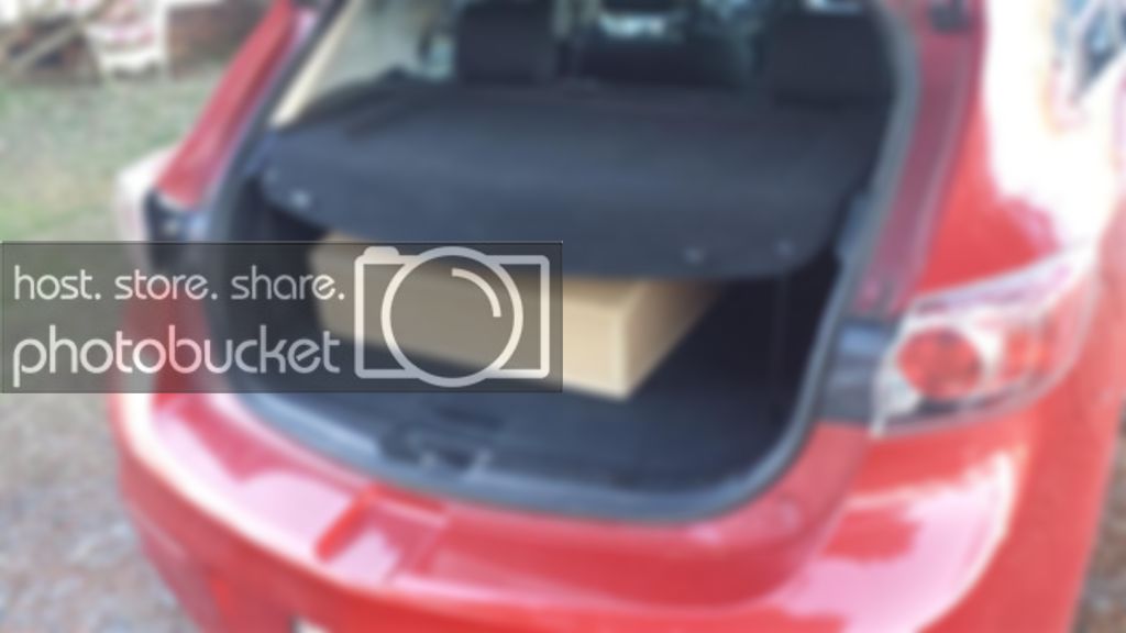

I have no idea what this means, but I've seen his work and I'll take his word for it. Ports are on order, should have next week. You can see by the pictures of the height restriction problems I have, so we worked with what we have. Will get box carpet next week and you will see nothing when the hatch is closed. Ended up giving up my space, but if I needed I can just fold the seats down and push the box forward or take it out altogether.
