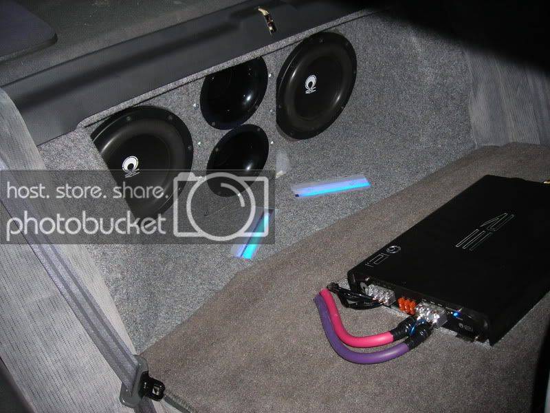

I'm assuming behind the back seats you have a large hole? if so, this is what I mean.
The box is port and subs firing forward, into the cabin, completely sealed off from the trunk itself.
