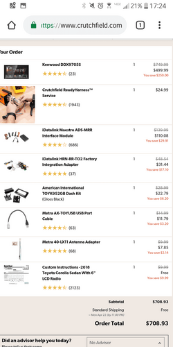

Bought the HU and goodies to go with it. I am going to try my hand at installing it myself. It has been years since I have done any soldering so I chickened out and got the harness service Crutchfield offers. It was 25 bucks and it would cost me more than that to get a decent iron. Heres what I bought. Once it comes in I will start a thread in the install and wiring section if y'all wanna follow along while I fumble around.

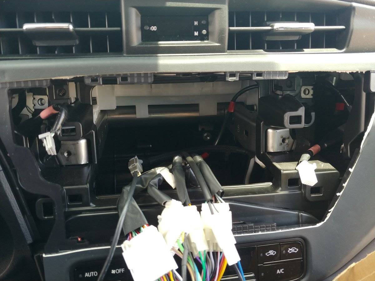

Alright. Got her taken apart and the obvious connects made. I am incorperating the Meastro idatalink here. I have two connections that don't seem to belong anywhere in the new system. Any Idea what the far left and far right connections are?
Don't mind me. I'm dumb. I figured it out. They are for the hazard button and the airbag lights lol! Took me 2 hours to figure that out.
